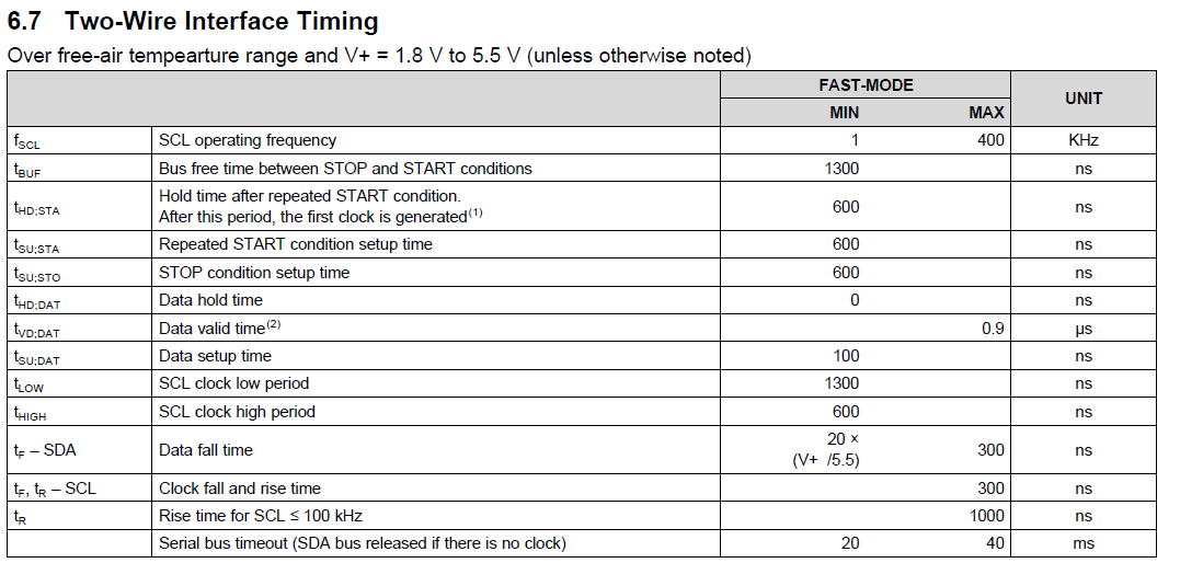

    Thanks for reply. I'm not sure the reason of 150Hz,
    Anyway, so if all parameters described in page 7 of the datasheet (I think it is same as I2C spec) are within the specified value on the customer's board, any resistance value is OK.
    Correct?

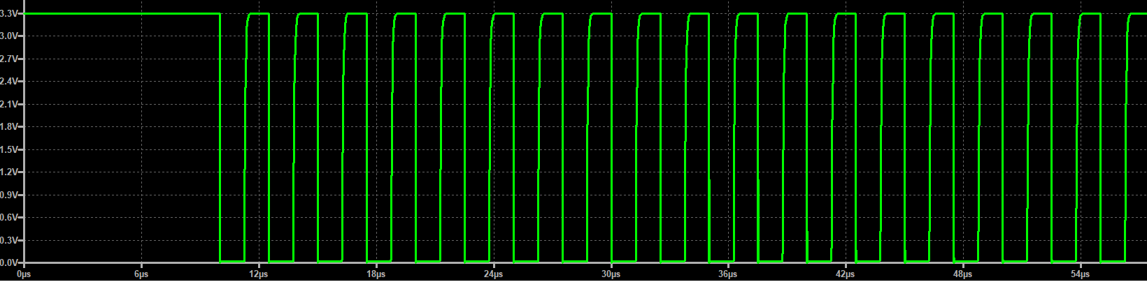

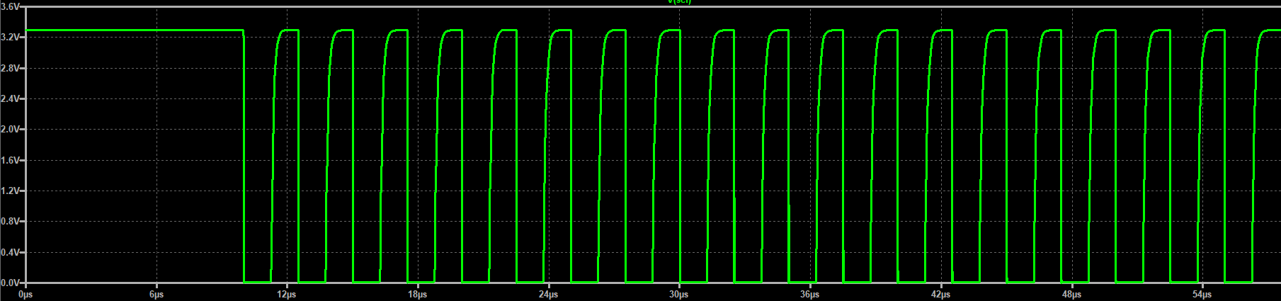

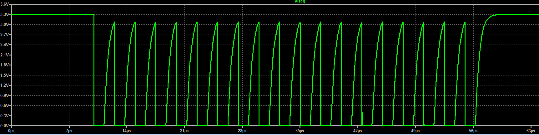

    to illustrate the concept for clarity, I made an I2C simulation  - here is what happens when you raise the pullups and the bus cap is set at 10pF (varying this also has impact, too - but here we are focused on the pullup value so you completely understand what happens)
    1.2k (hard pullup) - nice square edges
    4.7k (nominal)
    10k - probably about the limit - as you can see the leading edge is becoming rounded off
    at 47k, this would be completely unusable
  • Hello Josh,
    Thanks for showing good example.
    What I wanted to say for "any resistance value is OK" is if all parameters in the below table are within the spec.
    For example 47K case in your simulation, it obviously violates t_HIGH time in the table. So it can't be used in this case.
    So my question is if all parameters in the below table are within the spec on their board, is it OK to select any resistance value?
    Oba
  • Hi Oba,
    There's one other spec that constrains pull-up resistors. The Vol spec limits the minimum pull-up resistor by constraining the output to less than 3mA.
    Otherwise, yes, any resistor can be used when the Timing Specifications are met.
