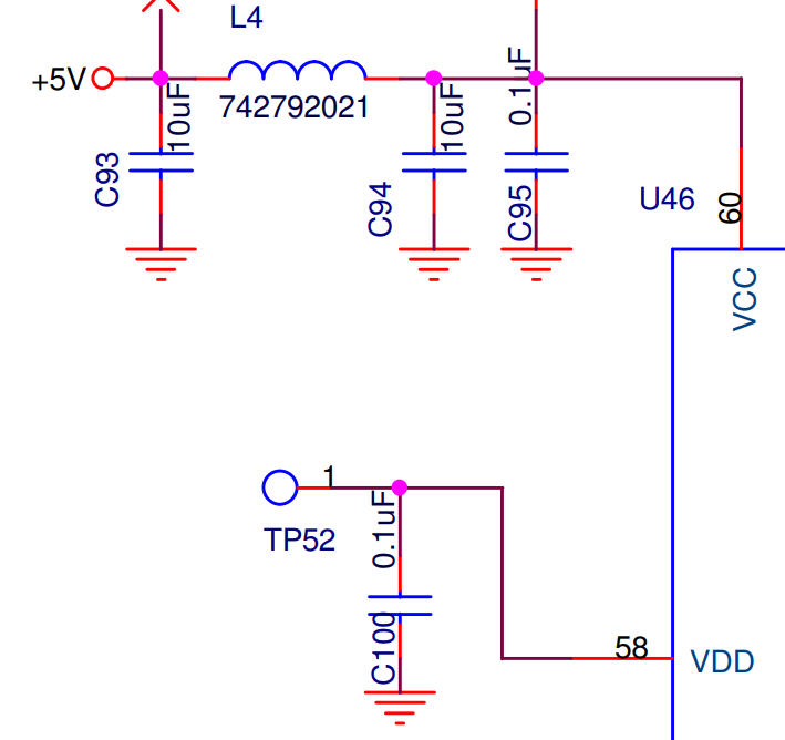

We have designed our custom board using PGA411-Q1 IC, but we are not able to read the registers through SPI. The booster circuit is not working, and is only providing 5V where 12V is expected.

  • Hi Abhinav,
    I see thanks for confirming. What are you using for VCC and VDD power supplies? Do they ramp to 5V within 4ms?
  • Hello Julio,
    For VCC, we have used 5V directly from the power supply through a filter. I'm attaching the picture of our schematic for your reference.
    The voltage at the VCC pin is 5.15V.
    From PGA411-Q1's datasheet, I see VDD is an output pin of the IC and the voltage is observed as 1.769V.
    Abhinav
  • Hi Abhinav,
    What about you VIO supply? What is your power bring up timing for VCC and VIO? VIO should never be supplied before VCC is stable
