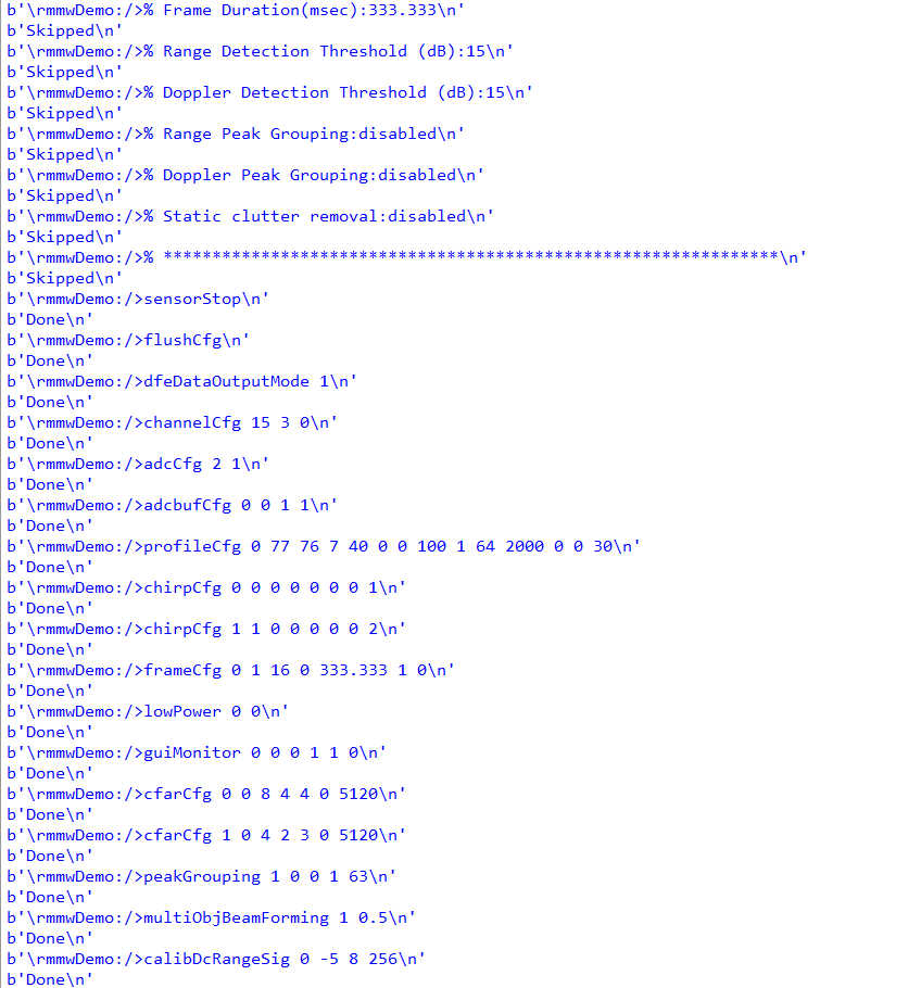

I've flashed the .bin of the mmWave demo Visualizer using IWR1642BOOST. I tried to send the .cfg to the radar through python code but it didn't work.
#serial_transmit import serial import time ser = serial.Serial() #open the port def port_open(index, rate): ser.port = index ser.baudrate = rate ser.bytesize = 8 ser.stopbits = 1 ser.party = 'N' ser.open() if(ser.isOpen()): print("open_successfully!") else: print("open_fail!") #close the port def port_close(): ser.close() if(ser.isOpen()): print("close_fail!") else: print("close_successfully!") #send the cfg def send_cfg(dest): length = len(open(dest).readlines()) f = open(dest) for i in range(length): a = f.readline() if(ser.isOpen()): ser.write(a.encode('utf-8')) time.sleep(1) print("write_successfully!") #main if __name__ == "__main__": dest = "F:/DirEng/profile(1).cfg" port_open('COM6', 115200) send_cfg(dest) port_close() port_open('COM5', 921600)
