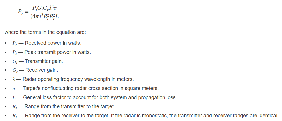

Now, I have a 2d array with dimension (n_range_bins x n_angle_bins) and I want to get the RCS for each of those.
In order to do that, I can use the following equation:
My questions/uncertainties are the following:
P_r: This is computed via beamforming. I am wondering though what units my computed answer is in? As mentioned earlier, I get complex int16 samples from the ADC and then perform the operations on the frame. Does this mean my measurements are in watts but scaled?
P_t: I believe this is 12 dBm or ~.0158 watts
G_r: This I believe this is set by the radar config and I have it set to 30 dB
G_t: I could not find this number.
Are the gains angle-dependent?
lambda: Should I pick the center frequency?
L: Can I ignore this term?
Thanks!
  • HI, Spencer:
    You can refer to the following e2e thread regarding RCS calculation
    In general, it is not easy to calculate the accurate RCS even through SNR calculation.  The antenna gain are different on different direction.  And yes, you can use the center frequency for lambda calculation.
    Zigang
