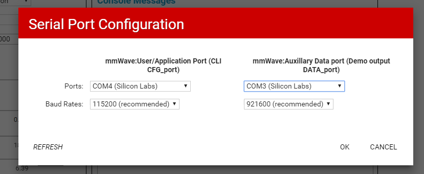

    The next picture, was showing I had chosen the correct COM ports from the demo visualizer -

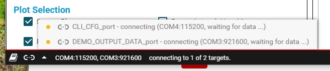

    And the following picture was showing that the demo was active and waiting for data, as per the text indication in the lower left corner of the demo application -

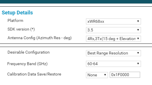

    And finally, the last picture was showing the demo config settings -
    From the defaults, the only options I touched, were the 'Platform' dropdown menu, and selected the 'xWR68xx' option, as well as changing the 'Antenna Config' to the '4Rx,3Tx' option. After which I try to hit the 'Send Config To mmWave Device' button. Upon doing so, nothing happens. There are no messages in the console log window, error or otherwise, so I can't be sure anything is happening at all when I press the button. I also tried what you said, by selecting the 68xx_AOP in the dropdown menu, but that didn't see to do anything either. Out of curiosity, I ended up trying all of the menu options just to see if it I could even get it to generate an error message, or something, but it never printed anything to the log window.

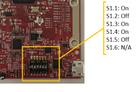

    I have my SOP configured as per the directions from the "Hardware Setup of IWR6843ISK/ODS for Flashing Mode" guide -
    The dip switch on my board looks exactly as in the picture, so I think I've got that set right. I also took the opportunity to restart my pc again, and give it another shot, but still to no avail.

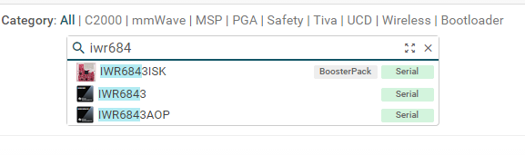

    Also, I noticed in uniflash, there are several options for the device and up to this point, I've been using the IWR6843ISK booster pack option. I tried the IWR6843 non-boosterpack option and that flashed ok, but I the demo viewer still doesn't seem to work. I also tried the AOP version listed, but even though it flashed alright, no such luck with the demo viewer.

    I made sure my SOP settings look correct, with the ON-OFF-ON-ON-OFF pattern, and opened a serial connection to COM4 @ 115200 baud. There doesn't appear to be any serial activity with any keypresses. Neither is there any activity if I press the reset button on the board.

    That seems to have fixed it. It appears the issue was I had the SOP in flashing mode while trying to use the device, instead of the functional SOP pattern.
