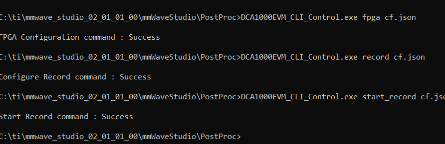

I am trying to set up DCA1000+iwr6843aop + mmwaveicboost  through cli , but I have this error

  • Hello AG,
    The video you refereed me to treats mmwave  studio setting  . But I rather want to configure  through command line interface. It stop after sometime and no adc value is recorded. I will appreciate if someone can share a workable config file and json file for DCA1000 and the the bin file to be loaded to iwr6843. Thank you.
    Best regard
    Ukeme
  • HI, Ukeme:
    Here is the an example of the json file I have been using.   Please remember to send the stop_record command to DCA1000 because the captureStopMode is set to "infinity" in my json file.  Somehow I have a problem attached files, I will copy the example json file and configuration file to the next two replies.
    Zigang

  • Hello AG,
    Thank you for your reply. I have used the configuration you sent. however, I can't see the adc  record. I only see a file  'adc_data_Raw_LogFile.csv'. Please can you share with me the actual l bin file to load to the IWR6843. Thank you.
    Best regard
    Ukeme
  • HI, Ukeme:
    Sorry, I set the file directory to c:\myCliSavedData, you will need to create this directory first ahead of time.
    Zigang
