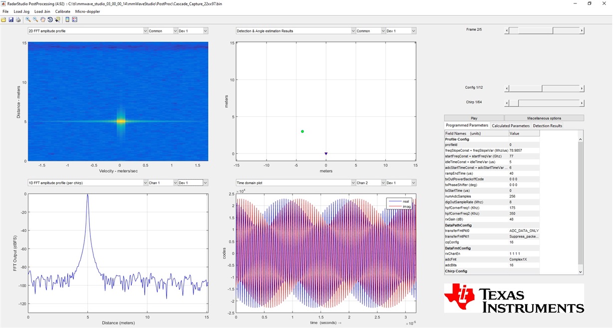

I'm trying to bring up MMWCAS DSP and RF EVM.
Following these threads ( )  it seems I'm able to record required number of frames.
My question is more regarding the results I obtain, which doesn't correspond to the setup and moreover doesn't really change..
Settings are:
I run first Cascade_Configuration_TestSource.lua:

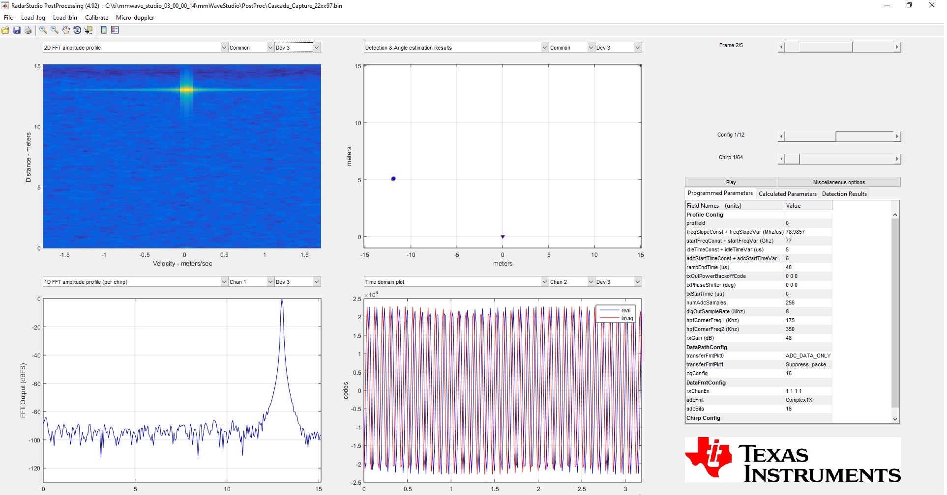

Setup:
a) the setup on the table facing the ceiling (around 2.5m) I have
For Dev1 and Dev 2 results are the same:
For Dev3 and Dev4 results are the same::
b) the setup on the table facing a corner reflector around at 0.5m range
Results are identical for Dev1 and 2 and Dev3 and 4 to a human eye.

  • Hello Maxim,
    From your setup descriptions, I can see you want to capture real object data, like the ceiling or a corner reflector. I see you're running the "Cascade_Configuration_TestSource.lua" script. Now since you've enabled test source capture, you won't be able to observe any of the real objects. Test source is just used to simulate the presence of an object at the specified coordinates.
    Please disable the test source and then try again.
    Let us know your observations.
    Ishita
