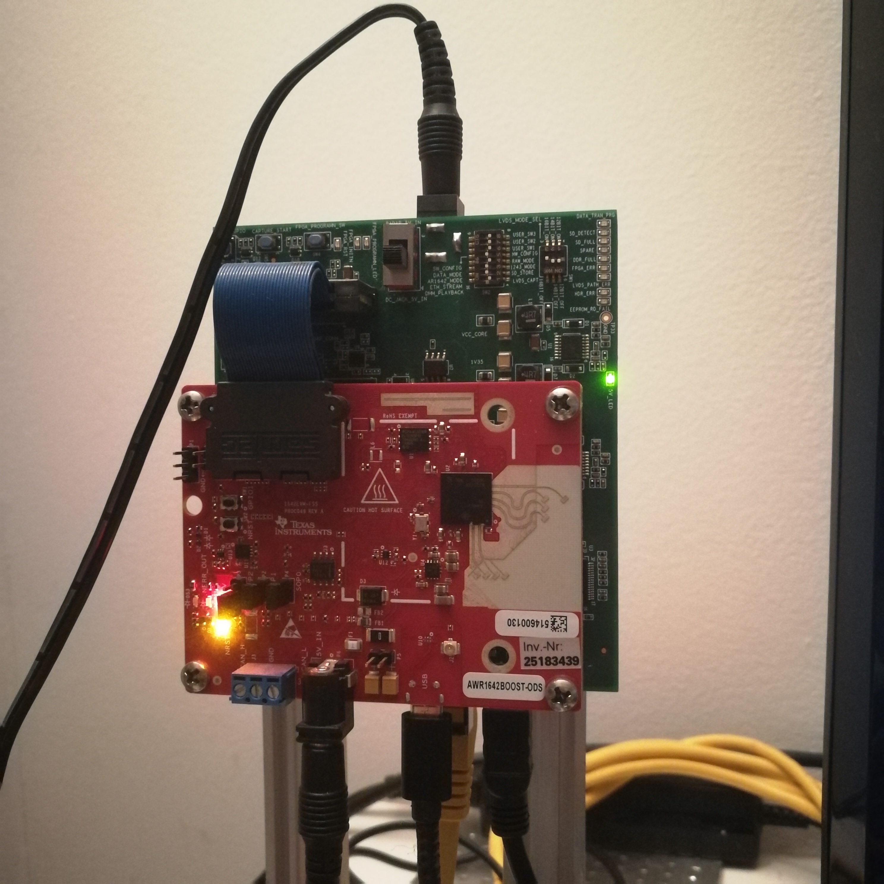

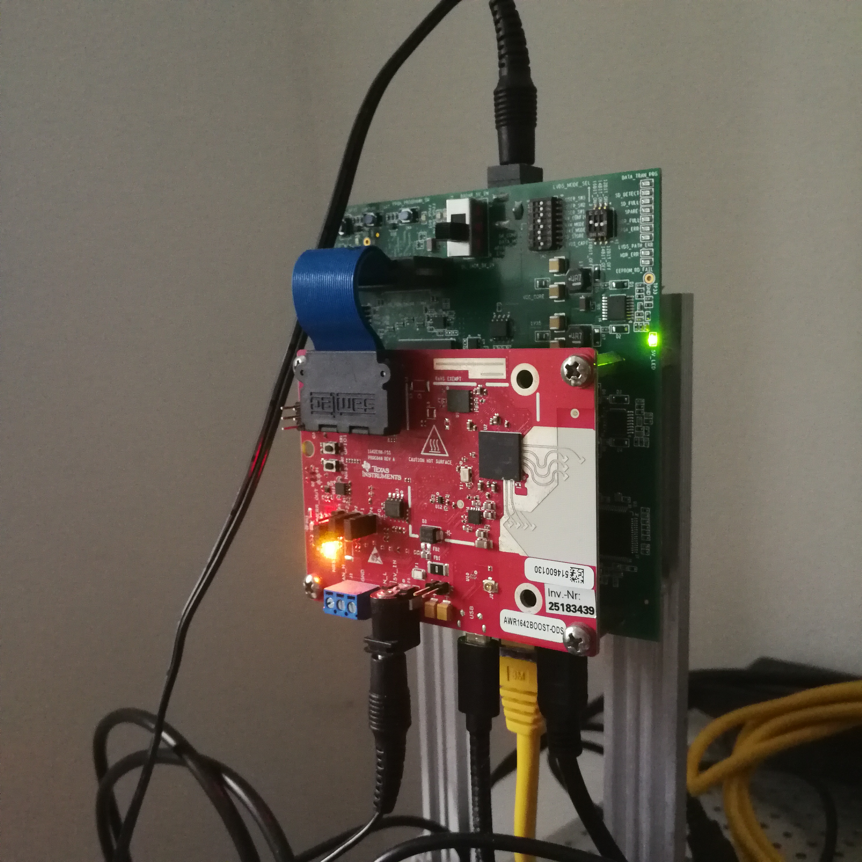

I want to use the AWR1642 and the DCA1000EVM together with mmwave Studio CLI.
So I downloaded the mmwave Studio CLI and followed the instructions in the "mmwave_studio_cli_developer's_guide.pdf" and flashed the AWR1642 with the correct prebuilt binary. This seemed to work. I altered the mmwaveconfig.txt to fit with the AWR1642.

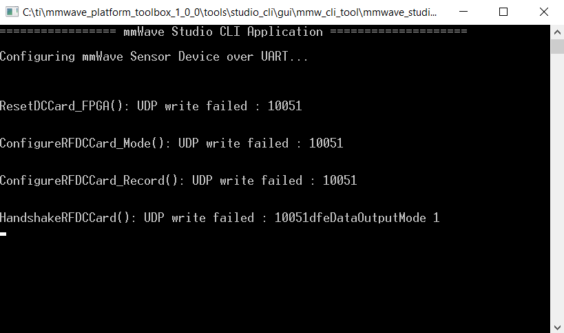

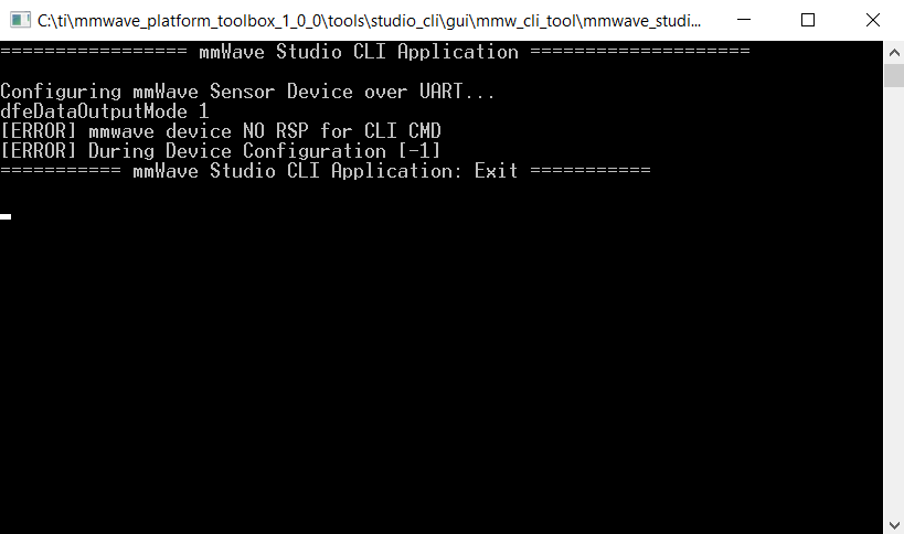

I placed the jumpers on the board for functional mode. Then I started the Studio CLI tool and it sends the first configuration command which will get no response from the device so it times out and prints the messages in the picture.

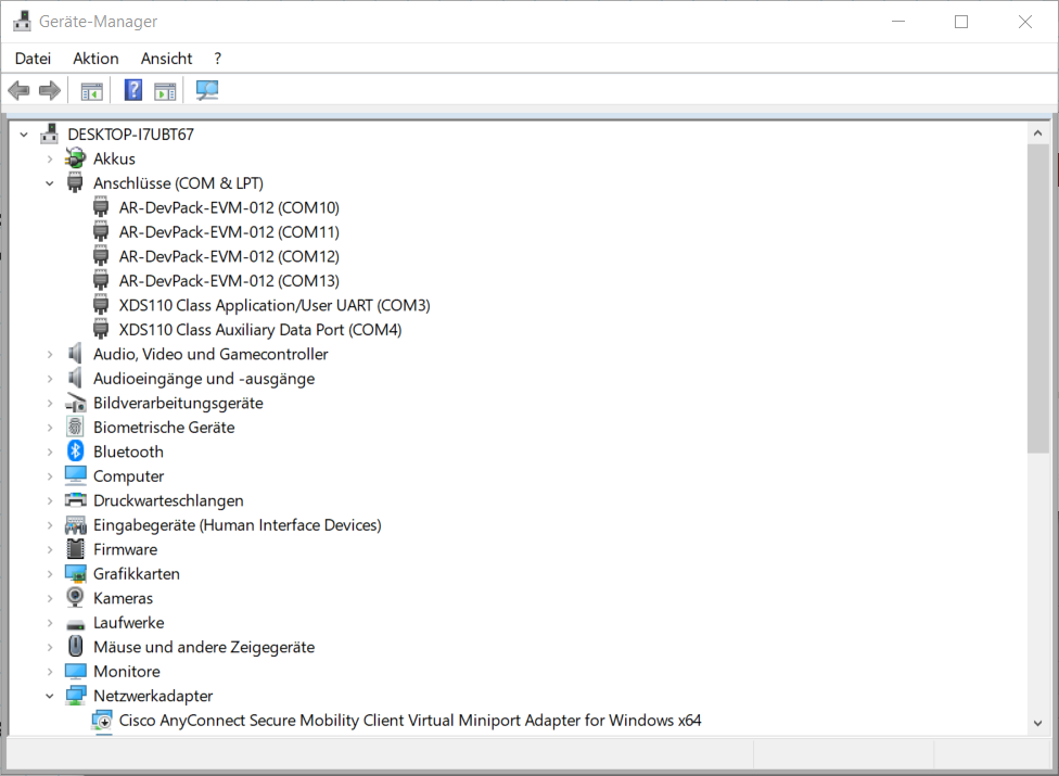

I did enter the correct port in the config which is COM3 in my case.
Do you have any what the problem is? The device has worked the same day using mmwave Studio GUI.
