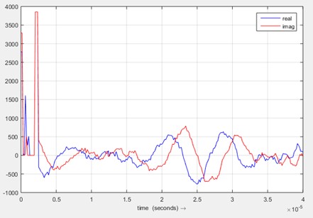

I am having some trouble developing a 3T/4R TDM MIMO configuration for a radar sensor based on AWR1843 chipset.
When I stream ADC raw data from the board, I get the data in which there seems to be some sort of glitches at some initial samples.
These glitches exists only in the data for an specific Tx/Rx data (Tx2/Rx1 only. there is no such glitches in data of other Tx/Rx channels).
There seems to be some issue on ADC timing or LVDS streaming.
I would like to get an advice on what this might come from.
The following is the chirp config i am using.
  • Hello Hyunwoo Seo,
    Is the issue seen in all the chirps with Tx2/Rx1 or is it seen only occasionally? Can you also share the time domain plots with other Rx channels?
    Could you try the following experiment:
    1)  Increase the HPF cutoff frequency to 700Khz/700Khz
    2) Reduce the TX start time to 0usec.
    3) Set the Tx backoff to 6 dB
    Vivek
