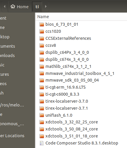

I have an issue re-building the people counting demo (68xx_3D_people_counting). The build itself works fine, but I never get the "3D_people_count_68xx_demo.bin" file, which I need to flash the IWR6843AoP
That's what I have installed:
For rebuilding I used v8 (not v10) of CSS, as described in the User Guide.
I attached the log files for the build process of the dss and mss projects. I always run dss before mss.

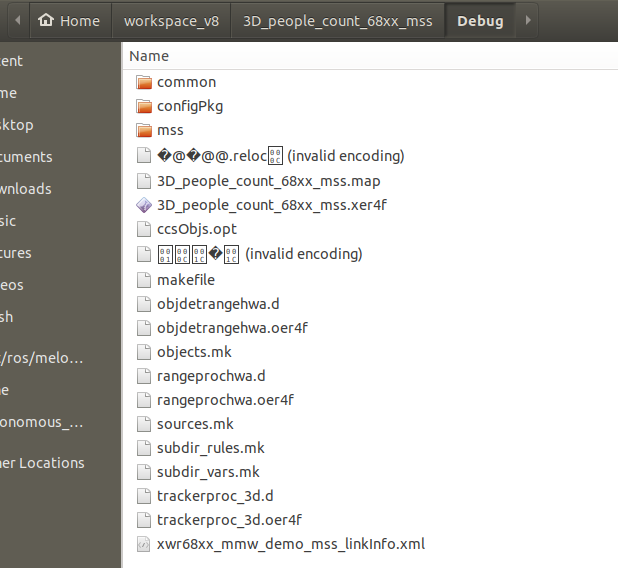

/home/nuc/ti/mmwave_sdk_03_05_00_04/packages/scripts/ImageCreator/out2rprc/out2rprc.exe 3D_people_count_68xx_mss.xer4f 3D_people_count_68xx_mss.tmp
makefile:208: recipe for target 'post-build' failed
/home/nuc/ti/mmwave_sdk_03_05_00_04/packages/scripts/ImageCreator/out2rprc/out2rprc.exe: 1: /home/nuc/ti/mmwave_sdk_03_05_00_04/packages/scripts/ImageCreator/out2rprc/out2rprc.exe: MZ����@���: not found
/home/nuc/ti/mmwave_sdk_03_05_00_04/packages/scripts/ImageCreator/out2rprc/out2rprc.exe: 177: /home/nuc/ti/mmwave_sdk_03_05_00_04/packages/scripts/ImageCreator/out2rprc/out2rprc.exe: r�po9: not found
/home/nuc/ti/mmwave_sdk_03_05_00_04/packages/scripts/ImageCreator/out2rprc/out2rprc.exe: 178: /home/nuc/ti/mmwave_sdk_03_05_00_04/packages/scripts/ImageCreator/out2rprc/out2rprc.exe: �,X�,o6: not found
/home/nuc/ti/mmwave_sdk_03_05_00_04/packages/scripts/ImageCreator/out2rprc/out2rprc.exe: 180: /home/nuc/ti/mmwave_sdk_03_05_00_04/packages/scripts/ImageCreator/out2rprc/out2rprc.exe: {��r�p�:o6
{��r�po9: not found
/home/nuc/ti/mmwave_sdk_03_05_00_04/packages/scripts/ImageCreator/out2rprc/out2rprc.exe: 177: /home/nuc/ti/mmwave_sdk_03_05_00_04/packages/scripts/ImageCreator/out2rprc/out2rprc.exe: r�p{: not found
/home/nuc/ti/mmwave_sdk_03_05_00_04/packages/scripts/ImageCreator/out2rprc/out2rprc.exe: 181: /home/nuc/ti/mmwave_sdk_03_05_00_04/packages/scripts/ImageCreator/out2rprc/out2rprc.exe: Syntax error: word unexpected (expecting ")")
gmake[3]: [post-build] Error 2 (ignored)
/home/nuc/ti/mmwave_sdk_03_05_00_04/packages/scripts/ImageCreator/out2rprc/out2rprc.exe: 1: /home/nuc/ti/mmwave_sdk_03_05_00_04/packages/scripts/ImageCreator/out2rprc/out2rprc.exe: .rsrc�: not found
/home/nuc/ti/mmwave_sdk_03_05_00_04/packages/scripts/ImageCreator/out2rprc/out2rprc.exe: 2: /home/nuc/ti/mmwave_sdk_03_05_00_04/packages/scripts/ImageCreator/out2rprc/out2rprc.exe: ��WW��BN�: not found
/home/nuc/ti/mmwave_sdk_03_05_00_04/packages/scripts/ImageCreator/multicore_image_generator/MulticoreImageGen.exe: 1: /home/nuc/ti/mmwave_sdk_03_05_00_04/packages/scripts/ImageCreator/multicore_image_generator/MulticoreImageGen.exe: MZ����@���: not found
/home/nuc/ti/mmwave_sdk_03_05_00_04/packages/scripts/ImageCreator/multicore_image_generator/MulticoreImageGen.exe: 1: /home/nuc/ti/mmwave_sdk_03_05_00_04/packages/scripts/ImageCreator/multicore_image_generator/MulticoreImageGen.exe: P: not found
/home/nuc/ti/mmwave_sdk_03_05_00_04/packages/scripts/ImageCreator/multicore_image_generator/MulticoreImageGen.exe: 2: /home/nuc/ti/mmwave_sdk_03_05_00_04/packages/scripts/ImageCreator/multicore_image_generator/MulticoreImageGen.exe: ��PX�/�����@: not found
/home/nuc/ti/mmwave_sdk_03_05_00_04/packages/scripts/ImageCreator/multicore_image_generator/MulticoreImageGen.exe: 9: /home/nuc/ti/mmwave_sdk_03_05_00_04/packages/scripts/ImageCreator/multicore_image_generator/MulticoreImageGen.exe: Syntax error: "(" unexpected (expecting ")")
/home/nuc/ti/mmwave_sdk_03_05_00_04/packages/scripts/ImageCreator/crc_multicore_image/crc_multicore_image.exe: 1: /home/nuc/ti/mmwave_sdk_03_05_00_04/packages/scripts/ImageCreator/crc_multicore_image/crc_multicore_image.exe: MZ����@���: not found
/home/nuc/ti/mmwave_sdk_03_05_00_04/packages/scripts/ImageCreator/crc_multicore_image/crc_multicore_image.exe: 2: /home/nuc/ti/mmwave_sdk_03_05_00_04/packages/scripts/ImageCreator/crc_multicore_image/crc_multicore_image.exe: ��PX�:�����@0��: not found/home/nuc/ti/mmwave_sdk_03_05_00_04/packages/scripts/ImageCreator/crc_multicore_image/crc_multicore_image.exe: 1: /home/nuc/ti/mmwave_sdk_03_05_00_04/packages/scripts/ImageCreator/crc_multicore_image/crc_multicore_image.exe: P: not found
/home/nuc/ti/mmwave_sdk_03_05_00_04/packages/scripts/ImageCreator/crc_multicore_image/crc_multicore_image.exe: 2: /home/nuc/ti/mmwave_sdk_03_05_00_04/packages/scripts/ImageCreator/crc_multicore_image/crc_multicore_image.exe: ,.text���.data,��@0�.rdata�: not found
/home/nuc/ti/mmwave_sdk_03_05_00_04/packages/scripts/ImageCreator/crc_multicore_image/crc_multicore_image.exe: 11: /home/nuc/ti/mmwave_sdk_03_05_00_04/packages/scripts/ImageCreator/crc_multicore_image/crc_multicore_image.exe: Syntax error: "(" unexpected
gmake[3]: execvp: /home/nuc/ti/mmwave_sdk_03_05_00_04/packages/scripts/ImageCreator/append_bin_crc/gen_bincrc32.exe: Permission denied
gmake[3]: [post-build] Error 127 (ignored)
/home/nuc/ti/mmwave_sdk_03_05_00_04/packages/scripts/ImageCreator/multicore_image_generator/MulticoreImageGen.exe LE 37 0x00000006 3D_people_count_68xx_demo.bin 0x35510000 3D_people_count_68xx_mss.tmp 0xb5510000 /home/nuc/ti/mmwave_sdk_03_05_00_04/firmware/radarss/xwr6xxx_radarss_rprc.bin 0xd5510000 /home/nuc/workspace_v8/3D_people_count_68xx_dss/Debug/3D_people_count_68xx_dss.bin
/home/nuc/ti/mmwave_sdk_03_05_00_04/packages/scripts/ImageCreator/crc_multicore_image/crc_multicore_image.exe 3D_people_count_68xx_demo.bin 3D_people_count_68xx_demo.tmp
/home/nuc/ti/mmwave_sdk_03_05_00_04/packages/scripts/ImageCreator/append_bin_crc/gen_bincrc32.exe 3D_people_count_68xx_demo.bin
**** Build Finished ****

  • Hey,
    I reinstalled the sdk and the toolbox and updated some packages of the CSSv8.
    It still gives the same errors.
    I found some weird files here:
    same in the dss Debug folder.
