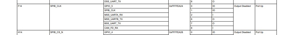

    MSS, BSS, DSS logger signals are not shorted, but they are pin multiplexed. These are debug pins to provide the data out in UART ports.
    mmWave sensor has multiple cores are present that are represented Master subsystem (MSS), BSS (buil)
    Essentially these are UART ports that are available to bring data out from different part of processor cores.

       mmWave sensor has multiple cores that are represented Master subsystem (MSS), BSS (Built in self test subsystem),  DSS (Dsp sub system), each of the subsystem UART ports could be pin muxed on single pin as shown in the above table.
    In the demo context MSS_UART_Tx UART port is used to send out processed data from the MSS processor core.

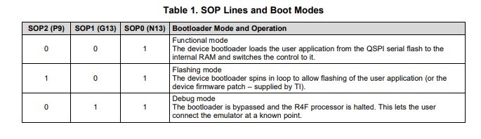

    • For Function Mode, SOP[2, 1] pins are connected to GND, and SOP[0] pin is connected to 3V3.

       In  IWR6843ISK using  TI demo flashed on the devices sends out data on MSS_LOGGER_Tx pin not on MSS_LOGGER_RX. And this MSS_Logger_Tx pin need to be connected to RX port of the UART interface.
    You cannot permanently tie the SOP lines, From the above description, it appears that device is in functional mode and it's trying to read the content from the QSPI flash. If the QSPI flash is empty then boot failure would happen and device will not be operational.
    Could you please confirm were you able to successfully flash the device?

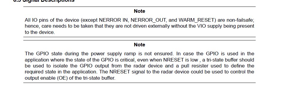

    Few care about that need to be noted, All the I/O supplies other than listed below should not be driven externally without VIO supply.
    If you are connecting the UART pins through external USB to UART interface, there may be possibility of UART pin being driven without VIO supply, when power cycling the board. This must be avoided.
