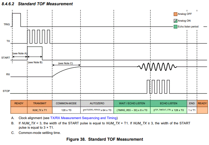

  • Philip,
    The 8 ms value is based on the default test parameters used in the specification table of the datasheet.  Here the divided clock frequency is 1 MHz.  With this frequency, the resulting value for T0 is 1 us.
    Section 8.4.6.2 of the datasheet describes the listen timing for the device:
    Using 1 us for T0, 1023 (x3FF) for TIMING_REG, and the TOF_TIMEOUT_CTRL set to the maximum value of 1024*T0, we can calculate the total ECHO Listen Time.
    (1023-30) * 8 * 1 us + 2^(1024* 1us) * 128 * 1 us = 8.072 ms.
    With lower input frequencies, it should be possible to extend this listen period, but it is not recommended to hold the RX in listen mode for longer than 100 ms.
    It may be desirable to disable the timeout function to maximize range.  I would also caution that as the range increases that the returning echo will dampen more. It will be most ideal to power the device to the maximum supply voltage to increase the outgoing pulse magnitude.
    The TDC receiver does not offer as much gain as some of our other devices such as PGA460 or TUSS4470 which may be better suited for this application depending on the transducer frequency.  We typically recommend TDC-1000 for smaller tanks or enclosures. One transducer option that can work with both PGA460 or TUSS4470 for underwater applications is the Prowave 200LM450.
    I am not familiar with the Maxim portfolio and am not able to comment on their devices.

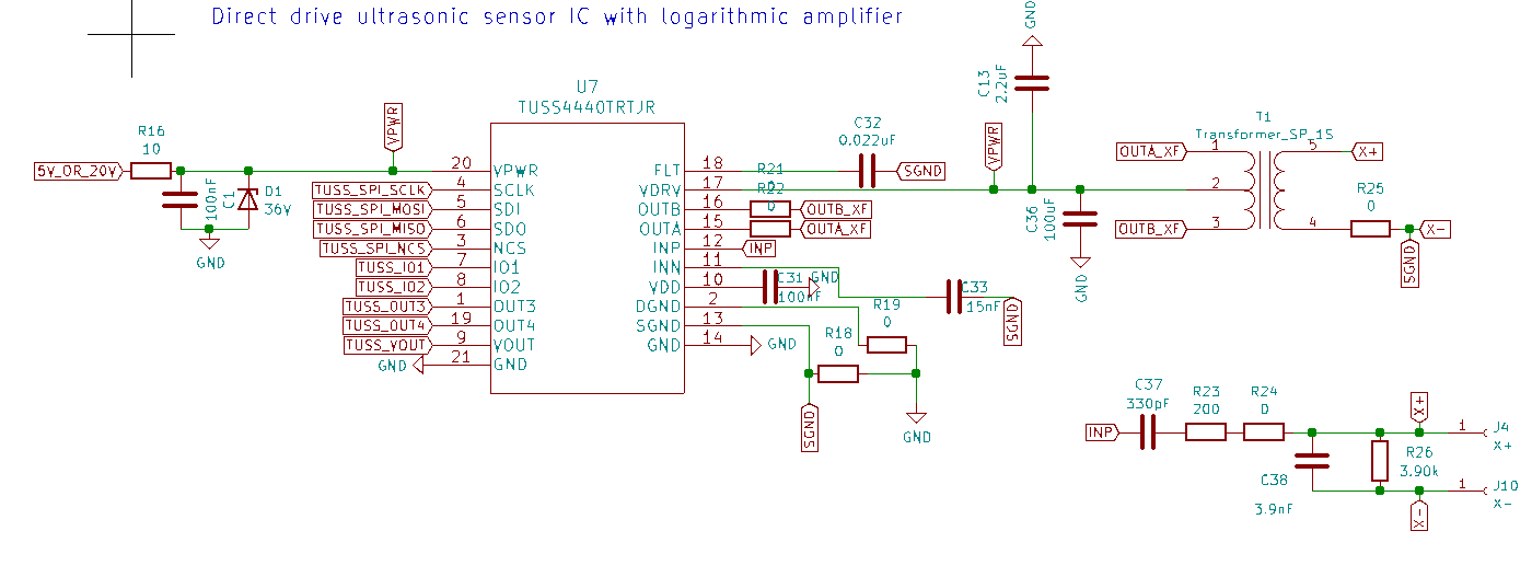

  • Thank you so much for your answer! I decided to go with the TUSS4470 as I believe it will fit best my application. I also chose 2 transducers, 200kHz and 500kHz, once I start testing I will report the outcome, hopefully helping other people. I Would love to make sure that the schematic below is correct. I will be supplying 20V to the VPWR pin to achieve better depth.
  • Philip,
    You currently have TUSS4440 installed instead of TUSS4470.
    You do not appear to be driving the VDD pin in this schematic.  Please be sure to connect it to a supply voltage to match your digital inputs.
    Otherwise this looks to be a very close copy of what is in the BOOSTXL-TUSS4470 board.  One thing I notice is that on FLT you have selected a capacitance equal to the sum of all capacitor options on the EVM. In your end application you will likely want just one capacitor here for size restrictions, but you may want to be prepared to change these devices depending on your transducers.
