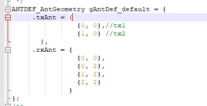

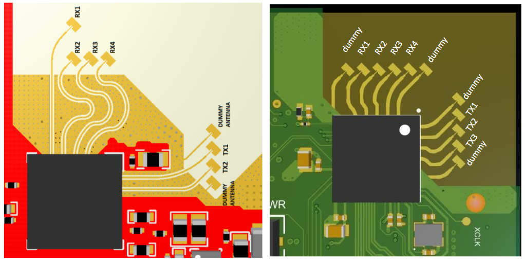

1. What array of antennas should we use in geometry.c of the SDK? We have proposed the following geometry based on the ODS antenna arrangement, we also attach the 1843 default arrangement.

Here is the information I have received from the design team
thank you
Cesar

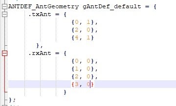

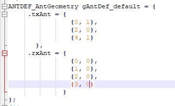

Hi, I have made changes in the geometry.c file in the OOB demo but it seems there are no changes in the detection, even I rename the structure ANTDEF_AntGeometry to ANTDEF_AntGeometrya expecting an error but the CSS build the project without problems, and why the geometry file appears with that mark on it like it is unavailable, am I editing this file in the correct way? thanks
