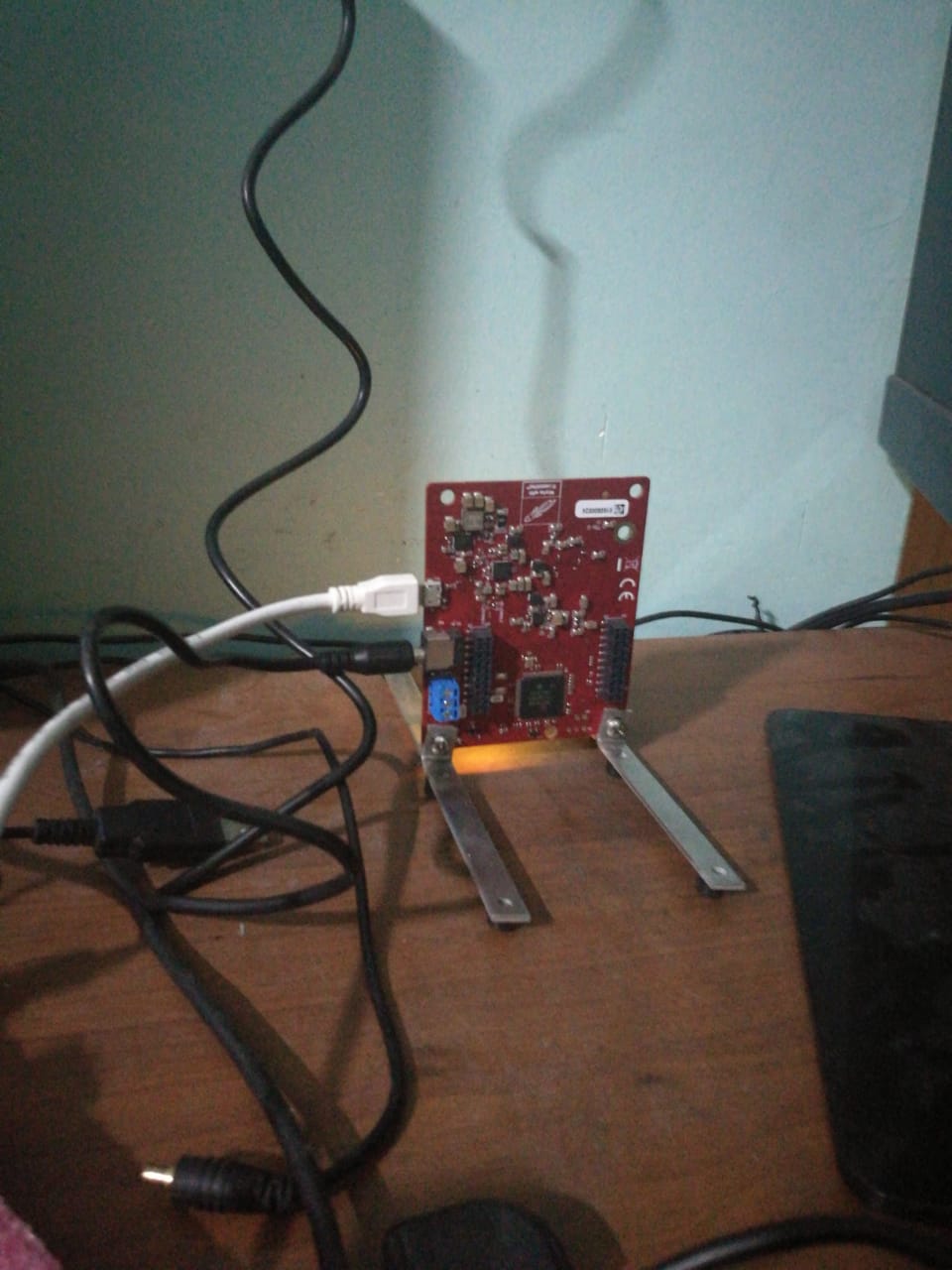

Doing basic testing of EVM, keeping module close to the wall & its throwing 91 objects detected. Module is very close to wall. Same output getting in demo visualizer tool also. PFA image.
Is it a right way of testing module?
Can you please confirm minimum size of object required for detection? Here is the header info which I received:

    By placing the sensor close to a wall you will get multi-path reflections.
    No, this is not the right way of testing the module.
    Usually, first we test the sensor with a corner reflector in some open wide space so that there are no additional reflections.
