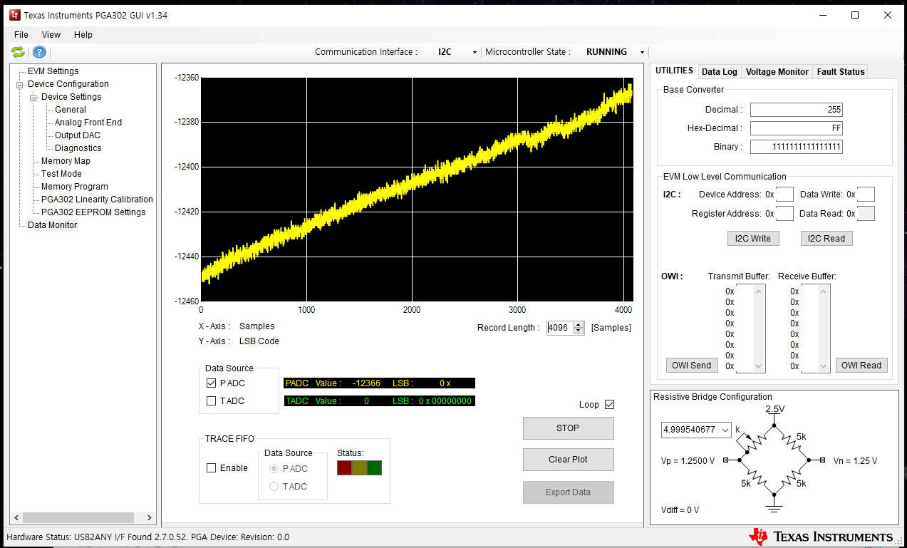

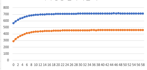

I am making a product in which mcu works by reading Alnico magnets with a Hall sensor.
I added additional graphs.
The x-axis is time and the y-axis is the AD value read from mcu.
There is a problem that the value keeps rising for about 0~10 minutes on the graph.
Can the PGA302 solve this problem?
I need a product that can keep the value read from the Hall sensor.
Please introduce a product that you are satisfied with.
thanks.
  • Hello Seok,
    Just to clarify, this is the raw data directly from the PADC_DATAx registers? What is the second set of data included in the graph? Are these just two measurements done at different times superimposed on one another?
    What is the magnitude of the signal to the VINPP and VINPN inputs, and is the data from the hall sensor in this example? To determine if this is due to the PGA302 itself, I recommend applying a fixed voltage that matches the output of your hall sensor, and perform the measurement again over the same time period. If there is still a drift, this may be due to some self-heating affecting the measurement. I would also monitor the internal temperature sensor output at the same time.

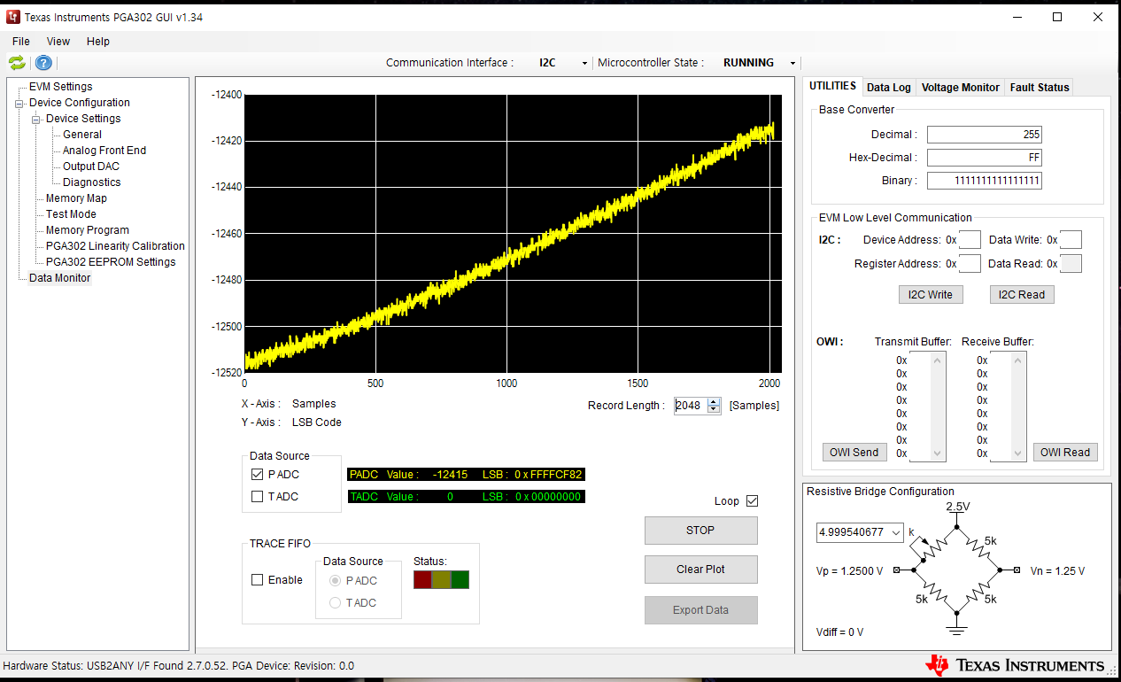

  • The graph above is the graph read from MCU.
    Since there are 2 channels, 2 graphs have appeared.
    VINPP is 10mV, VINPN is -10mV.
    The value of the magnet was read with the Hall sensor.
    Hall sensor is connected to the input part of PGA302.
    And this is a graph taken with the PGA302 EVM.
    The magnet is measured at the S pole end and does not move.
    However, the AD graph of the PGA302 is moving.
    The AD of the PGA302 is moving, but the DAC must be constant.
    The value should always be output consistently according to the position of the magnet.
    Is there a way to set it on the PGA302?
    thanks.
  • Hello Seok,
    Is the hall sensor output/VINPP/VINPN input measured separately for the entire time period? My suggestion is simply to remove the ADC input as a variable. Even if the hall sensor is very stable, unless it is also measured by another instrument across the same time period it can't be ruled out as a potential cause for the drift. The simplest way to do this would be to use an external power supply to provide the input to the PGA302.
    And to further clarify about the two sets of data, you mention two channels. So you have 2 separate PGA302s that are feeding data into your MCU?
    The DAC output will always be relative to the ADC input. There is temperature and nonlinearity compensation available through the calibration coefficients, but there is no time component. Unless the drift is caused by temperature changes and can be calibrated out, the DAC output will show a similar drift over time.

  • Hi Seok,
