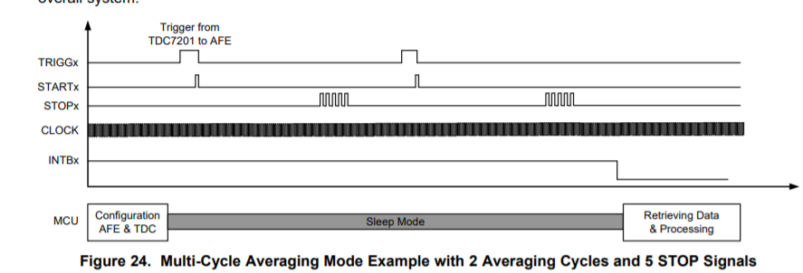

  • From the Multi-Cycle Averaging section of the data sheet:
    128 cycles should produce 128 TRIGGx pulses.
    Gabriel

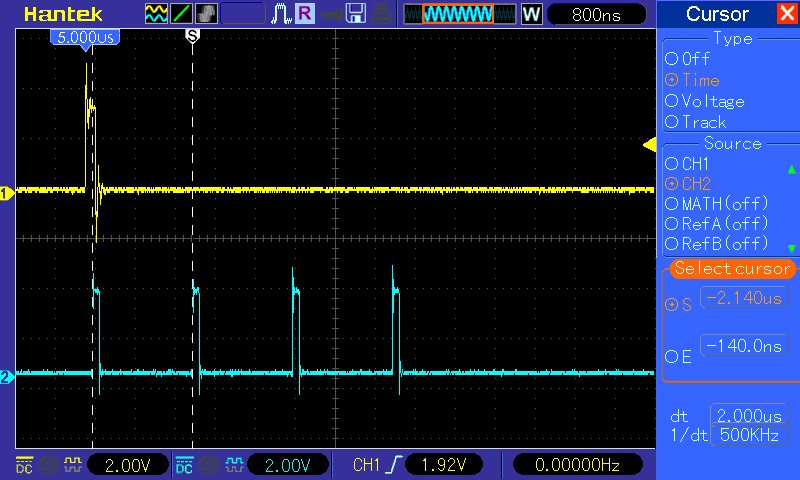

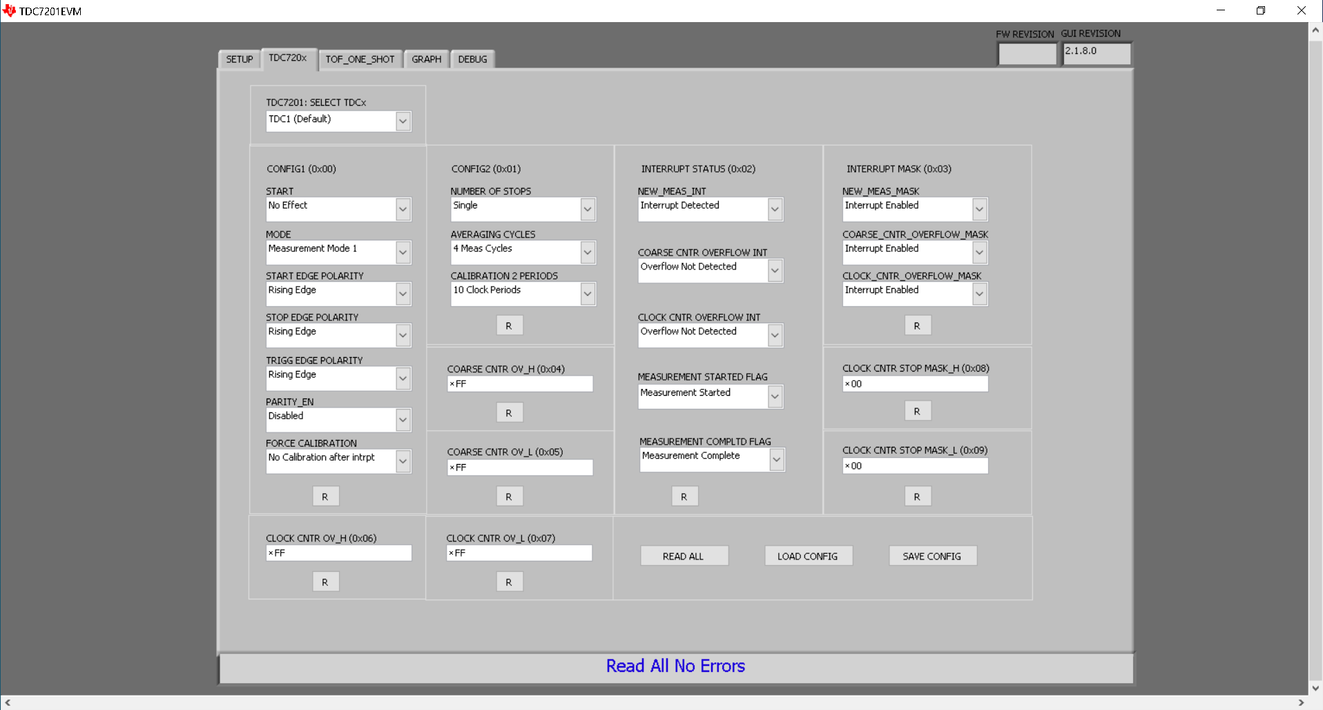

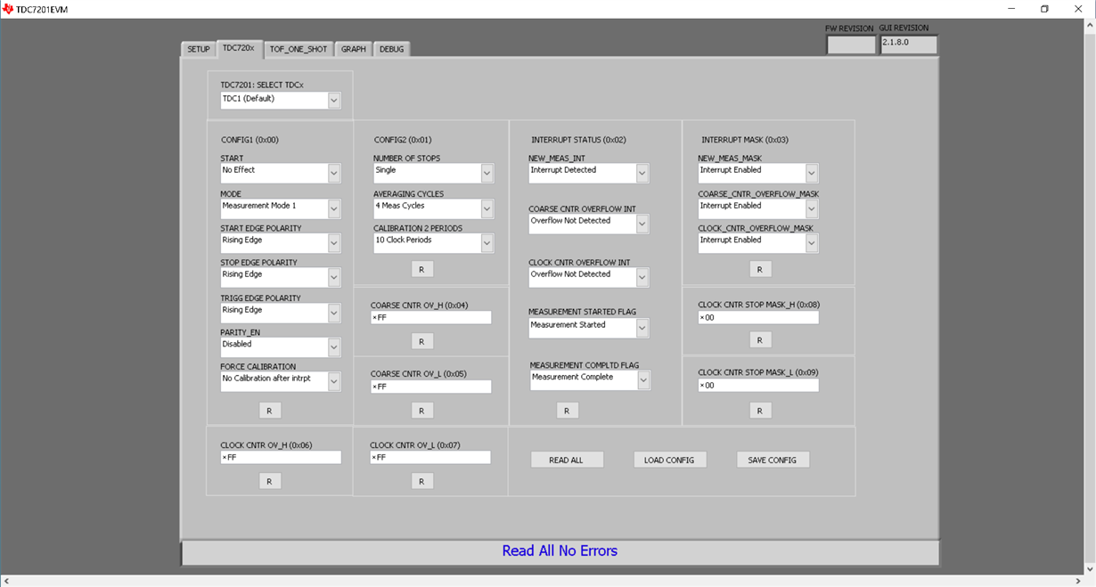

  • Thank you for your answer.
    For example, the settings for averaging 4 times are as shown in the figure below.
    With this setting, the trigger pulse is generated only once.
    Ch1 in the figure below is a trigger. ch2 is the start pulse.
    The start pulse is input 4 times every 2usec. If set the rate to less than 2usec, [measurement incomplete] will occur.
    Trigger is one time not 4times.
    Is there a mistake in the register settings?
    regards
  • Try setting the CALIBRATION 2 PERIODS down to 2 periods instead of 10. Using an 8MHz clock, calibration 2 is taking up 1.25us. I would also recommend using a 16MHz clock if possible. To use an external clock, change JP2 on the EVM and the GUI setting in the 'steup' tab. (see user's guide)
    Also, with 4 pulses in this configuration, you can expect 2 measurements to be taken, the one between the first pulse pair and another between the second pulse pair. I.E. 2 TRIGG pulses. Do you see this expected result if you increase the period of the start/stop pulses?
    Let me know if this helps, and if not, I will try to replicate this behavior with an EVM by the end of day tomorrow.
    Gabriel
    In the case of an 8MHz clock, it takes 125nsec * 10 = 1.25usec to calibrate.
    On the other hand, it remains questionable that the multi-cycle averaging trigger pulse occurs only once, regardless of the average number of times.
    It will not operate unless the average number of start and stop pulses are input for one trigger. For example, if you average 4 times, you have to input 4 start and stop pulses to one trigger.
    The data sheet diagram shows that as many trigger pulses as the average number of times occur.
    However, even with a 4-time average, the 4-time trigger does not occur.
    Please check the operation of the average and explain it.
    regards
