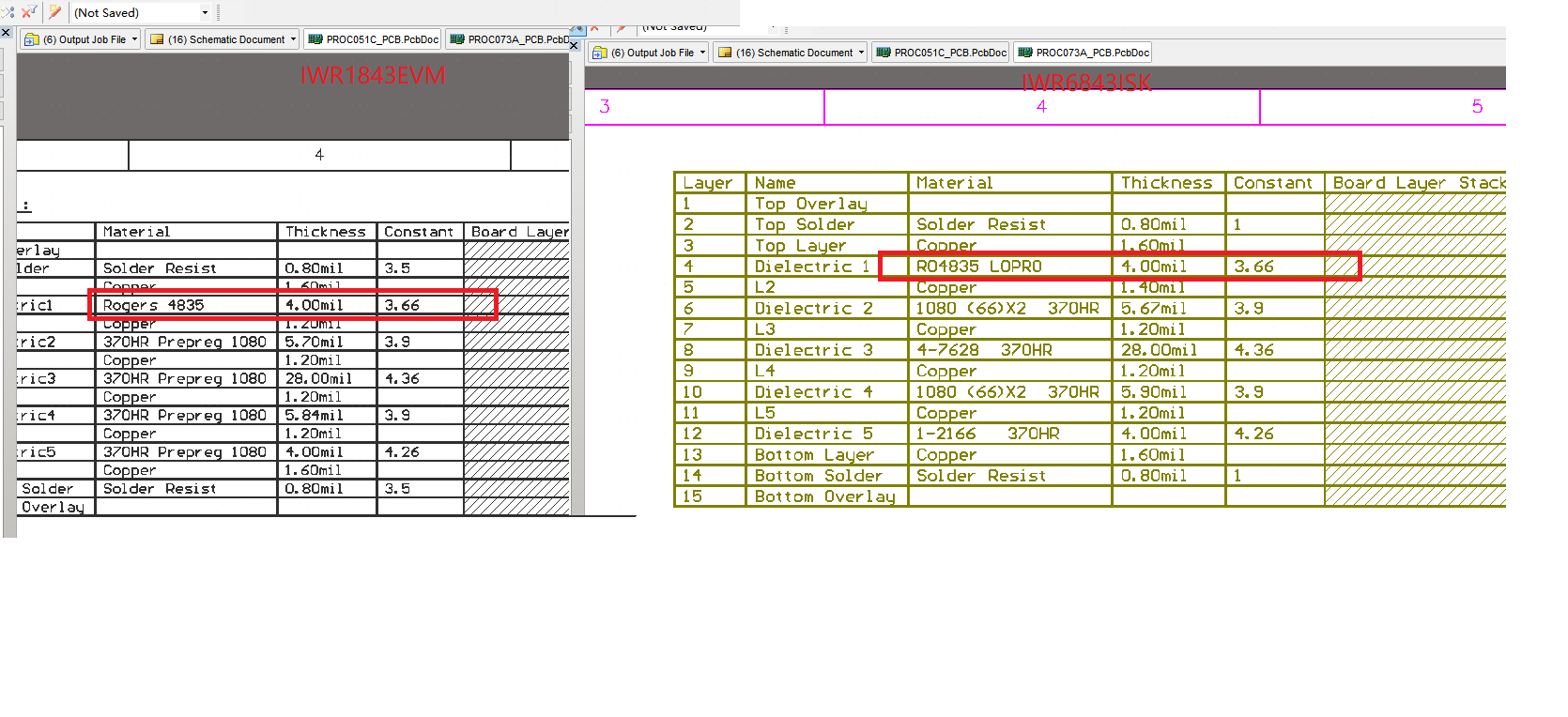

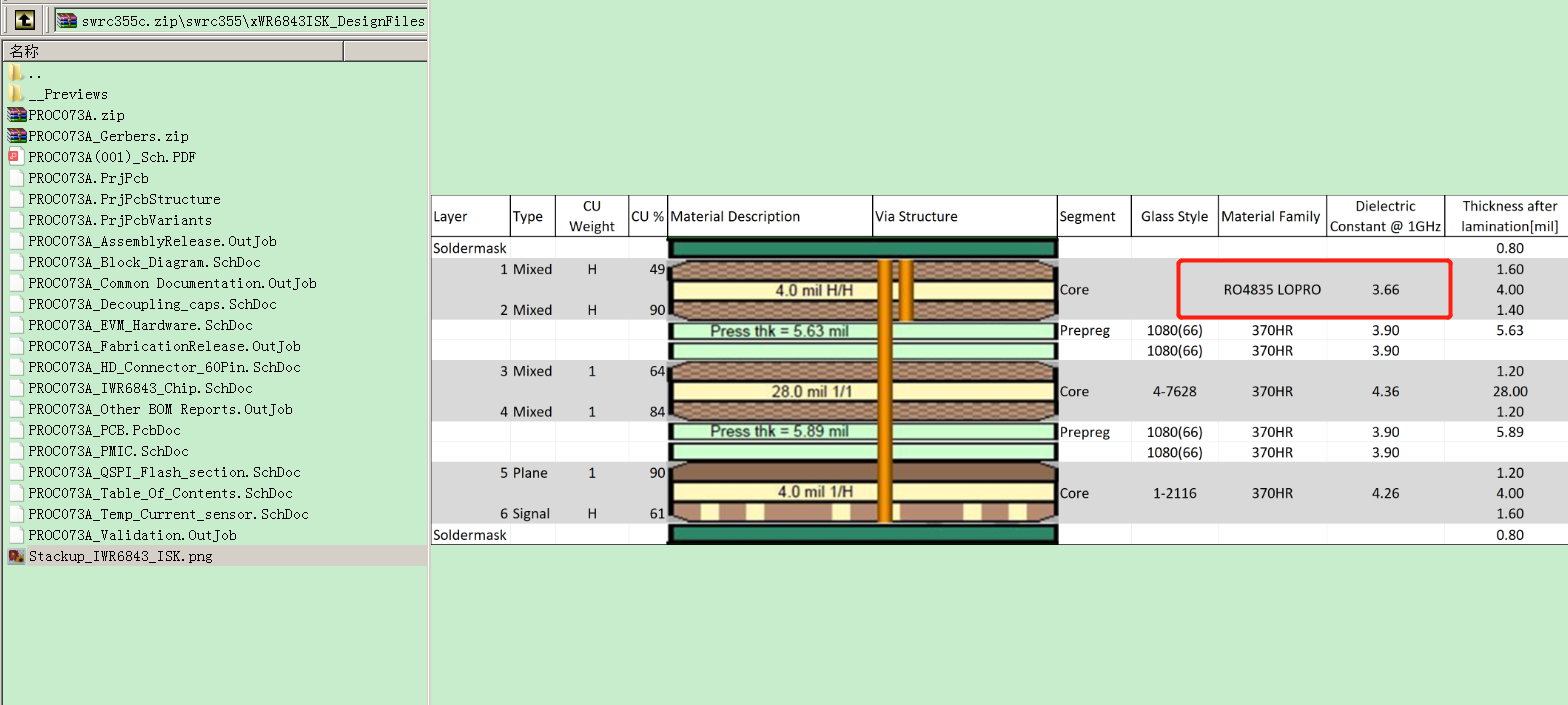

We noticed the DK of Ro4835 LOPRO in swrc355c.zip stackup  is 3.66
As I know ,the DK of  Ro4835 is 3.66 and the DK of Ro4835 LOPRO should be 3.48
We need to know the exactly DK of Ro4835 LOPRO to simulate antenna.
Could you please help us to check whether I was wrong with DK?
