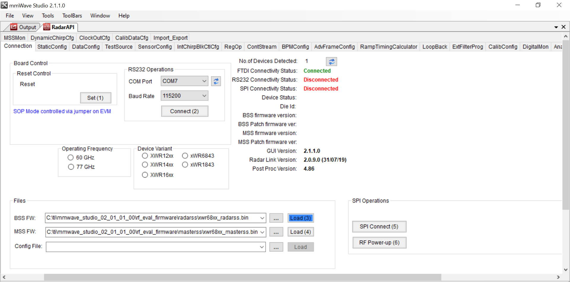

I am using IWR6843ISK-ODS with DCA1000 to capture raw data. I have installed all the drivers. However, on connecting RS232, I am getting the following error:
[08:49:08]  [RadarAPI]: Opening Gpio Control Port()
[08:49:08]  [RadarAPI]: Status: Passed
[08:49:09]  [RadarAPI]: Opening Board Control Port()
[08:49:09]  [RadarAPI]: Status: Passed
[08:49:10]  [RadarAPI]: ar1.FullReset()
[08:49:10]  [RadarAPI]: Status: Passed
[08:49:11]  [RadarAPI]: Closing Board Control Port()
[08:49:11]  [RadarAPI]: Status: Passed
[08:49:11]  [RadarAPI]: Closing Gpio Control Port()
[08:49:11]  [RadarAPI]: ar1.SOPControl(2)
[08:49:12]  [RadarAPI]: ar1.Connect(7,115200,1000)
[08:49:12]  [RadarAPI]: Error: Serial Port Init(): A device attached to the system is not functioning.
[08:49:12]  [RadarAPI]: Error: Connection failed: Calling_ConnectTarget returned 1
[08:49:12]  [RadarAPI]: ar1.Calling_IsConnected()
[08:49:12]  [RadarAPI]: ar1.SaveSettings('C:\Users\Usman\AppData\Roaming\RSTD\ar1gui.ini')

Here is mmWaveStudio's snapshot:

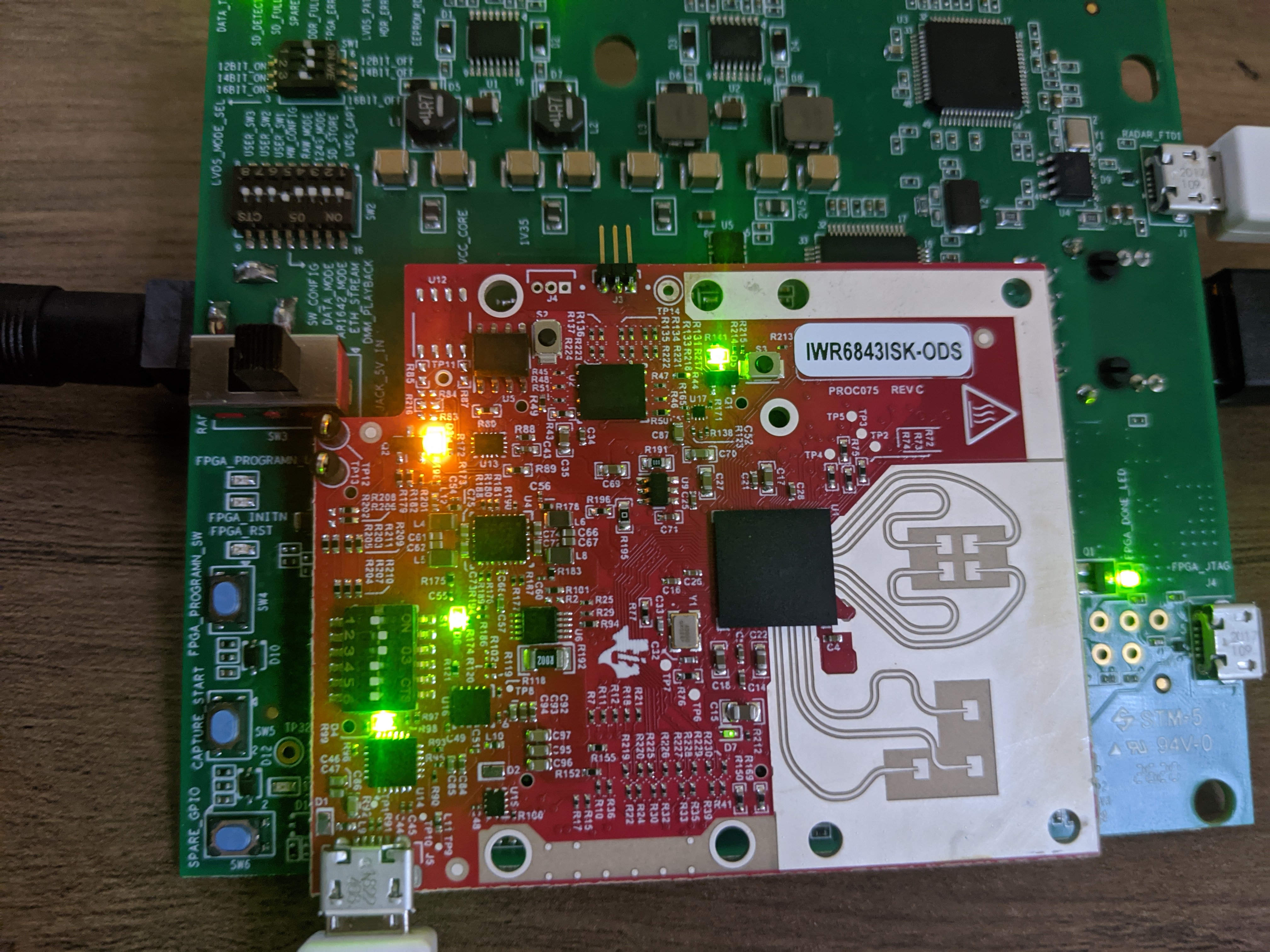

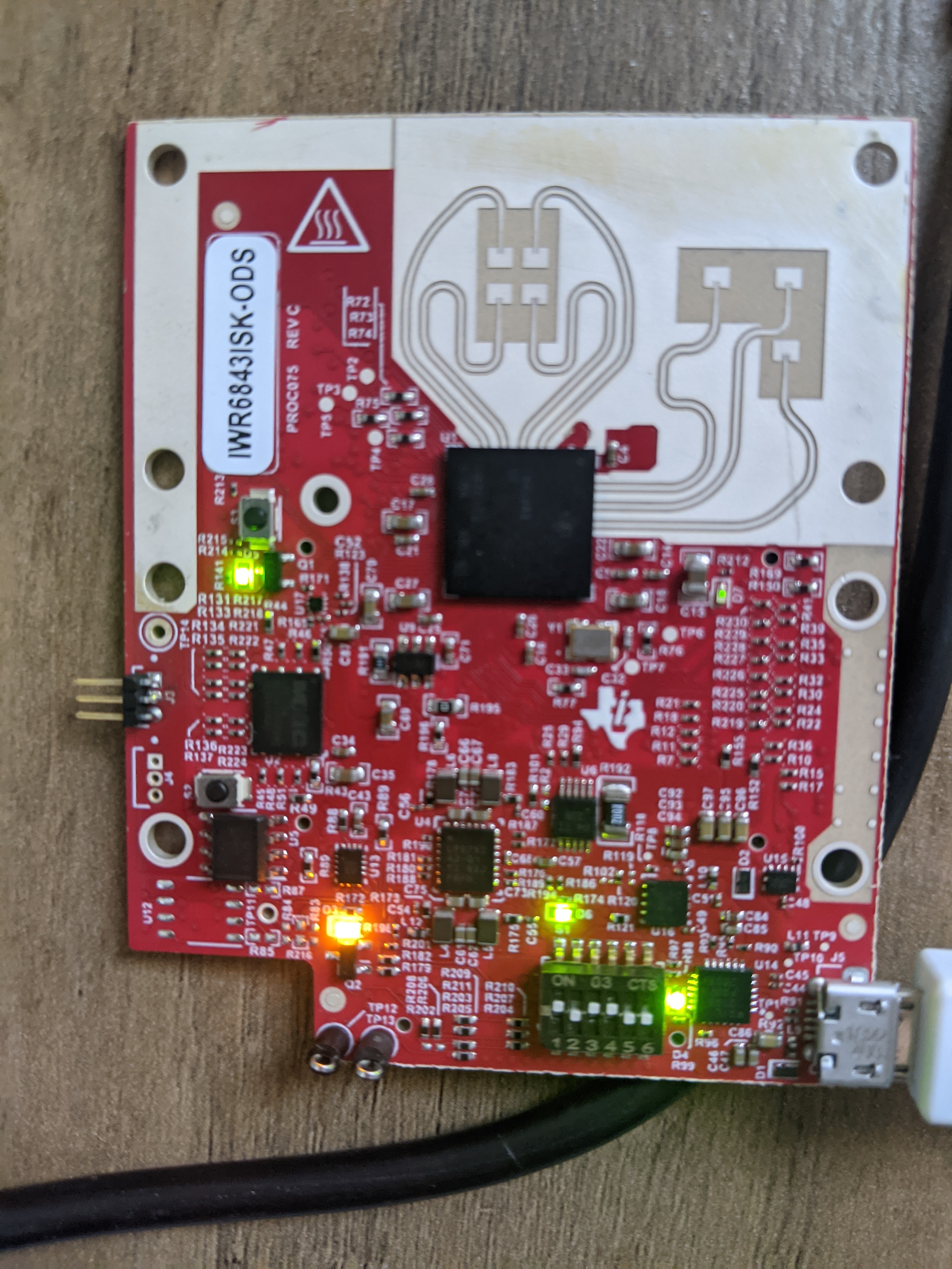

Here is a picture of my setup:

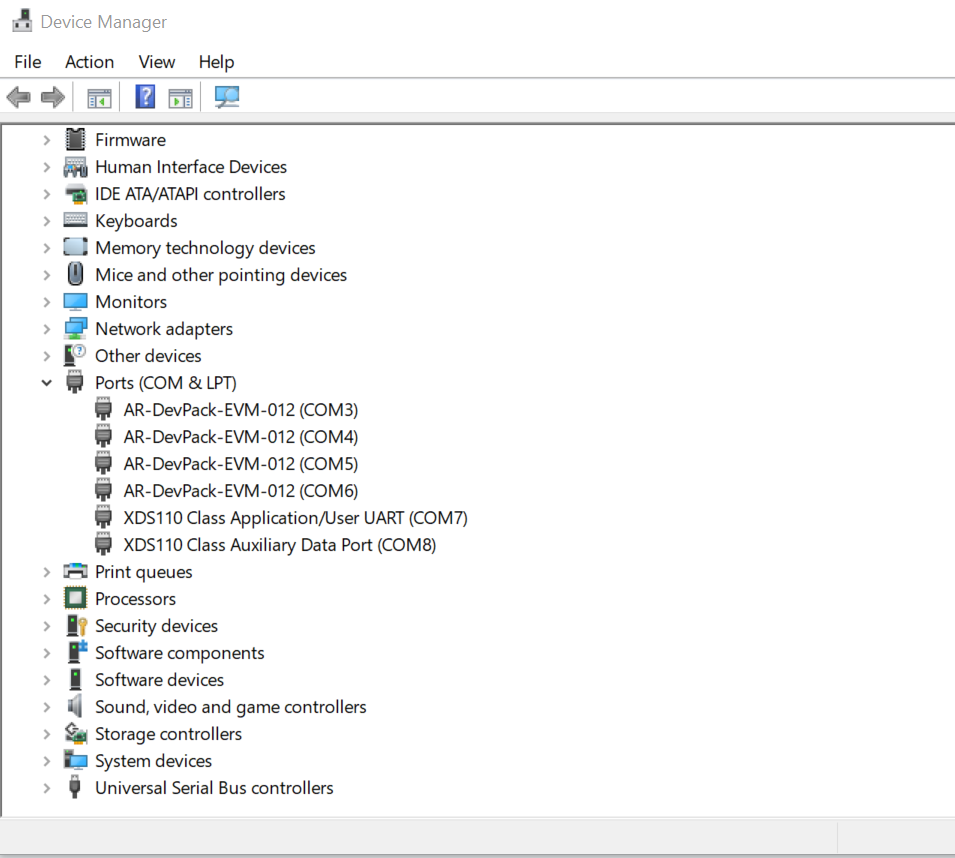

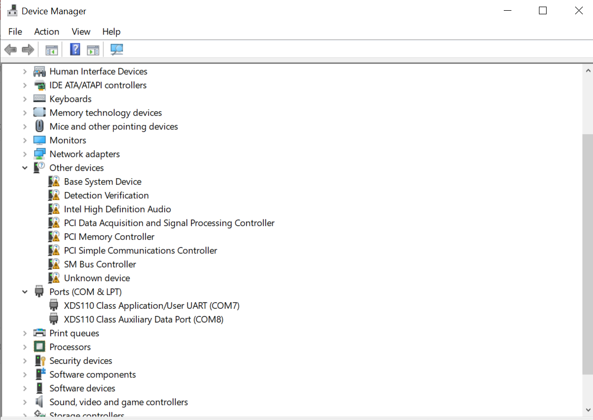

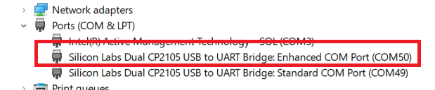

I am connecting the USB ports and ethernet cable to an Intel NUC. The power supply to DCA1000 is rated 5V, 3A. I can see all the COM ports correctly on the device manager.

If you look closely at the setup picture, the D7 LED on IWR6843 is ON. Does it indicate anything?
