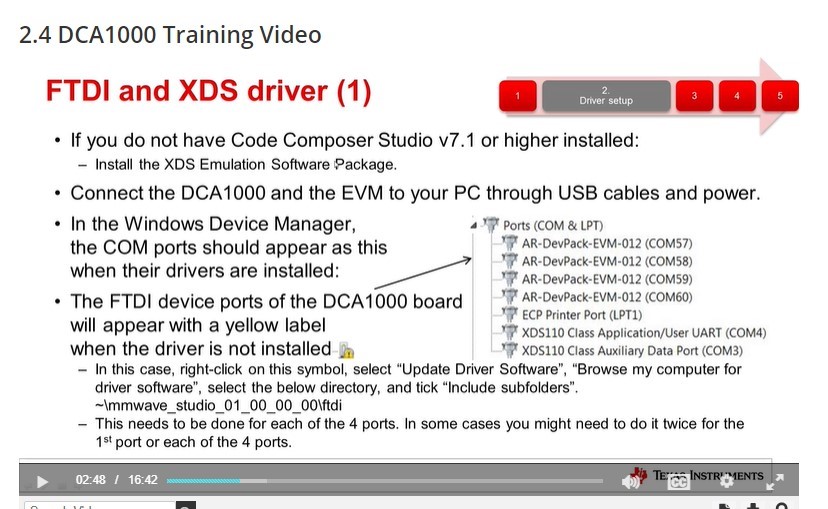

I am setting up TI mmwave radar IW6843 with real time data module DAC1000 to collect some raw data
I am having some trouble getting DCA1000 recognized on my PC
My windows device manager is not recognizing i.e., I can't find any COM ports
On slide 11, it says that I should see 4 ARM-devpack COM ports for DCA1000 board. However, I don't see them.
https://e2e.ti.com/cfs-file/__key/communityserver-discussions-components-files/1023/4544.mmWave_5F00_sensor_5F00_raw_5F00_data_5F00_capture_5F00_using_5F00_DCA1000_5F00_xwr6843.pdf
In addition to that, customer had already tried these following steps below. However, they still don't see any FTDI port in my device manager.
reference guide from e2e: e2e.ti.com/.../825630

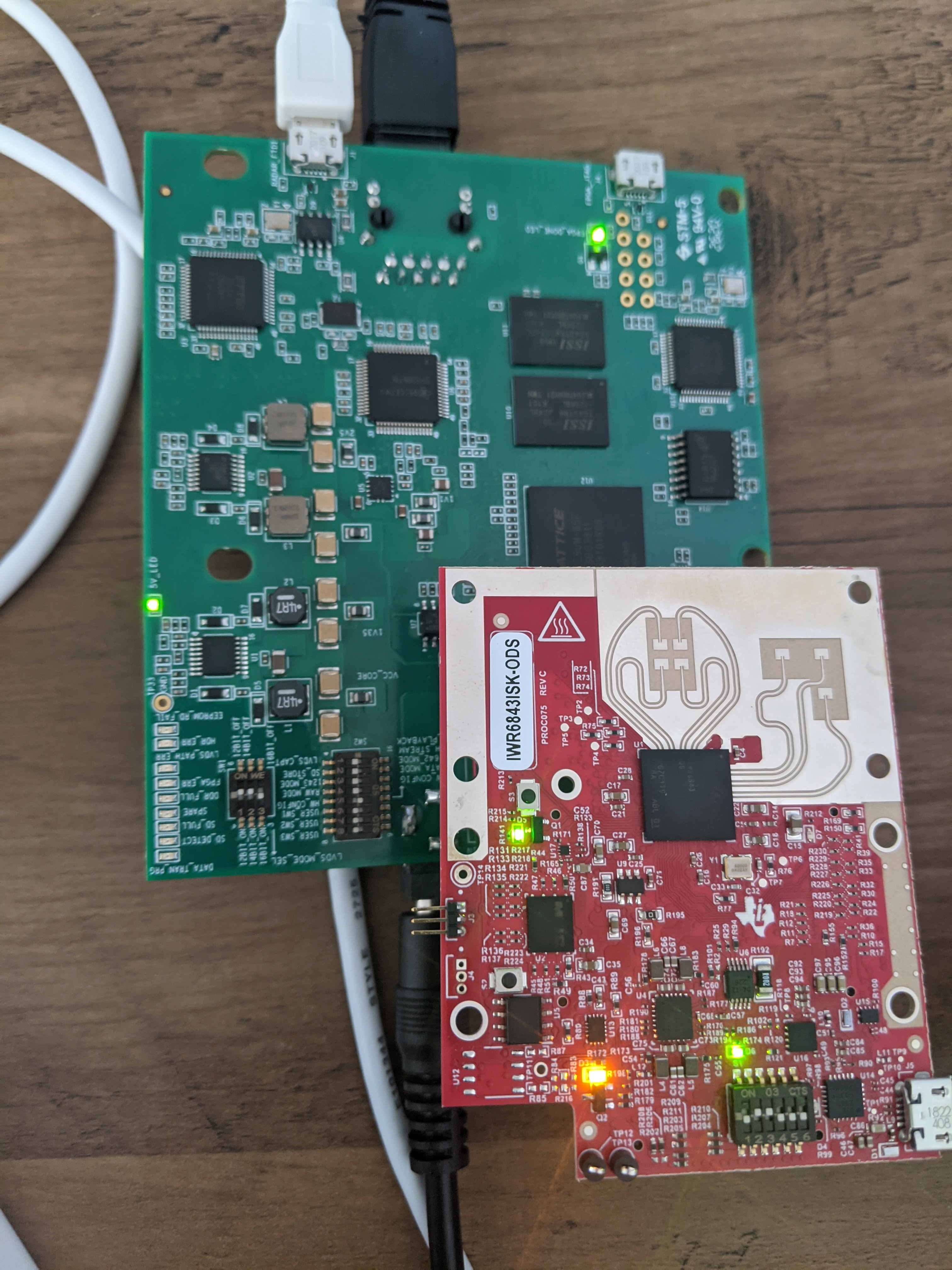

- have a USB cable connected to RADAR_FTDI port of DCA1000.
- have installed FTDI drivers.
- DCA1000 is separately powered through a 5V supply.
attached actual hardware setup image
