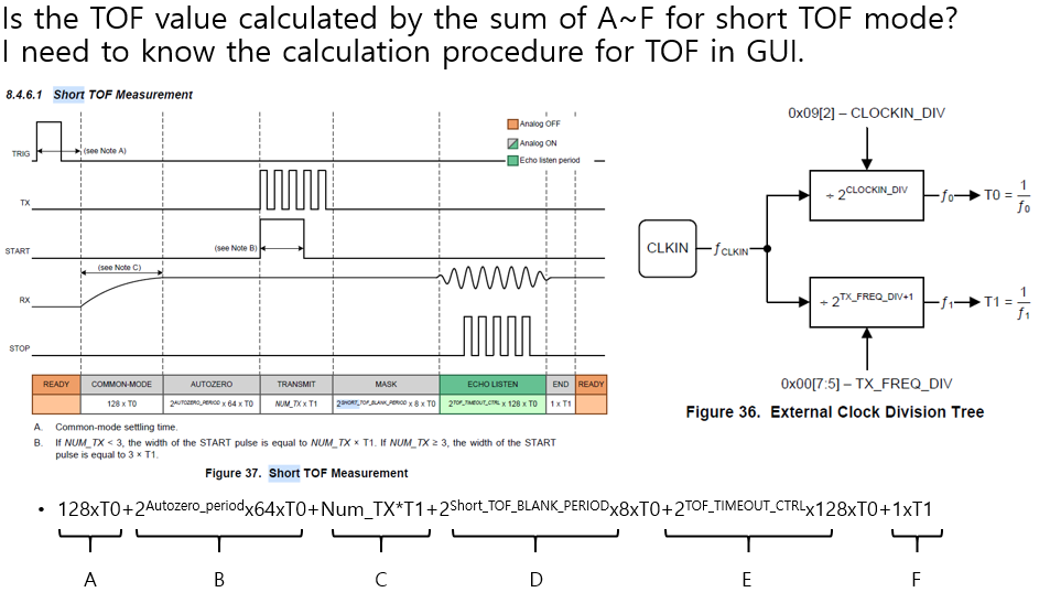

I am working on ultrasonic sensor to get differential liquid height and I need to calculate TOF value given by GUI.
I am using short TOF mode as it gives me less scattering for my application.
Please go through the six questions as below and give me replies. I will really appreciate your help.
Please tell me if you have anything to clarify.
Minrak Kim
  • Hi Minrak,
    To adjust the device settings according to your measurement parameters, the expected ToF should fall within the time: C + D + E, assuming TOF_TIMEOUT_CTRL is enabled.

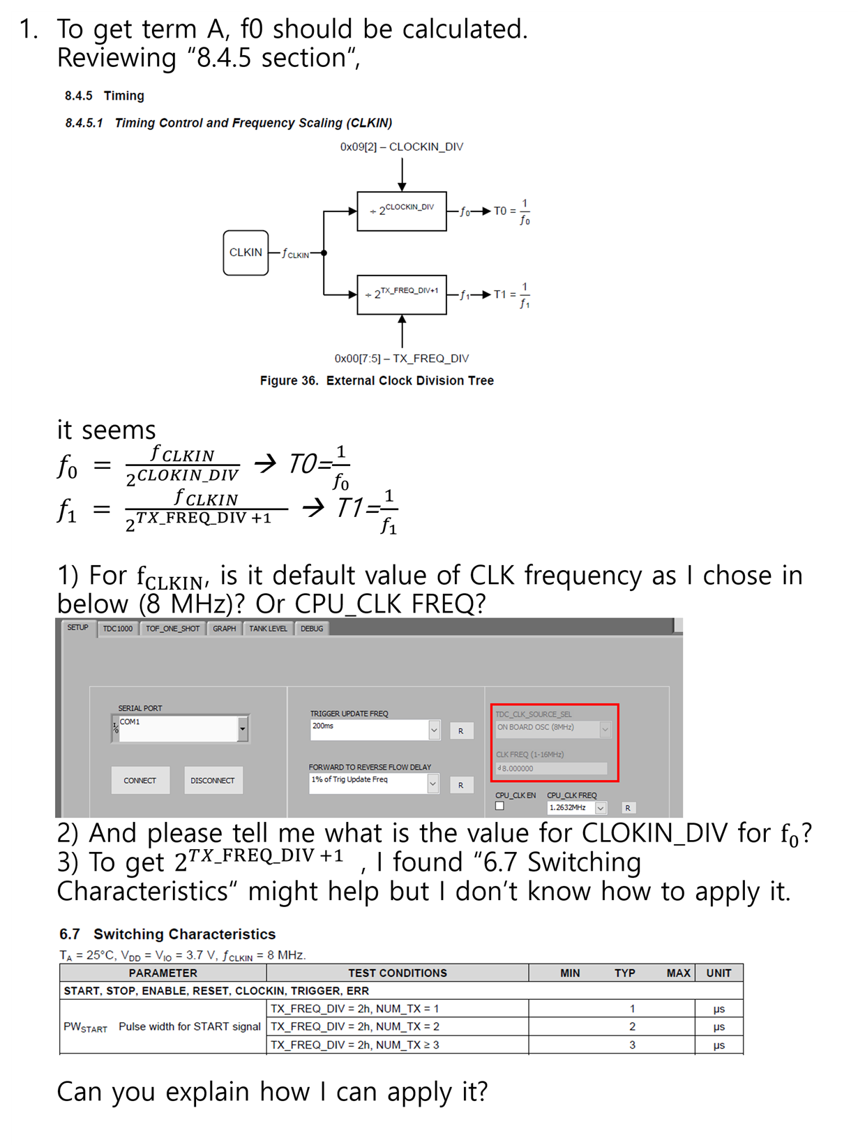

    1) Given the formulas for T0 and T1 above, T0 is controlled by the CLOCKIN_DIV register setting, which is a value of 0 or 1, meaning that f0 is either the same as f_clockin, or f_clockin/2. Similarly, T1 is controlled by TX_FREQ_DIV, which is the register setting that controls the transducer excitation frequency. In the default device and GUI case, f_clockin is 8MHz, T0 = 1/8MHz (CLOCKIN_DIV=0), T1 = 1/1MHz (TX_FREQ_DIV=2).

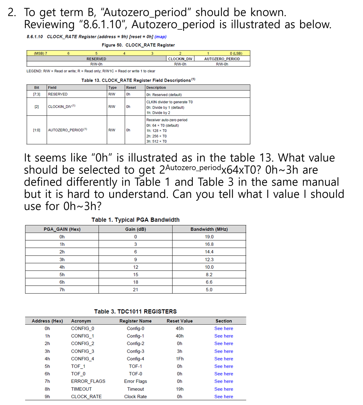

    2) I recommend leaving AUTOZERO_PERIOD as the default value.

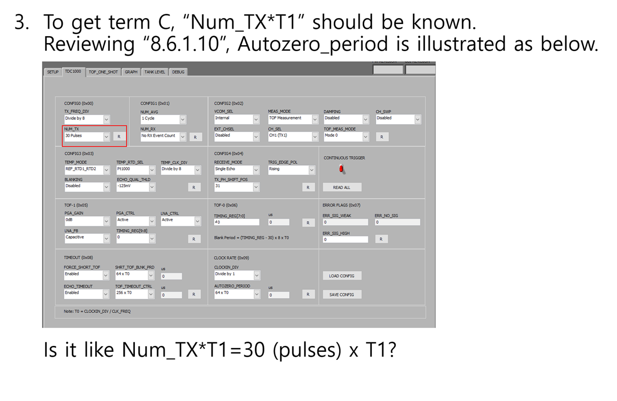

    3) Yes, your example for NUM_TX*T1 is correct.

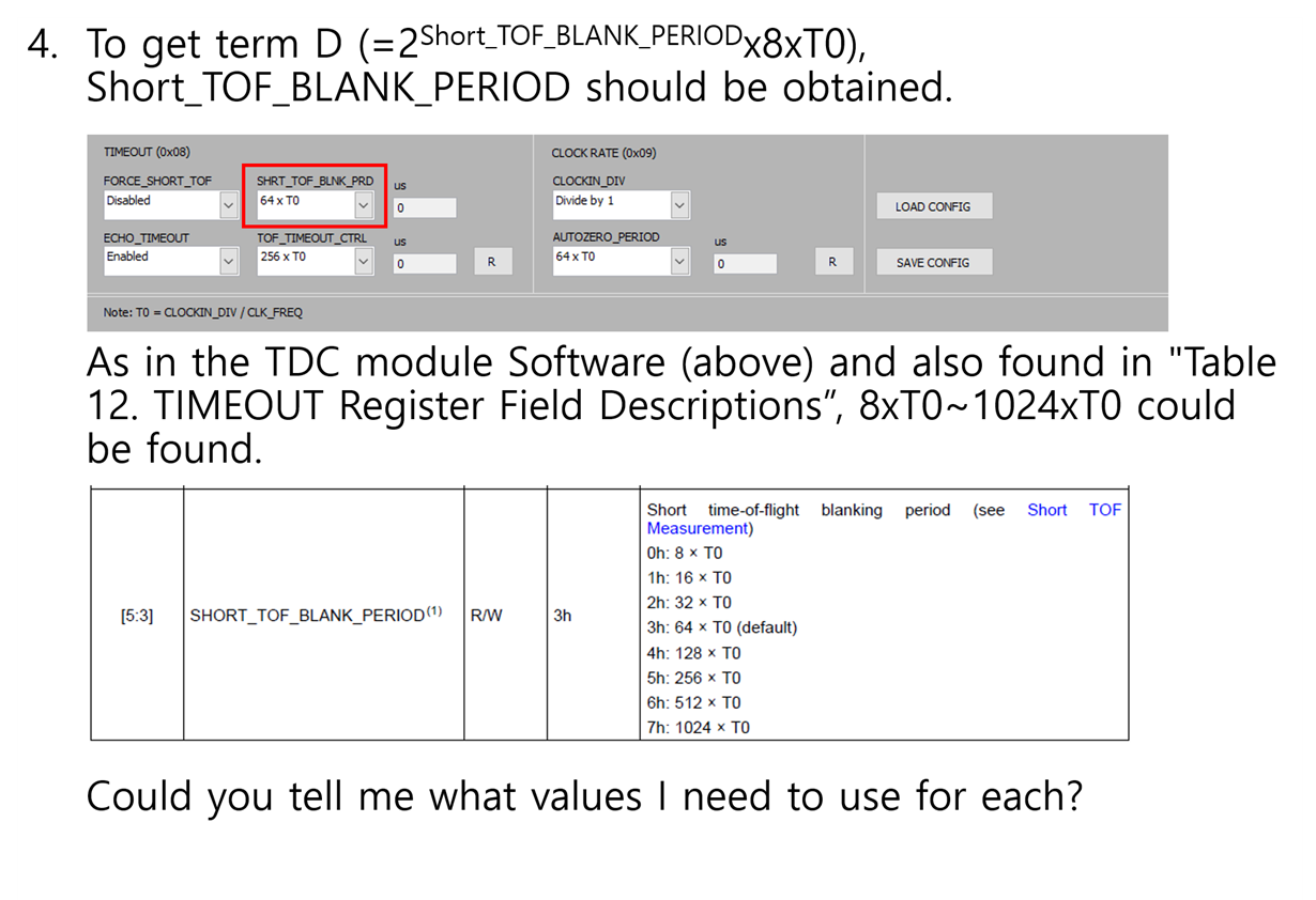

    4) SHORT_TOF_BLANK_PERIOD determines the length of time before the listen period begins. This should be customized to your expected delay. Also, note that this settings may require some experimentation to obtain a good ToF result.

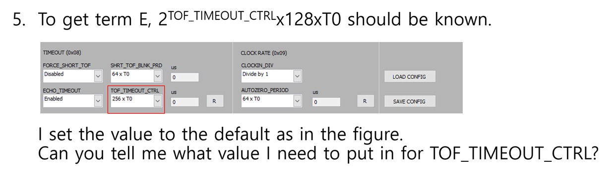

    5) TOF_TIMEOUT_CTRL adjusts the listening period. This should be set based, along with SHORT_TOF_BLANK_PERIOD, based on the expected range of ToF measurements to be made using the same device settings, and the measurement frequency. Use the formula to determine the value for TOF_TIMEOUT_CTRL, and make sure that ECHO_TIMEOUT is enabled to use this setting.
