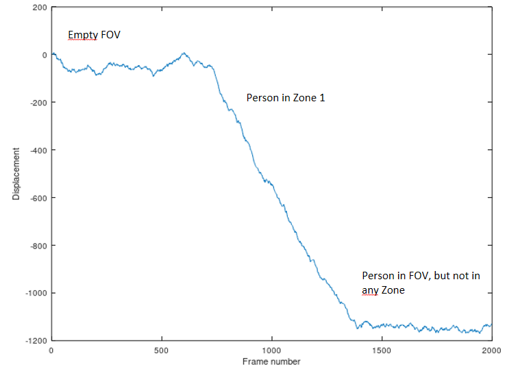

To test this I've tried out Vital Signs and Occupancy Detection demo from Automotive Toolbox 3.2.0 with default chip configuration provided for AWR1843 (10fps). I have used this board for Vital Signs demo and it worked well (plots had breathing and heart components clearly visible). In case of this demo, presence of object is perfectly visible on heatmap, but its presence doesn't seem to have impact on displacement and phase plots. From what I have noticed, signals from both zones looks similar. If there is another person in second zone, signals are still similar. I am not able to resolve if there is any person in any zone from phase signal shape (which is not a problem in standard Vital Signs demo). Me and my colleague made experiment in which we were breathing with different, but stable rate (12 and 20 breaths per minute respectively). Calculated breathing rates were completely off and frequency content in breathing signal did not show expected results. As the example, in the figure below I have plotted displacement data from zone 1.

    Lets put aside the paper (it was written by TI employees and I just guessed it is connected with VS and VOD demos, as the steps of signal processing are similar). My main question is how does signal processing such as beamforming or combining of two virtual antenna strings should affect phase signal? VS demo, which does not contain beamforming works well and the phase signal reflects object breathing and heart rate. On the other hand, VS and VOD demo which has RX beamforming  does not show any sensible data - phase signal no longer reflects object breathing or heart rate. Further signal processing also does not reveal any meaningful results.

    When the target is an ideal point target, then combining the signal from different antenna should increase the SNR by 10*log10(N) dB, where N is the number of antennas.
