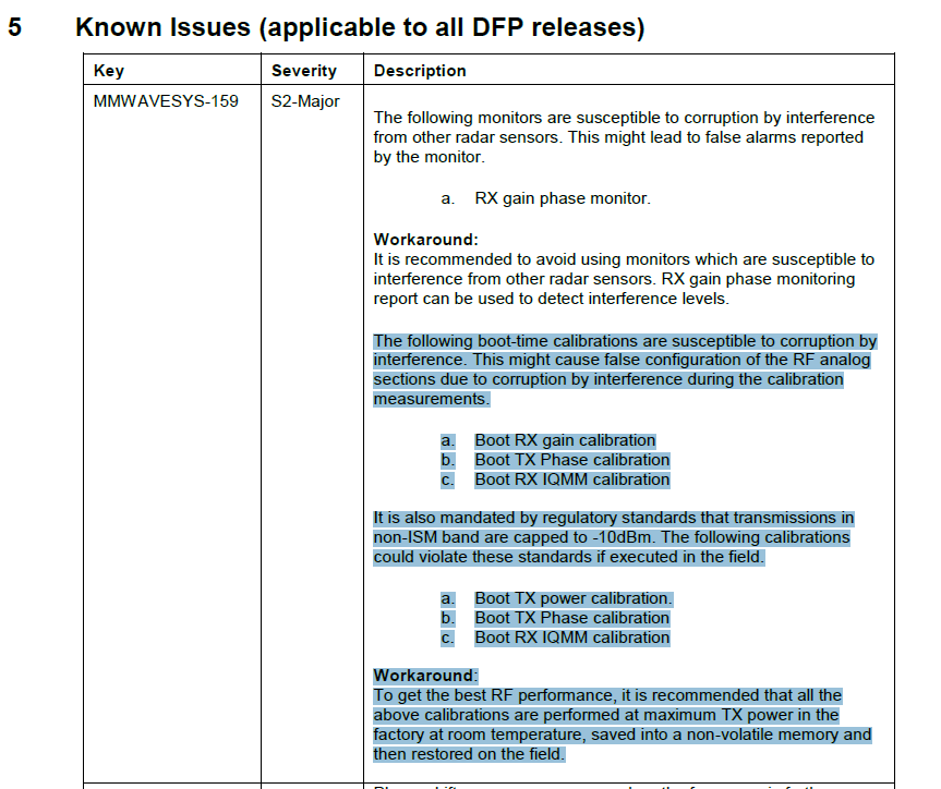

calibdata configuration command  is boot time RF calibration save/restore command .
There are many environmentally sensitive items that are calibrated by this command.
but there is no environment setting for this calibration in the "mmwave_sdk_user_guide"
Is it possible to run this command without setting a specify environment ?
(e.g., if you bring your hand to the radar sensor during calibration, it will not correct the wrong value)
second question
b1 APLL tuning (Ignore while restore)
In above , what means "ignore while restore"
