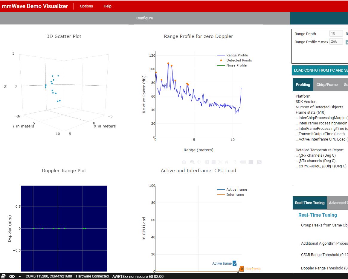

    I changed channel config command "channelCfg 15 5 0" to "channelCfg 15 7 0" for enabling 3rd tx antenna(value 15 already enable all 4 Rx channels). But still Z-axis is 0 for all the detected objects. Is their anything else to be changed to get z-axis info?
    X : -0.081804, Y : 0.030364, Z : 0.000000, Velocity : 0.000000
    X : -0.276769, Y : 0.129106, Z : 0.000000, Velocity : 0.000000
    X : -0.254955, Y : 0.406592, Z : 0.000000, Velocity : 0.000000
    X : -0.449921, Y : 0.167004, Z : 0.000000, Velocity : 0.000000
    X : -0.257682, Y : 1.149445, Z : 0.000000, Velocity : 0.000000
    X : -0.662611, Y : 0.973946, Z : 0.000000, Velocity : 0.000000
    X : 0.916202, Y : 3.548437, Z : 0.000000, Velocity : 0.000000
    Vipul Kumar
  • Hi Vipul,
    Please follow below snapshot for the right step/setting which I have tested here
    Here it shows objects in 3D view
    Flashed mmw demo from mmWave SDK 3.5 to AWR1843Boost.
    Jitendra
