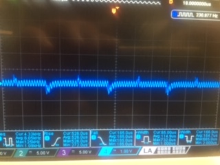

    In the picture below you can see the profile detected by the oscilloscope:

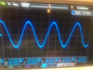

    In this other picture you can see what kind of profile PGA970 software demo on board is able to generate using the same register settings:
    Probably I forget some detail but I followed step by step 7.5.6 section and I crosschecked the the PGA970 software demo implementation. What am I doing wrong?

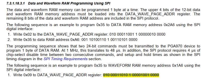

  • Hi Scott
    I'm working hard in order to generate the Primary excitation.
    It doesn't match with the Register  DI and offset:
    DI = 0x2
    Offset = 0x19
    010 00011001 1 00001001 0000
    the bit 13 and 14 are swapped.
    What have i consider correct?
    In order to write Waveform RAM memory filling it with 83 samples (Quarter wave), considering that starting address should be 20000800, what address page should I use (0x08 0r 0x09)?
    We would like to use in our application the PGA970 but this issue is the last obstacle thank you
    Carmine
  • Hi Scott
    Finally I fixed the technical software issue: I indexed wrongly the For loop because I used uint16 instead of uint32 index i type that corrupted the shifted left  13 instruction.
    I erased the demo program completely in the PGA970 and then I run my external micro in order to configure all registers via SPI. I was able to write DATA_WAVE_PAGE_ADDR_8 and all RAM location reserved for the quarter sine wave samples.  Finally 3kHz sine wave has been successfully detected with an oscilloscope.
