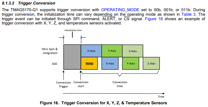

    At final release, the T_CH_EN will not be required to enable the temperature compensation.
    As far as the timing of the conversion, it will happen serially with the Hall conversions as shown in the capture below.  After the device is initialized and when operating in continuous mode, each step of the pipeline occupies approximately 25 µs .
