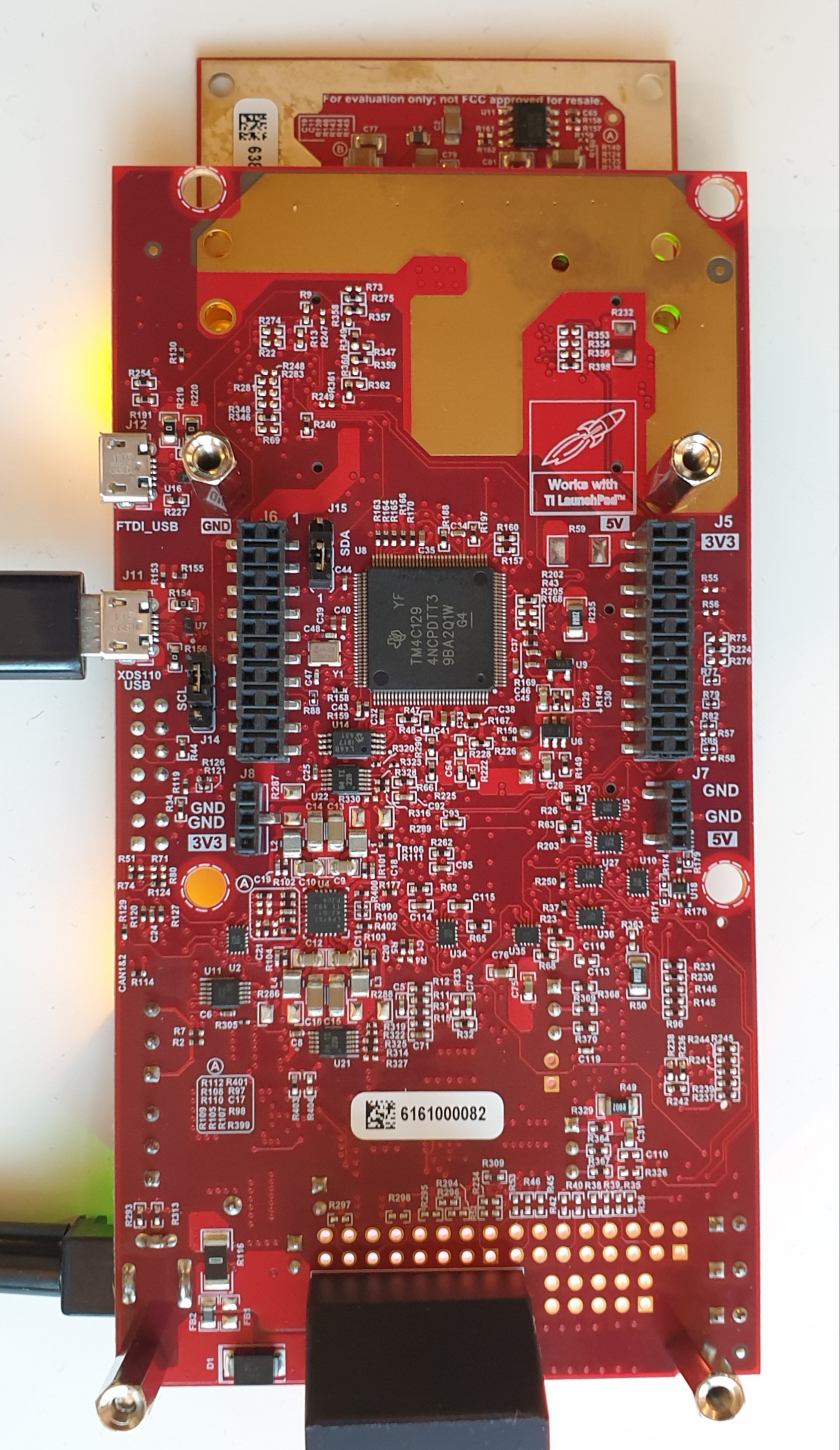

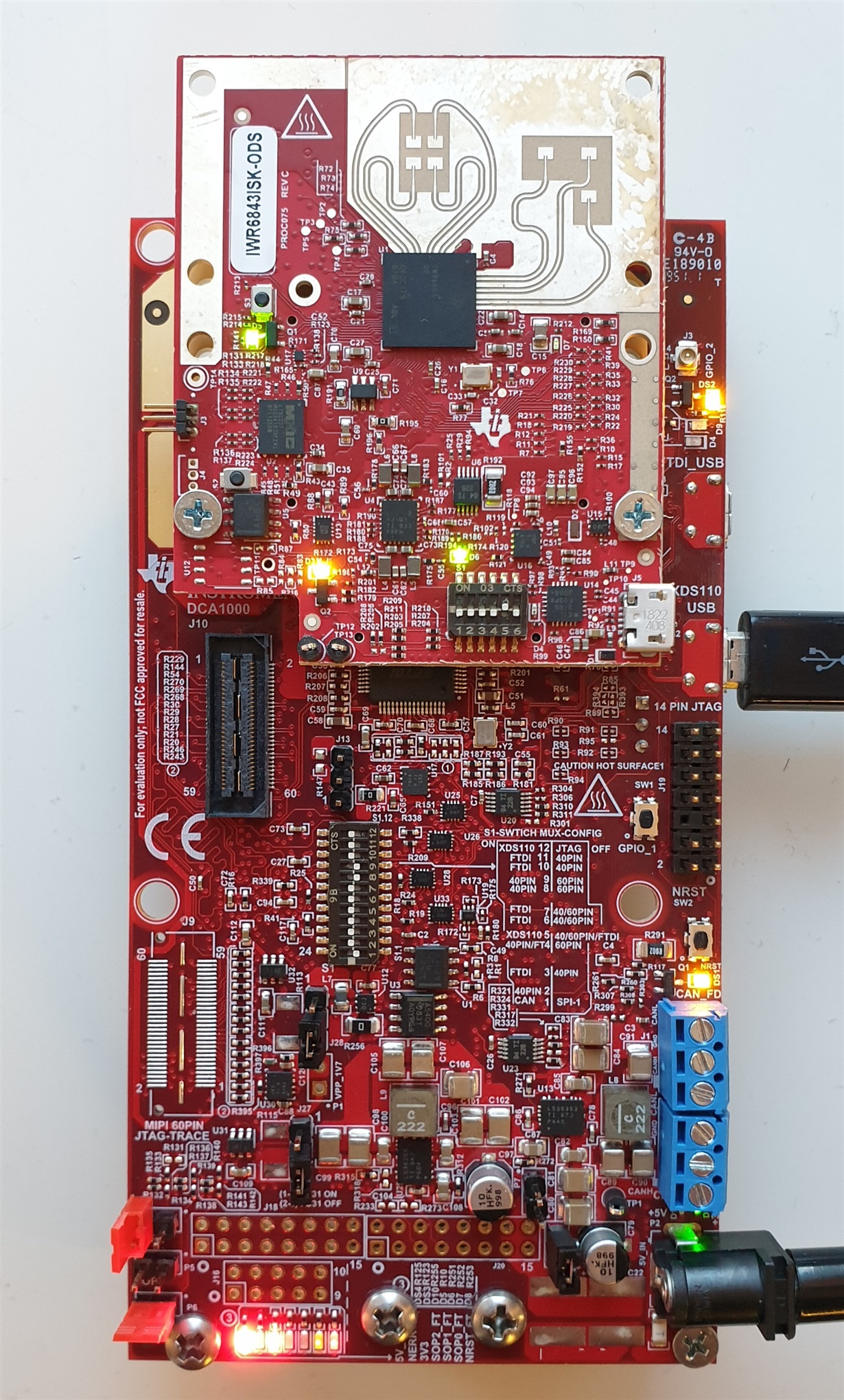

    5. Lastly, can you share a picture of the set up both front and back?

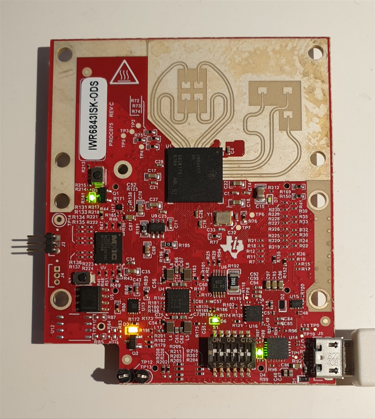

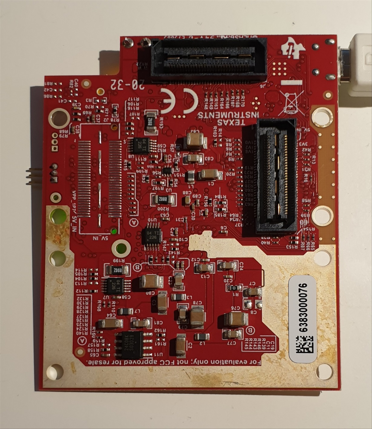

    I tried using only the IWR6843ISK-ODS board with the following results:
    I'm able to consistenlty program the device with Uniflash using COM6, which is the following port:
    However, I'm unable to send any configs in either visualizer with only the ODS board in use.
    For some starnge reason uniflash work but demos don't. Some issue with COM7?? I tried it all, USB/RST sequences, changing the ports and speeds but nothing seems to work. I did not expect this to also fail. Currently I'm unable to get any demo connection to either of the board setups and this is seriously hurting my task timelines.
    Here are pictures of the ODS only setup:

    5. Here you go:
    (Yes, it is not the provided USB cable but trust me, I have tried with both original and this one, no change)

    Just to confirm when using the board in standalone mode, after flashing are you updating the SOP switch to flashing mode and power resetting the board?

    Update regarding my latest post; The ODS board not working even by itself, was a false alarm. I failed to flip ODS SOP from flashing to functional, as you also correctly hypothesized in your response. Sorry for that false alarm, ODS board on it's own work as expected.
