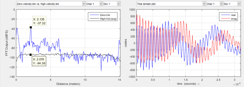

TIDEP-01012: IF amplitude varying over the chirp
Part Number: TIDEP-01012
Dear Support,
I have run the mmWave Studio 03_00_00_13 4chip_cascade_MIMO_example example on the TIDEP-01012 and get the follow result.  Can you let me know why the ampitude of the beat signal in the plot on the right decreases from 1400pk-pk to ~ 200pk-pk over the duration of the chirp?  It seems to do this irrespective of target range which leads me to think that it is not caused by a fading issue.  Well please let me know if you know what may be causing this issue and how it can be rectified?
I appreciate your help with this.
Best regards
Jonathan
