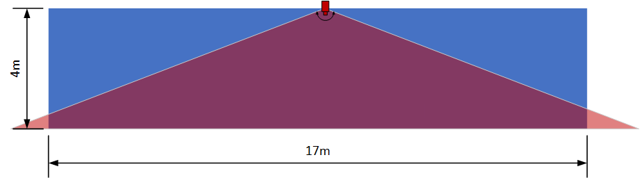

  • Hi Nitin,
    Thank you for the reply.
    The max range requirement of the security system is about 17 m. The field of view is pictorially represented below. It completely depends on where the sensor system is placed on the vehicle. The first two pictures  are both side view where the sensor system is placed in two different places on the vehicle. Our major goal is to calculate the distance between the vehicle and an approaching person - the maximum distance needed between these two object is 2m, which is presented in the third top view picture. Therefore, the sensor system would detect the points from the vehicle itself and also presence of human in the field of view. Here I'm assuming the points from the vehicle itself would be static points and the moving target detection would be the human or humans. Please do let me know if you need more information.

  • Hi Divya,
    It's a distinction we have made based on the intended use case and one of the factors determining that use-case is range. So as I mentioned earlier, the people counting demos are targeted towards tracking and counting people within a room e.g. up to 3-4m radial in case of overhead people tracking demo and up to 8-10m in case of wall mount people counting demo. Since these demos are meant for counting people, they implement 3D capon beamforming detection chain which provides a higher angular resolution but is meant for short ranges and low velocities (human walking motion). The detection and tracking layer parameters are tuned accordingly for this use case.
    The Long range people detection and tracking demo on the other hand is meant for relatively coarse tracking of people at higher range, e.g. up to 50m. It uses the detection chain which is used in the Out of box demo. This detection chain, commonly referred to as the range-Doppler processing chain is able to detect objects (including people) at longer ranges but has lower angular resolution as compared to the Capon beamforming chain. The detection and tracking layer parameters are also tuned accordingly for long range use case meant for tracking people (but not counting) at relatively larger distances which is why we call it an outdoor demo.
    I misspoke about the Area scanner demo earlier so need to correct myself: The Area scanner demo is also based on the Out of box demo i.e. the Range-Doppler based chain but it has the added functionality added for static object detection. It can detect and track moving targets at up to 15m but note that the static object detection works at up to < 5m.
    Note that for all these demos, the sensor is expected to be stationary for the tracking to work. Also, the following sensor placement will not be able to meet the 8.5m radial (17m total) detection range as shown in the following picture since the field of view for AOP or ODS EVMs is about 120 degrees (i.e. +/- 60 degrees). So I would suggest using the other two orientations that you have shown above.
    Hope this clarifies some of your questions.
