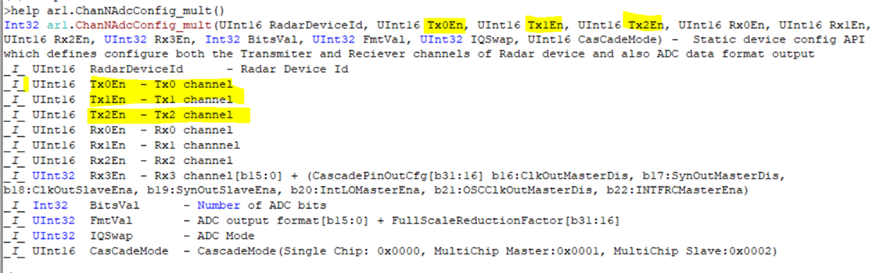

Hi
I use cascade radar device(MMACAS-DSP-EVM+MMWCAS-RF-EVM AWR2243) and mmWave Studio 03.00.00.14.
MMWCAS-RF-EVM AWR2243 has 12Tx antenna and 16Rx antenna.
But,I would like to use MMACAS-DSP-EVM+MMWCAS-RF-EVM AWR2243 under the condition of  1 Tx antenna and 16 Rx antenna.
In this case ,is configuration below written correct?
configuration:
Sequence being followed
A. CONFIGURATION
1. Connecting to TDA
1. Configuring Master from SOP till Channel Config
2. Configuring Slave (i) sequentially from SOP till SPI Connect. i = 1, 2, 3
3. Configuring Slaves together from F/W download till Channel Config
4. Configuring all devices together from LDO Bypass till Frame Config

The sensor configuration consists of 3 sections:
1) Profile Configuration (common to all 4 AWR devices)
2) Chirp Configuration (unique for each AWR device - mainly because TXs to use are
                        different for each chirp)
3) Frame Configuration (common to all 4 AWR devices, except for the trigger mode for the master)
Change the values below as needed. --]]

-- Frame configuration
local start_chirp_tx            =   0
local end_chirp_tx              =   0
local nchirp_loops              =   64     -- Number of chirps per frame
local nframes_master            =   10     -- Number of Frames for Master
local nframes_slave             =   10     -- Number of Frames for Slaves
local Inter_Frame_Interval      =   100    -- ms
local trigger_delay             =   0      -- us
local trig_list                 =   {1,2,2,2} -- 1: Software trigger, 2: Hardware trigger

-- Channel & ADC Configuration
if (0 == ar1.ChanNAdcConfig_mult(1,1,1,1,1,1,1,1,2,1,0,1)) then
    WriteToLog("Master : Channel & ADC Configuration Successful\n", "green")
else
    WriteToLog("Master : Channel & ADC Configuration Failed\n", "red")
    return -2
end
if (0 == ar1.ChanNAdcConfig_mult(deviceMapSlaves,1,1,1,1,1,1,1,2,1,0,2)) then
    WriteToLog("Slaves : Channel & ADC Configuration Successful\n", "green")
else
    WriteToLog("Slaves : Channel & ADC Configuration Failed\n", "red")
    return -2
end
