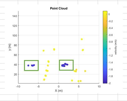

We conducted an experiment:
The car is moving towards the cascaded radar exactly at boresight. And we made sure the car is within max velocity.
Configured cascaded radar as MRR (Chirp configuration: Design Guide: TIDEP-01012).
Some points of the car are showing at (-6m, 40m) instead of showing at (0m, 40m) and I am attaching the point cloud.
Range and Doppler plots look fine. But the DOA calculation is going wrong.
Could you please help us in resolving this issue?

  • Hi Cesar,
    I performed calibration by keeping trihedral at 5m with SRR Configuration and generated calibration  matrix.
    And I tested moving vehicle  towards radar at bore sight in SRR configuration  works perfectly  fine.
    But for when I changed to MRR configuration,  ghost objects are seen.(AoA is going wrong).
    1. Do I need to perform calibration for MRR configuration  also?
    2. Is calibration matrix depends  upon chiropractic configuration ?
    Kishor KS

    When the car is approaching the cascade radar, is the ghost image also approaching at same speed?
    Thank you
    Cesar
  • Hi Cesar,
    Yes. Ghost image is also approaching with the same speed.
    Kishor KS

  • I was able to talk to the design team.
    We would also like to check if the ghost appears in different environments.
    Usually ghosts can be created by multi-path reflections. If this is the case here, the ghost would disappear if you perform the testing in a different environment.
    Thank you
    Cesar
  • Hi Cesar, I will conduct the same experiment in a different environment. When I changed the configuration from SRR to MRR provided in Design Guide: TIDEP-01012. Could you please provide the MRR chirp configuration? Regards, Kishor KS

  • Hi Cesar,
    I performed the same test in the same environment by changing the number of chirp loops from 128 to 64.
    Now I have not seen any ghost objects. Is there any reason?
    Kishor KS
  • If you have not seen ghost reflections in different environment this means that the ghost reflections are caused by the environment.
    Probably multi path reflections.
    Thank you
    Cesar
