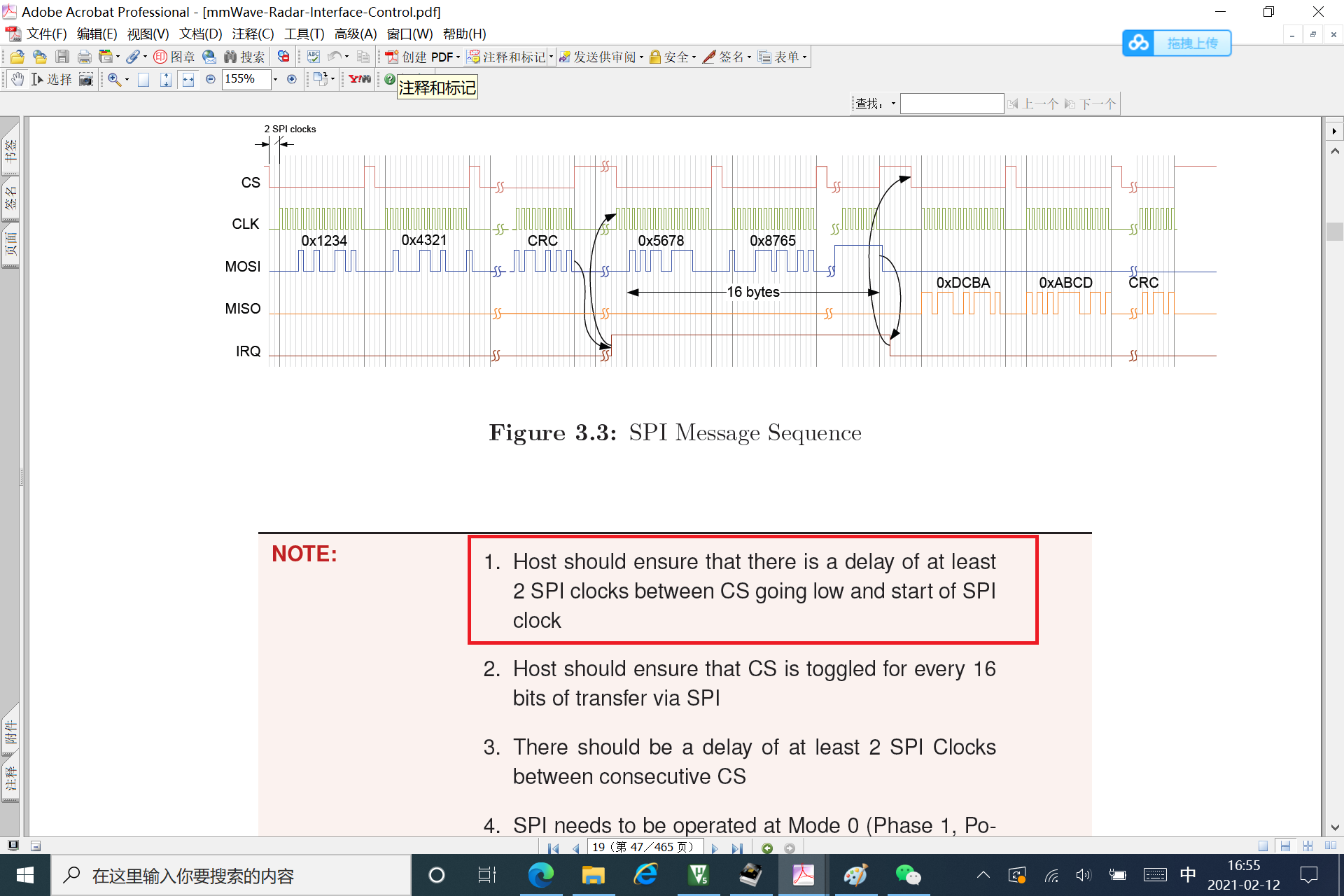

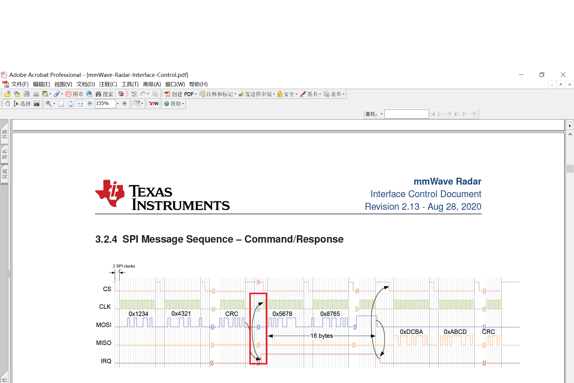

    I have two questions about SPI of AWR2243:
  1. the max speed of SPI supported is 40MHz, 2 SPI clocks means 50ns delay, but if SPI runs 1MHz, 2 SPI clocks means 2us.  Page 21 of mmWave-Radar-Interface-Control.pdf instructions isn clear because SPI run different speed, 2 SPI clocks means different time, delay 1us is enough for SPI delay between CS going low and start of SPI clk is enough?
2. HOST ensure a delay of 30us in response to HOST_IRQ interrupt.-----this means when HOST receive IRQ, HOST should delay 30us, then reset CS to low, then start SPI clk, is it right?

    Please find my reply below:
    >>  1. the max speed of SPI supported is 40MHz, 2 SPI clocks means 50ns delay, but if SPI runs 1MHz, 2 SPI clocks means 2us.  Page 21 of mmWave->>Radar-Interface-Control.pdf instructions isn clear because SPI run different speed, 2 SPI clocks means different time, delay 1us is enough for SPI delay >>between CS going low and start of SPI clk is enough?
    The SPI CS to CLK delay requirement is in terms of clock cycles, hence two clock cycles delay is needed. In case of lower frequency the absolute time would be larger.
    >>2. HOST ensure a delay of 30us in response to HOST_IRQ interrupt.-----this means when HOST receive IRQ, HOST should delay 30us, then >>reset CS to low, then start SPI clk, is it right?
    The 30usec delay is sufficient to maintain between HOST IRQ going high and host sending a SPI clk. CS could be pulled low earlier.
