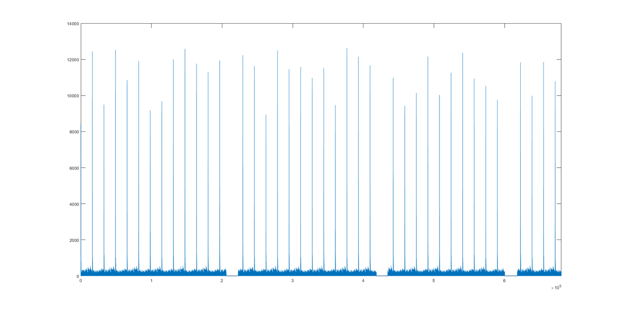

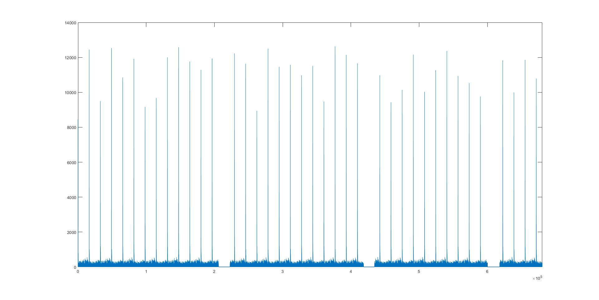

AWR2243BOOST: Raw ADC data missing samples, returning periodic zeros
Part Number: AWR2243BOOST
I am attempting to perform data collection with the AWR2243BOOSt through mmWave Studio, using a Lua script I have modified from one of the included examples. However, when I parse the data using MATLAB, I find that periodic sections of the data are entirely set to zero. I am not sure what the cause of this is, but I have included my output log and a screenshot of what I am experiencing. Let me know if I can provide anything else.
