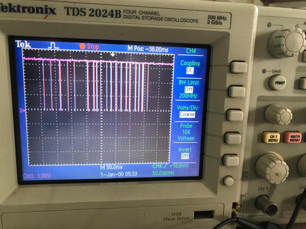

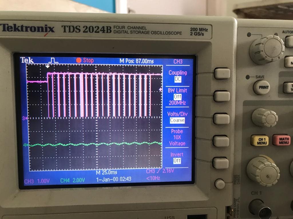

We're working on IWR6843 mmWave sensor board using our own custom board. we monitor all the signals as per our knowledge including the CLK, Power, etc., we are sending commands which we captured on the oscilloscope as well. attached for your review.
Below is the Working Image:
Below is the Not Working Image:
We're not sure which signals should be monitor and what should be their state. So we request you to provide us the list of the signal and their level need to be monitor.

    1. FT4232 + IWR6843 mmWave Sensor (Working Module)
    • In a previous conversation, I have shared the oscilloscope images. first, one is a working image with FT4232.
    • For this working module, we're using a GUI Matlab visualizer to send the config commands and we were able to see the data in the visualizer.
    • while sending config commands over GUI, we checked commands follow and captured oscilloscope image and shared the first image.
    • We observed, commands to commands some dealy is there, sometimes it is high delay and sometimes it is a low delay. is this my observation is right? if yes, how to generate and how much time delay is required to send the commands. In Matlab code didn't mention.

    • Second Image, we observed a working module waveform and this waveform is not the same, initially, this is generating low and sending the commands.
    • one more observation is a delay between the command to command is the same. but still, IWR6843 is not working.

    • On the ESP32 MCU with Wi-Fi + IWR6843 mmWave sensor what  peripheral interface is used, is it different from the FT4232 + IWR6843
    • I don't understand why the scope capture is expected to be  the same?
    • What is the waveform shown on the oscilloscope, is it SPI? UART TX? what is it?
    • When you say not working, what does that mean?
    Can you please provide a more complete picture of the problem?
    Charles O
    • On the ESP32 MCU with Wi-Fi + IWR6843 mmWave sensor UART peripheral interface is used, is it the same as the FT4232 + IWR6843
    • Just we're thinking if the scope captured image is the same, so that we will get the TLV data. as per your assumption, if not the same but I am not getting any output data.
    • The waveform is shown on the oscilloscope is UART Tx, (Config commands)
