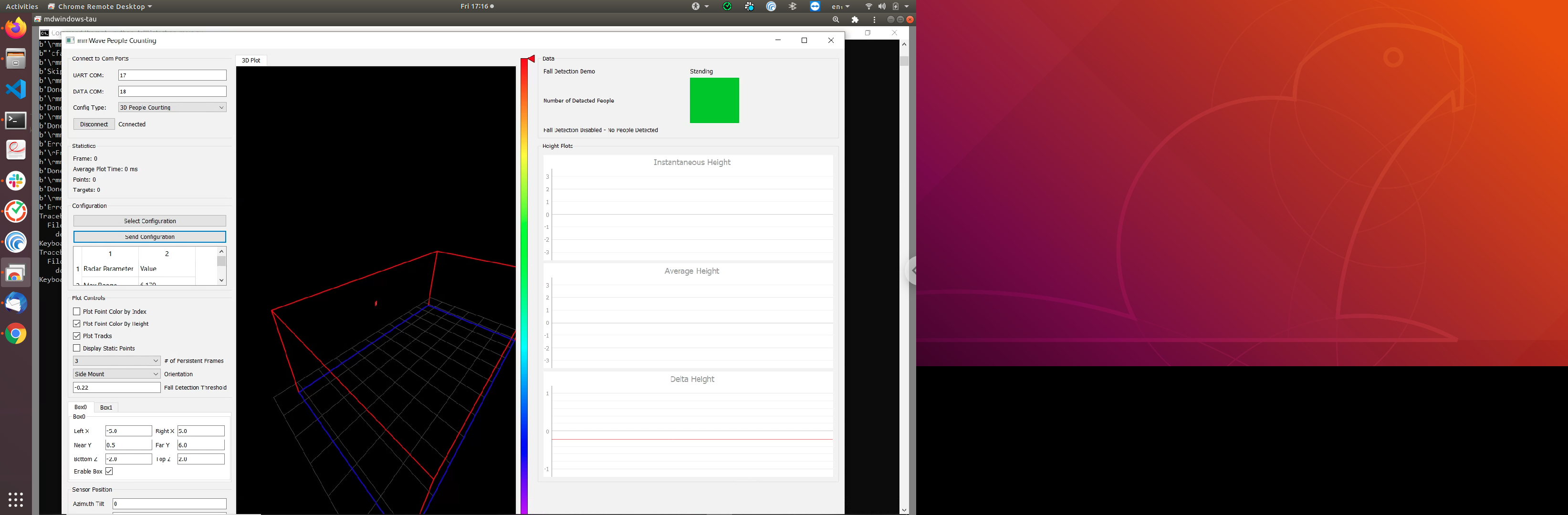

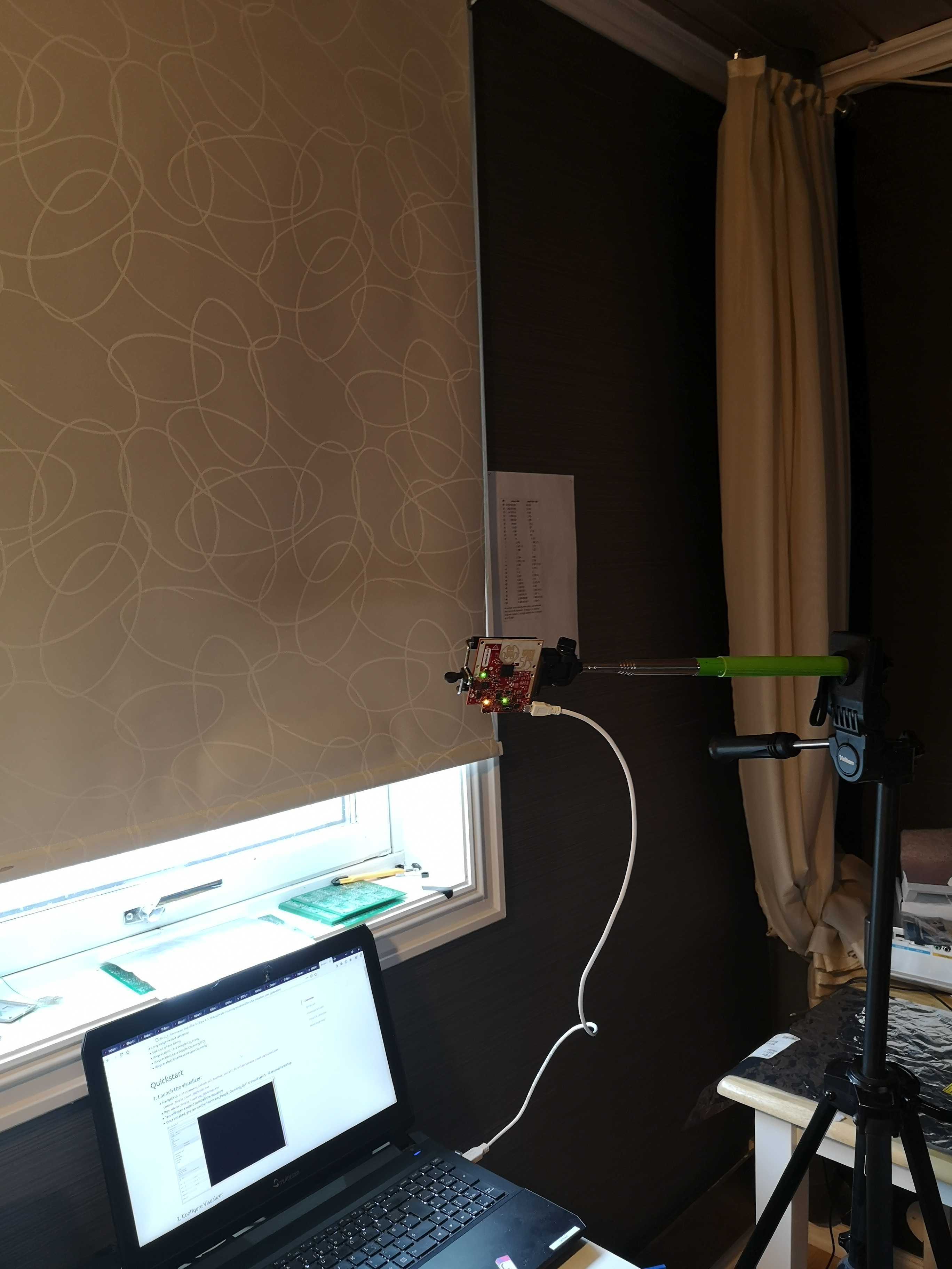

  • Hello Jackson,
    I have tried steps above but did not get any success. I have tried on Windows-10 with python v 3.9 and 3.6. Please find details below
    1. Binary used:-
    3D_people_count_68xx_demo.bin
    2. Chirp config used:-
    visualizer/chirp_configs/Falldetection/LRPD_6m.cfg
    3. EVM :-
    IWR6843ISK-ODS only , mounted on tripod and connected using USB.
    4. setup pic:-
    5. Outputs
    Console log:-
    C:\ti\mmwave_industrial_toolbox_4_5_1\labs\people_counting\visualizer>python fallDetection_main.py
    Python is 64 bit
    Python version: sys.version_info(major=3, minor=9, micro=1, releaselevel='final', serial=0)
    Parser type: 3D People Counting
    Connected
    {'startFreq': 60.0, 'numLoops': 64, 'numTx': 3, 'sensorHeight': 3, 'maxRange': 10, 'az_tilt': 0, 'elev_tilt': 0, 'idle': 35.0, 'adcStart': 6.0, 'rampEnd': 43.0, 'slope': 75.0, 'samples': 125.0, 'sampleRate': 3433.0}
    Setting Box 0 to visible
    Drew both boxes
    Setting box 1 invisisble
    b'sensorStop\n'
    b'Ignored: Sensor is already stopped\n'
    b'\rDone\n'
    b'\rmmwDemo:/>flushCfg\n'
    b'Done\n'
    b'\rmmwDemo:/>dfeDataOutputMode 1\n'
    b'Done\n'
    b'\rmmwDemo:/>channelCfg 15 7 0\n'
    b'Done\n'
    b'\rmmwDemo:/>adcCfg 2 1\n'
    b'Done\n'
    b'\rmmwDemo:/>adcbufCfg -1 0 1 1 1\n'
    b'Done\n'
    b'\rmmwDemo:/>profileCfg 0 60 35 6 43.0 0 0 75 1 125 3433 0 0 48\n'
    b'Done\n'
    b'\rmmwDemo:/>chirpCfg 0 0 0 0 0 0 0 1\n'
    b'Done\n'
    b'\rmmwDemo:/>chirpCfg 1 1 0 0 0 0 0 4\n'
    b'Done\n'
    b'\rmmwDemo:/>chirpCfg 2 2 0 0 0 0 0 2\n'
    b'Done\n'
    b'\rmmwDemo:/>frameCfg 0 2 96 0 100 1 0\n'
    b'Done\n'
    b'\rmmwDemo:/>lowPower 0 0\n'
    b'Done\n'
    b'\rmmwDemo:/>guiMonitor -1 1 0 0 0 0 0\n'
    b"'guiMonitor' is not recognized as a CLI command\n"
    b'\rmmwDemo:/>cfarCfg -1 0 2 8 4 3 0 15 0\n'
    b"'cfarCfg' is not recognized as a CLI command\n"
    b'\rmmwDemo:/>cfarCfg -1 1 0 4 2 3 1 15 0\n'
    b'\rmmwDemo:/>multiObjBeamForming -1 1 0.5\n'
    b"'multiObjBeamForming' is not recognized as a CLI command\n"
    b'\rmmwDemo:/>clutterRemoval -1 1\n'
    b"'clutterRemoval' is not recognized as a CLI command\n"
    b'\rmmwDemo:/>calibDcRangeSig -1 0 -5 8 256\n'
    b"'calibDcRangeSig' is not recognized as a CLI command\n"
    b'\rmmwDemo:/>extendedMaxVelocity -1 0\n'
    b"'extendedMaxVelocity' is not recognized as a CLI command\n"
    b'\rmmwDemo:/>bpmCfg -1 0 0 1\n'
    b"'bpmCfg' is not recognized as a CLI command\n"
    b'\rmmwDemo:/>lvdsStreamCfg -1 0 0 0\n'
    b"'lvdsStreamCfg' is not recognized as a CLI command\n"
    b'\rmmwDemo:/>compRangeBiasAndRxChanPhase 0.0 1 0 1 0 1 0 1 0 1 0 1 0 1 0 1 0 1 0 1 0 1 0 1 0\n'
    b'Done\n'
    b'\rmmwDemo:/>measureRangeBiasAndRxChanPhase 0 1.5 0.2\n'
    b"'measureRangeBiasAndRxChanPhase' is not recognized as a CLI command\n"
    b'\rmmwDemo:/>CQRxSatMonitor 0 3 4 63 0\n'
    b"'CQRxSatMonitor' is not recognized as a CLI command\n"
    b'\rmmwDemo:/>CQSigImgMonitor 0 127 4\n'
    b"'CQSigImgMonitor' is not recognized as a CLI command\n"
    b'\rmmwDemo:/>analogMonitor 0 0\n'
    b"'analogMonitor' is not recognized as a CLI command\n"
    b'\rmmwDemo:/>aoaFovCfg -1 -90 90 -90 90\n'
    b"'aoaFovCfg' is not recognized as a CLI command\n"
    b'\rmmwDemo:/>cfarFovCfg -1 0 0 59.99\n'
    b"'cfarFovCfg' is not recognized as a CLI command\n"
    b'\rmmwDemo:/>cfarFovCfg -1 1 -30 30.00\n'
    b'\rmmwDemo:/>%SceneryParam -50 50 0.5 60 -6 6\n'
    b'Skipped\n'
    b'\rmmwDemo:/>staticBoundaryBox -5 5 0.5 6 -2 2\n'
    b'Done\n'
    b'\rmmwDemo:/>boundaryBox -5 5 0.5 6 -2 2\n'
    b'Done\n'
    b'\rmmwDemo:/>gatingParam 3 2 2 2 20\n'
    b'Done\n'
    b'\rmmwDemo:/>stateParam 4 10 60 600 20\n'
    b'Error: Invalid usage of the CLI command\n'
    b'\rError -1\n'
    b'\rmmwDemo:/>allocationParam 300 300 0.5 30 1 20\n'
    b'Done\n'
    b'\rmmwDemo:/>maxAcceleration 0.1 0.1 0.1\n'
    b'Done\n'
    b'\rmmwDemo:/>trackingCfg 1 2 250 20 78 121 99 90\n'
    Please let me know if iam doing anything wrong.
    vibhav
  • Hi Vibhav,
    If you are using the people_counting binary, please use the CFG file tuned for the ODS board in the 3D people counting folder. I know the instructions say LRPD cfg but that is not compatible with all boards and binary files.
    "C:\ti\mmwave_industrial_toolbox_4_5_1\labs\people_counting\visualizer\chirp_configs\3D_People_Counting\ODS_6m_default.cfg"
    Jackson
