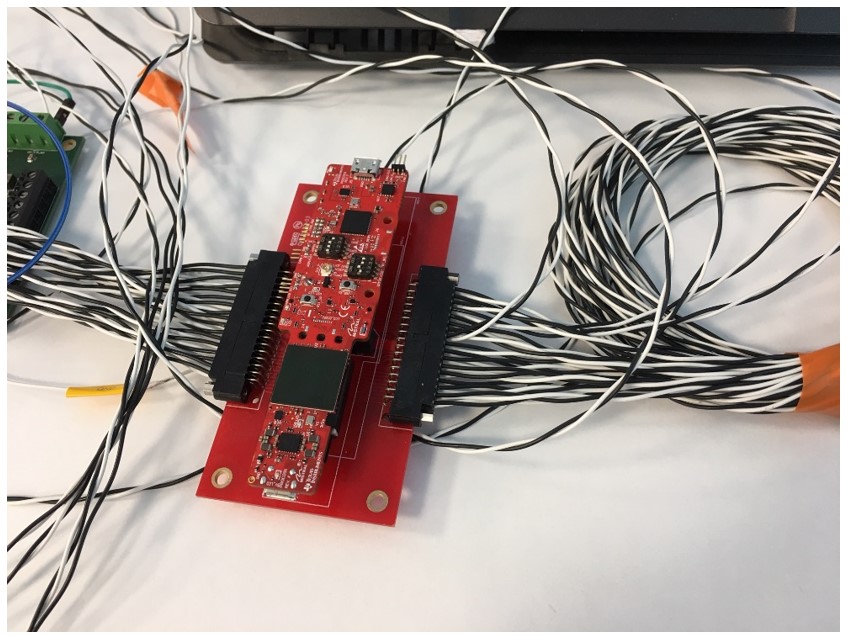

We are carrying all pins of IWR6843AOPEVM with its MPI-60pin hd connector. In this way, we can access all 60 pins of iwr6843aopevm board. And we can configure the board with UART over this connector. And we can read data from MSS_Logger pin.
We configure the board with SOP pins for flash mode, but we cannot program the flash. By the way, when we are working with setup, all pins that we are not using are floating.
If we program the IWR6843AOPEVM with onboard USB, we can configure and read data over 60 pin connector. And we are configure IWR6843AOPEVM as boost mode (like programming with MMWAVEICBOOST) to access the IWR6843AOPEVM over 60 pin connector. But we cannot program the flash over our connector setup.

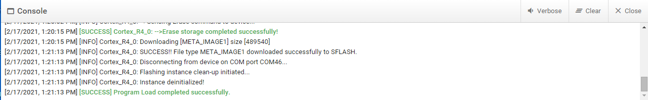

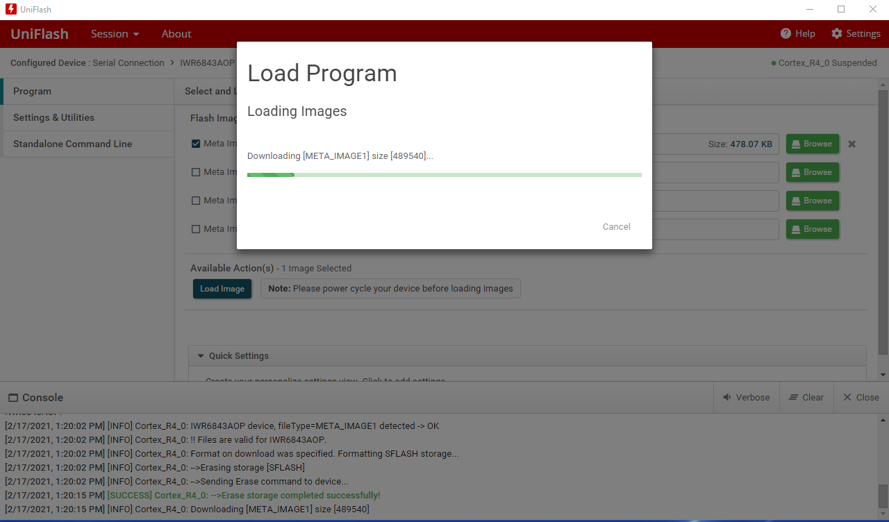

We are using uniflash for programming. And we use TI web based “High Accuracy Visualizer” tool to config and see receive data as visual.
There are screenshots from uniflash and High Accuracy Visualizer tool.
How can we write the program to flash of the IWR6843AOPEVM over its 60pin connector without MMWAVEICBOOST Which step do u think we are skipping?

    If the EVM is working in standalone mode and with MMWAVEICBOOST then your setup, at a glance, should work with the steps in my previous post.
    1. I looked back at the image you share and first of all the cables attached to the adapter board appears to be really long, at higher speed this could affect signal integrity.
    2. Secondly, you need to confirm that he UART to USB transceiver you are using actually works with uniflash and the visualizer. Have you successfully used this to program and run demos in the past?
    3. When using the adapter how is the board powered?
    4. Can you configure the SOP pin on the AOP EVM and power using onboard USB. Instead of having all the 60 pin connected to the cables. route only the ground, UART RX, UART TX, and mss_logger to the the USB to UART.
    Can you please provide any additional details that you think is applicable?
    Charles O

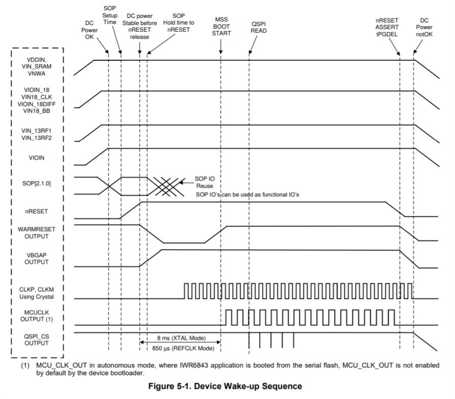

        Device wakeup procedure we need to follow as shown in the below timing specified in the datasheet.
    Few points to emphasize here are:
    1) Power supply need to be applied and stable
    2) SOP boot mode assertion need to happen before the NReset release : This captures should the device be in Functional mode or fleshing mode.
    3) Then device would be ready for appropriate mode. If it's flashing mode, then device would expect flash image on RS232  TX/RX pins which are connected to  USB to UART port.

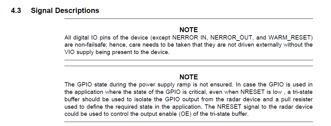

    While Device is connected to USB to UART port, Care need to be taken non-fail safe I/Os such as RS232 Tx/Rx signal should not be driven when the VIO supply is not present.
    Hence, it recommended all the external connection to mmWave IC should be disconnected when the VIO supply is not present. Power up the device with right boot configuration, and then connect external interfaces such as USB to UART ports.
