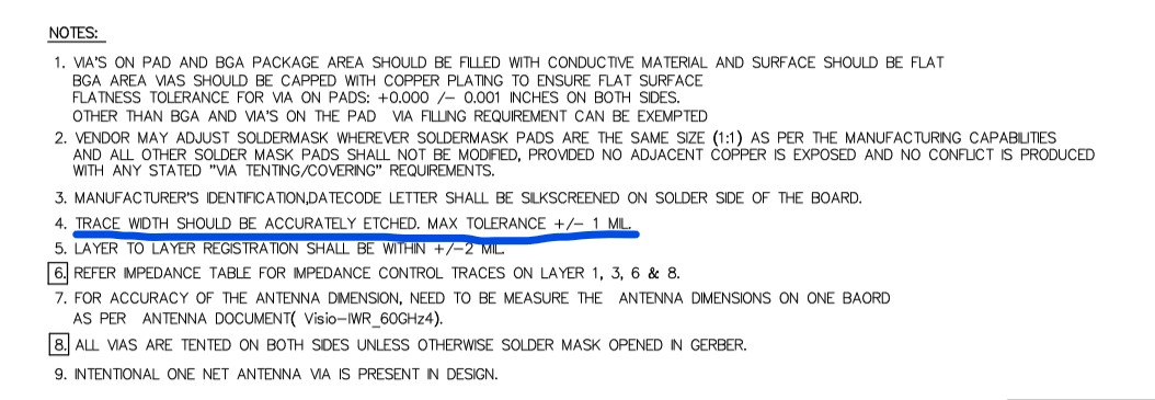

Our customer's sensor has different behavior of detection on its left and right side. (Test by mmwave out of box demo)
The precision of  one side seems to be poorer than the other side. And the precision of both sides are worse than TI EVB.
They use  IWR6843 and the same antenna design as TI EVB.
How to solve this problem by software? (Not changing CFAR or cfg)
Can calibration help? If yes, how to do software calibration?
