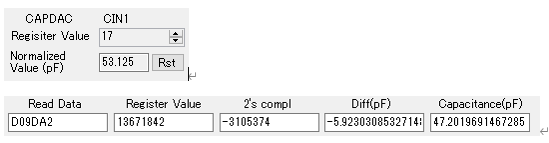

    Thank you for your reply. Please refer below.
    1. What is the equation to get the parameter Diff(pF)?
    Coffset:(CAPDAC register setting)16(=b10000) * (resolution)3.125pF = 50.00pF
    Diff(pF):(Actual measurement capacitance)50.9522....pF - (Coffset) 50pF ≠ 0.9522.....pF
    Coffset:(CAPDAC register setting)17(=b10001) * (resolution)3.125pF = (CAPDAC) 53.125pF
    Diff(pF):(Actual measurement capacitance)47.2019....pF - (Coffset) 53.125pF ≠ -5.9230.....pF

    0x08 CONF_MEAS1 = 0x1200(CAPDAC 16) or 0x1220(CAPDAC 17)
    I also have EVM and the behavior of the time of CAPDAC 16 and 17 against the measurement target around 50pF is same. I used my own developing system to report this issue at first because EVM and software is sometimes buggy.

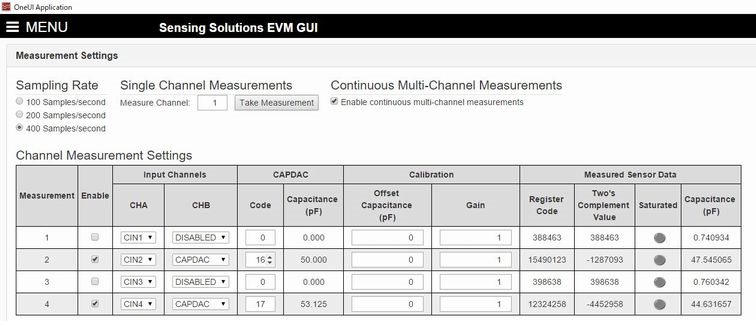

  • John,

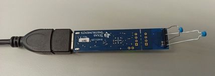

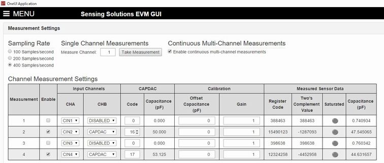

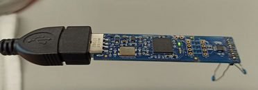

    I tried both cases as you can see the pictures in my latest posts. My PCB is driven by my GUI (thru serial communication from Windows to μC, I2C from μC to FDC). EVM is also driven by Sensing Solution EVM GUI. I don't know the transmission architecture of EVM so I don't connect EVM GUI and my PCB so there is no affection to EVM if I am failing developing my design. I connected fixed or trimmable capacitor to CIN instead of electrode for both environment.
    47pF capacitors for CIN2 and CIN4.
    Confirming difference by CAPDAC. EVM GUI is unstable.

  • Keigo,

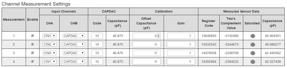

    I modified an EVM by adding 47pF caps from C1 - C4 to ground.
    Then I tried stepping the CAPDAC values from 14 to 17 for all four of the channels. The measured capacitance was close for all four capacitors, and the measured values did show much variation over the CAPDAC changes. See the images below.
    When I tried changing the CAPDAC values across the four channels in a single measurement, the results changed, especially for C2, with a CAPDAC code of 15 (46.875pF).
    So it looks like if the CAPDAC values are the same across the four channels, the results are consistent, but if they vary across the four channels, the results start to vary.
    This seems to be consistent with what you have found. I will investigate this further and will re-open & update the thread when there are results to share.

  • Keigo,
    I spoke with other members of our team about our findings on the FDC1004.
    A single CAPDAC setting applies to all of the channels in the FDC1004.
    There is no dedicated CAPDAC setting for each channel, the single setting is applied across all four channels for non-differential measurements.
    Our Sensing GUI does not make this clear.
    It seems to allow a user to make a distinct CAPDAC setting for each channel, but it is really changing the single CAPDAC setting as it multiplexes between the channels. From what we saw in our experiments, this GUI approach seems to be a little unreliable.
    I hope this helps. Please let me know if you have any more questions.

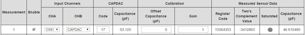

  • John,
    This problem that I confirmed was happened not only at the time of using FDC1004 by single channel but also not on the EVM GUI at first.
    I am concerning to use only one channel for my latest development. Sure I posted the picture of multiple channels measurement on 12th article, but that was intended to make this phenomenon easier to understand. The pictures on the 3rd post of this article is showing only CIN1, but the CAPDAC of other channels were "DISABLED" in the out of pictures at this case.
    I measured and captured the pictures again but I could not find the way of upload. Didn't find this phenomenon on your environment? Please try CAPDAC settings 16~18 for one Ch for one target of capacitance.
    I need to know the certain characteristics of CAPDAC to avoid or to compensate this big error. It is good if there's a way of prevent. Small errors by every steps are acceptable but these big errors are seemed to happen on the restricted steps/capacitance area. I mean characteristics are regarding this problem. Certain settings of CAPDAC steps to happen, margin of error, there are individual difference for every chip or not, and/or so. Is it impossible?

  • Keigo,
    Using the TI/Sensing EVM GUI, I tried varying the CAPDAC code from 10 to 20 for channels 1 & 2 in separate measurements, and noting the reported capacitance.
    Both channels have 47pF caps in place of the EVM sensor.
    The data:
    CAPDAC Code CAPDAC Capacitance (pF) CIN1 (pF) CIN2 (pF)
    10 31.25 40.45 42.22
    11 34.375 40.52 42.29
    12 37.5 40.51 42.28
    13 40.625 40.57 42.34
    14 43.75 40.7 42.45
    15 46.875 40.67 42.43
    16 50 40.63 42.38
    17 53.125 40.75 42.51
    18 56.25 40.25 41.93
    19 59.375 43.375 43.375
    20 62.5 46.5 46.5
    When doing the measurements, I noticed for CAPDAC codes from 10-18, CIN1 and CIN2 varied slightly over time.
    For CAPDAC codes 19 & 20, CIN1 and CIN2 did not vary at all over time, and their values increased compared to CAPDAC settings 10-18.
    If we can believe the estimated values for CIN1 and CIN2 for CAPDAC = 10, then for for CAPDAC >18, the difference between the CAPDAC capacitance and the actual (sensor) capacitance is > 15pF.
    The FDC1004 has a range of ±15pF, so it is likely the sudden jump in CIN1/CIN2 capacitance (for CAPDAC > 18pF) is because the attempted measurement exceeds the range of the device.
    That may be what you are seeing.
