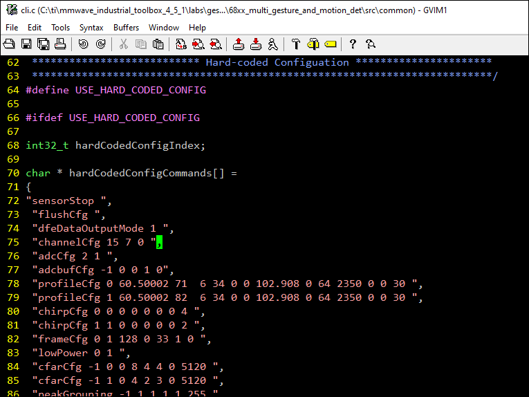

    1. You can open CLI using a terminal program as usual even if the program is running through CCS. The USB port provides JTAG and UART and both work simultaneously so the CLI terminal can be opened as usual.
    2. However, for the gesture demo, you do not need to open the CLI port and the target configuration is hard-coded in this demo and applied automatically at start-up. It is done in this function so you can put breakpoints in this function if you want to see how the config is sent without opening a terminal.

  • Hi Nitin,
    Thank you for your reply, yes I found that hardcoded config and just use that for now.
