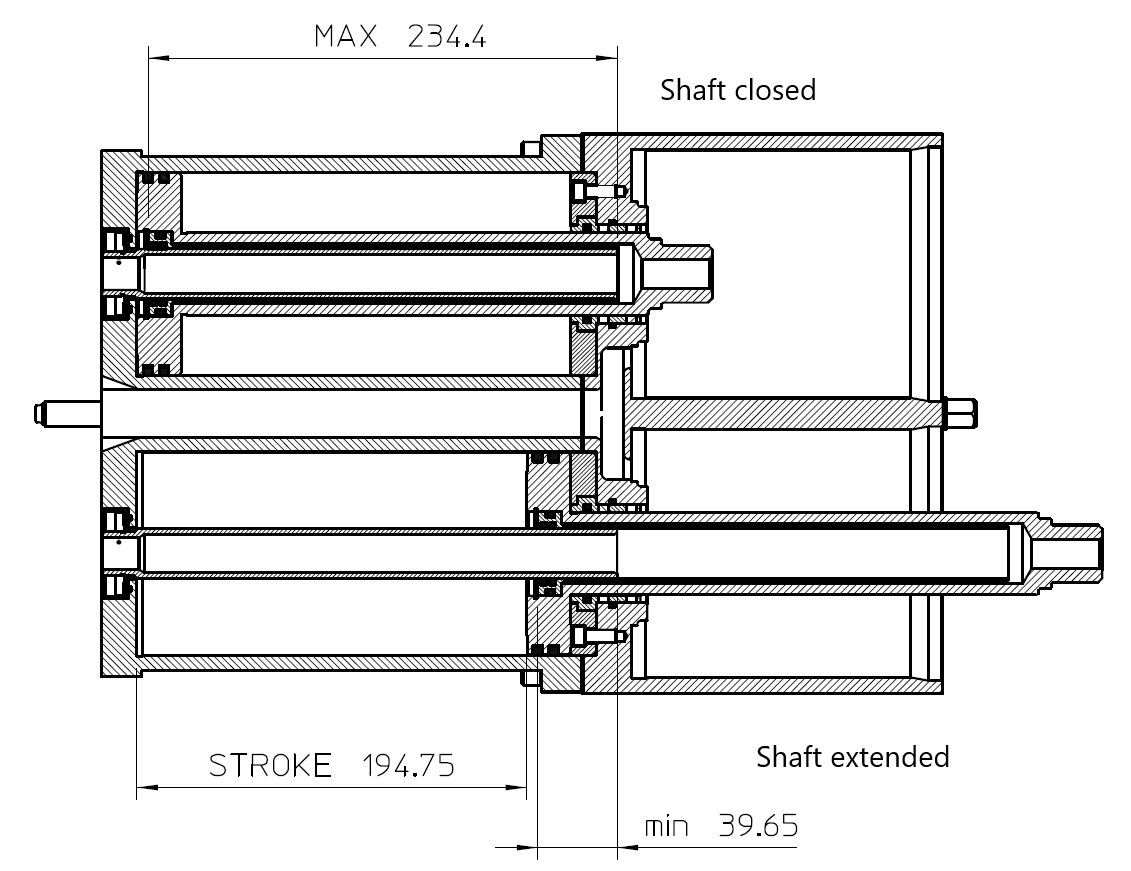

I need to implement a linerar position sensor to measure a displacement of 195 mm on a run of 235 mm.
The inductive part would be a solenoid on which a cylindrical tube slides.
I red that LDC1612 has a limitation of 10 cm.
As it cannot be used on a stroke of 195mm, I wonder if using the two channels of the module, it would be possible to detect the position with a resolution of 50 um, dividing the measuring range in two or alternatively using a LDC1614 in 4 parts?
There may be problems with mutual magnetic coupling?
Could there be dead bands between one solenoid and the next?
You have already done tests of this type?
