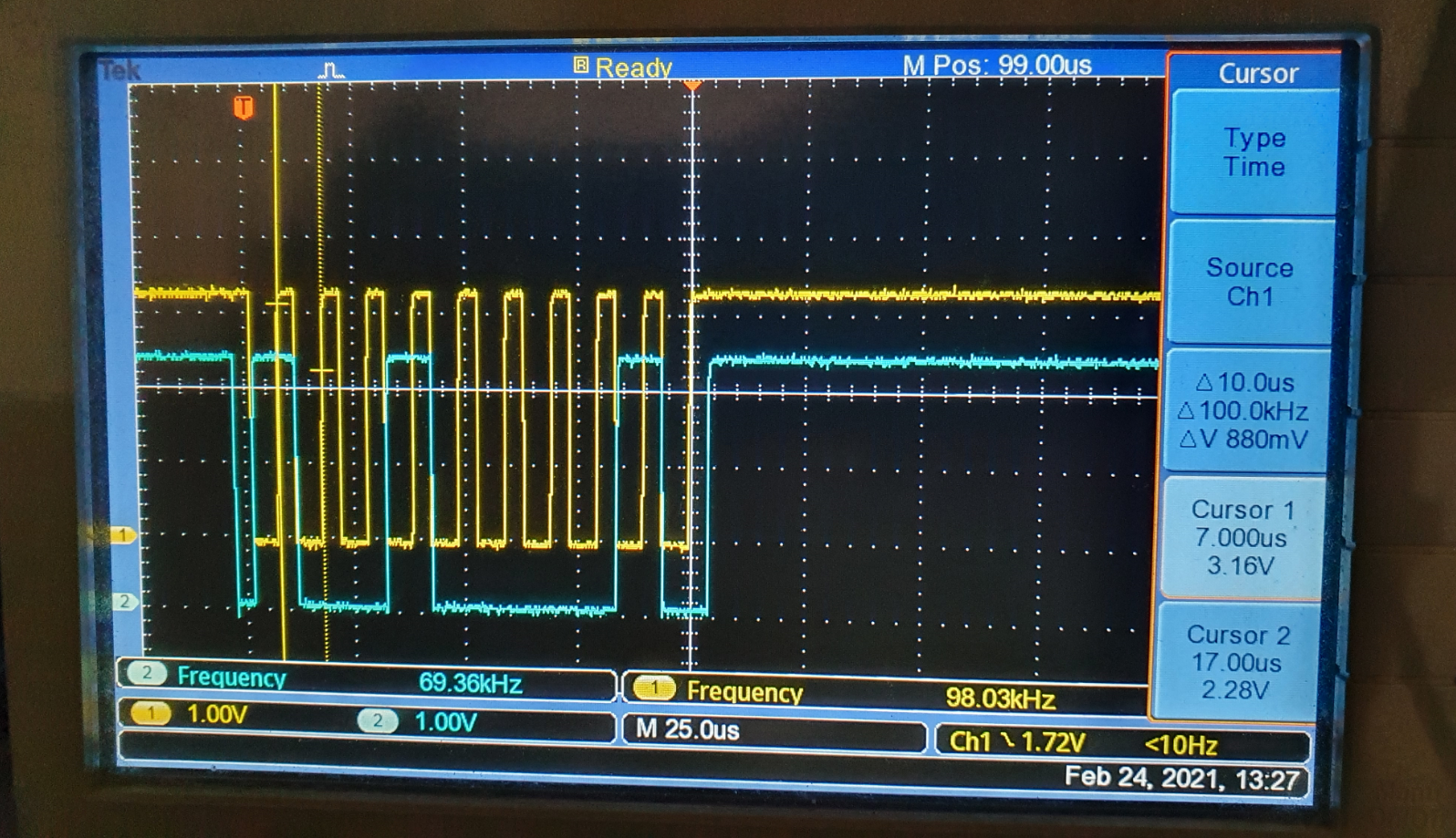

I have a TMP1075 connected to a uC on standard I2C. The A0 - A2 pins are all grounded. I am trying to access it via address 0x90 (SLA + R/W) but I am not able to establish communication with the sensor.
I2C speed is 100kHz and the waveforms look okay and match with those in the datasheet except for ACK.
Am I missing something here? Request your assistance.

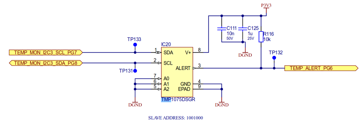

    In this case, we would need to see (to confirm) the oscilloscope or logic analyzer capture of the I2C traffic to comment further. If you have schematic to share, that would also be appreciated.
  • Josh,
    Thank you for your reply.
    I have attached the picture of the initial I2C signal and a snippet from the schematic for your inspection.

    1. In the schematic, the P3v3 line provides power to the TMP1075. Is this line active with 3v3 while I2C communication is being attempted ?

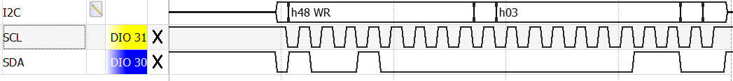

    The timing on your oscilloscope capture looks fine. Here is a reference for a good waveform:

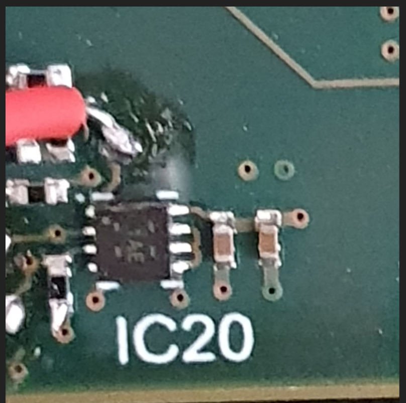

    I have got about 7 boards the sensor has been mounted on.
    To answer your questions, I could check the 3v3 flowing to the pad and that looks okay on all the boards. Checked the comms on all the boards and all seem to have the same issue.
    Soldering looks okay to me, here's a picture attached if your are able to find anything, I apologize though; it is a bit unclear for the package.
    Thank you!
    Makarand
  • Makarand -
    Thanks - is it possible to take a more focused picture? From what it looks like from what I can see, it appears this circuit has been touched up manually, and may have cold or open solder joints - a clearer image would help double check that. Did you already Ohm out all the connections, to the top of the parts to ensure the connection through the pads and solder fillets, including the passive parts?

    I agree that I have made some additional connections on to this particular circuit (probing the I2C signals) which is why you can see some manual rework.
    However, I am observing the same behavior on 5 other cards. All have been machine assembled and reflowed as we have got other fine pitch parts on the board as well.
    I will still try to get a better picture for you and the ohm values as well.

  • Makarand-
    no connection would be a great reason - please check it and send over another image, if possible - thanks!
