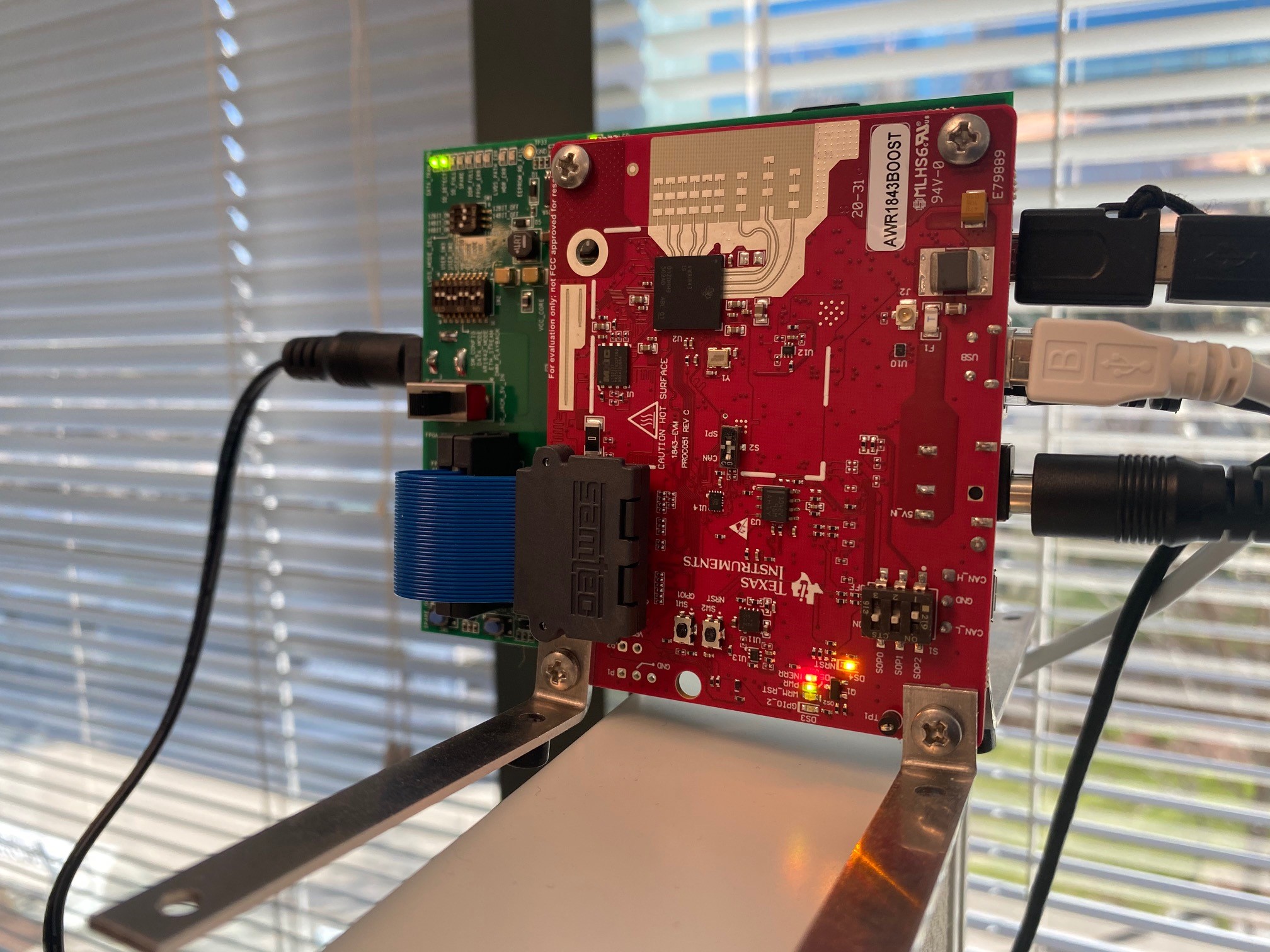

    I am finally able to capture the binary file but not consistently. The issues I'm running into are:
    1- I get the message "No LVDS data" about 1/3 of the time when I issue trigger frame command. The system is unresponsive for a while and then it comes back.
    2- Changing packet delay time in the RF capture card does not seem to take effect. It always reads back 25us.
    3- Red LED on RF card is on most of the time. Sometimes it turns off after FW download and SPI connect, but it's on most of the time.
    Here is a picture of the setup.
    Thanks for your help.
    Saied
  • Saied,
    I would suggest changing out the USB cable that you have connected to the DCA1000EVM. Try to use a micro-USB cable and not one that doubles as both a mini-USB and micro-USB.
