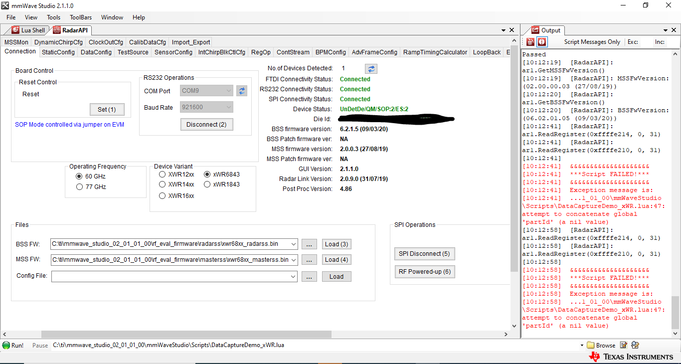

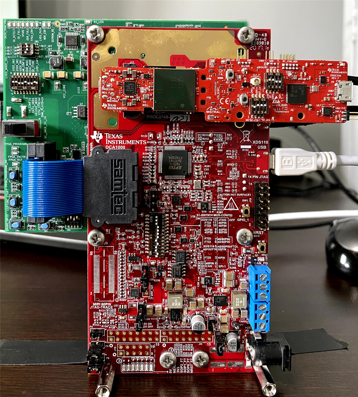

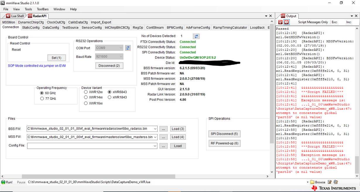

Hi, I have  a setup of IWR6843 AoP EVM + MMWAVEICBOOST + DCA1000EVM connected together.
USB ports are connected properly from MMWAVEICBOOST, it has 5V external power as well. Status is connected.
when I start the capture script, DataCaptureDemo_xWR.lua, it has the error above, how to check it?
Thank you.

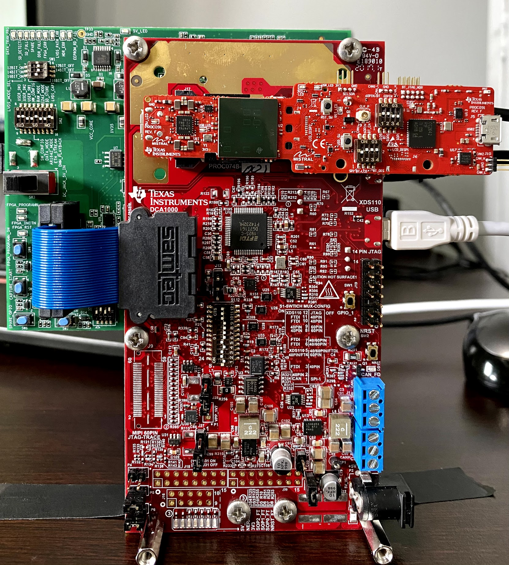

  • Hello
    Can you please highlight after which step # in the instructions you notice this error
    And
    Please provide the version of the EVM you are using (or a picture)
    Thank you,
    Vaibhav
  • I am using IWR6843AOP EVM
    Is it supported by mmWave studio?
  • I follow the training video already here:https://training.ti.com/dca1000-training-video
    Then I open the DCA1000EVM Quick Start Guide to load DataCapturedemo_xWR.lua after everything is connected. But pressing "Run" I saw the issue above.

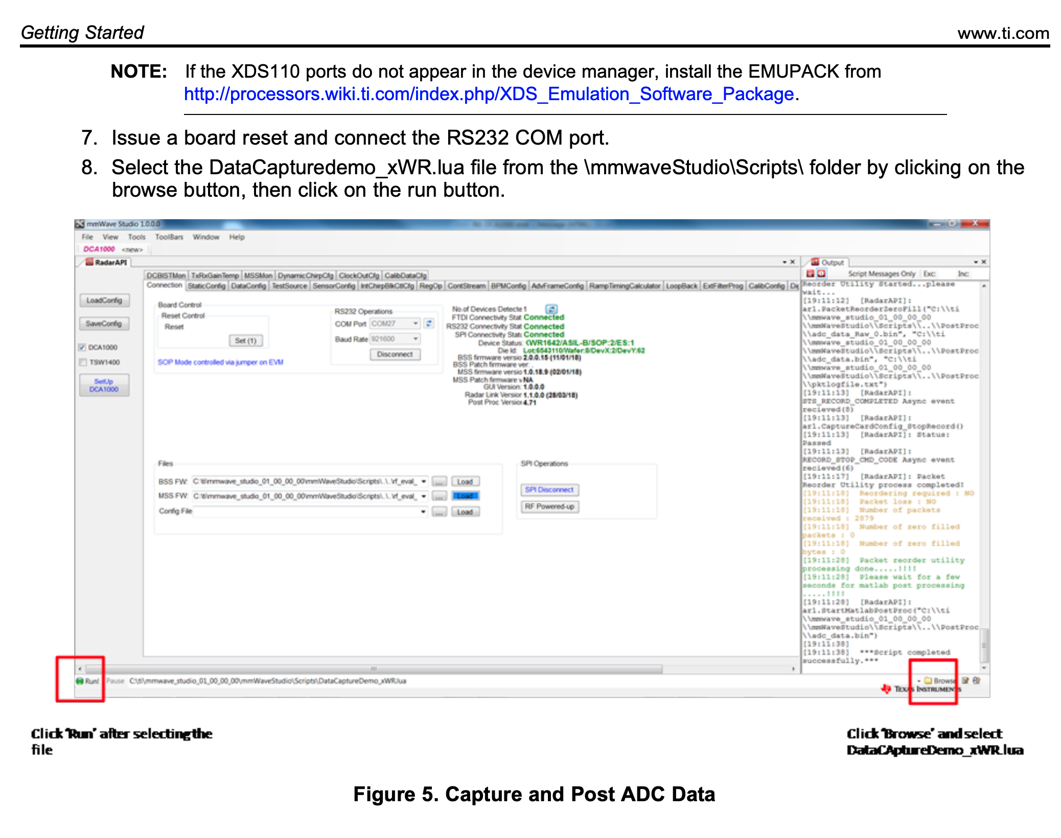

  • HI, there:
    Please follow the step-by-step procedure listed here, and let me know which step you fail.
    6327.mmWave_sensor_raw_data_capture_using_DCA1000_xwr6843.pdf
    Zigang
  • Hi Zigang, thank so much for your reply! I will check and let you know the result
  • Thank you so much, it is working perfectly right now, it's all about the order we start capturing, this document must be attached to DCA1000EVM download page!
  • Great to hear that.  You are right, I should upload this document somewhere.  I am still looking where is the best place to upload it.
