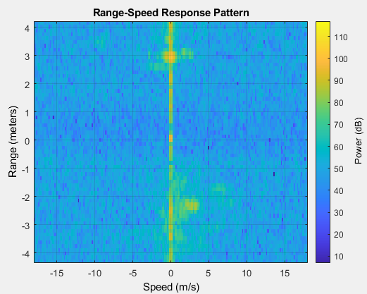

I am using AWR1843 boost along with DCA1000 for capturing ADC data.After data capturing, i am doing data parsing and plotting range Doppler plot in Matlab.My code is also attached.However, i am getting negative ranges in my plot as shown in attached figure(it should be from 0 to 8.75m according to my chirp parameters.However,targets after 4m are flipped and shown at negative ranges)?Can you kindly explain what is wrong with my data that i am getting negative ranges?Is there anything wrong with my data parsing ?The range Doppler plot which i am getting after post processing in mmWave studio is alright.

B = reshape(retVal1,[numRX,numADCSamples,chirps_per_frame,No_of_frames]);
%plotting range doppler
 rngdop = phased.RangeDopplerResponse('PropagationSpeed',c,...
    'DopplerOutput','Speed','OperatingFrequency',fc,'SampleRate',fs,...
    'RangeMethod','FFT','PRFSource','Property',...
    'RangeWindow','Hann','PRF',1/tm,...
    'SweepSlope',ss,...
    'RangeFFTLengthSource','Property','RangeFFTLength',numADCSamples,...
    'DopplerFFTLengthSource','Property','DopplerFFTLength',chirps_per_frame,...
    'DopplerWindow','Hann');
[resp1,r,sp] = rngdop(squeeze(B(2,:,:,FrameNo)));
figure(1)
plotResponse(rngdop,squeeze(B(2,:,:,FrameNo)));
