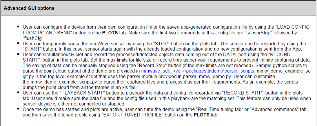

  • Hi Harish,
    Thanks for the information. So I understand that the demo is working fine for you. The demo visualizer provides a way to save the point cloud data and play it back in the visualizer. Additionally, the SDK also includes a python script to parse the data and save in into an xls file.
    Please refer to the following section in the SDK user guide:
    -Nitin

  • Harish,
    The demo already sends this information in the UART output continuously which is what the visualizer parses in real time and displays on the plots. If you want to read this information in your application, you can replicate the parsing function using the mmWaveDemoVisualizer source code as reference as described in the following thread. Or use the python code provided earlier and modify it to parse the output in real time.
    https://e2e.ti.com/support/sensors/f/1023/p/877608/3247117#3247117
    -Nitin
