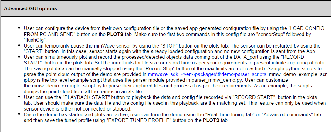

I refer to mmWave Visualizer software documentation as below: www.ti.com/.../swru529c.pdf
And I can only find this info:
My questions are:
1. What kind of data format that RECORD button saves? Is there any parsing script available somewhere?
2. How to capture the ADC data from IWR6843AOP EVM? I have DCA1000EVM and MMWAVEICBOOST, trying to ask in other thread but no response yet. So capturing the data from mmWave Visualizer is an alternative way?
