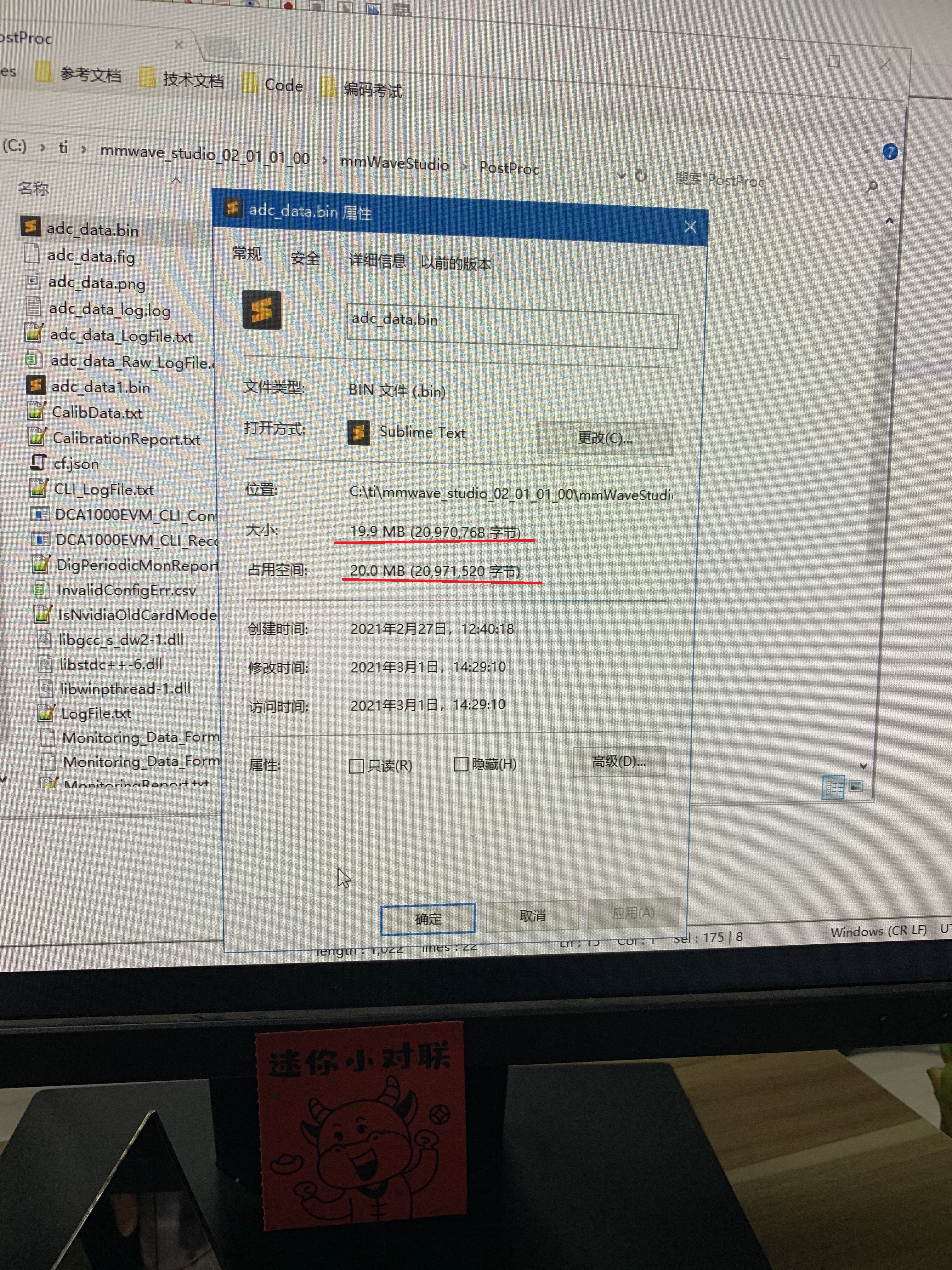

    I can connect to DCA1000 and the AWR device properly through mmWave studio and capture raw ADC data.However when i set the No of Frames bigger than 1,the real data will always smaller.See as follow picture:
    The configuration is common configuration.I take my dca1000 and awr1843 to my colleague's computer,the result is ok.

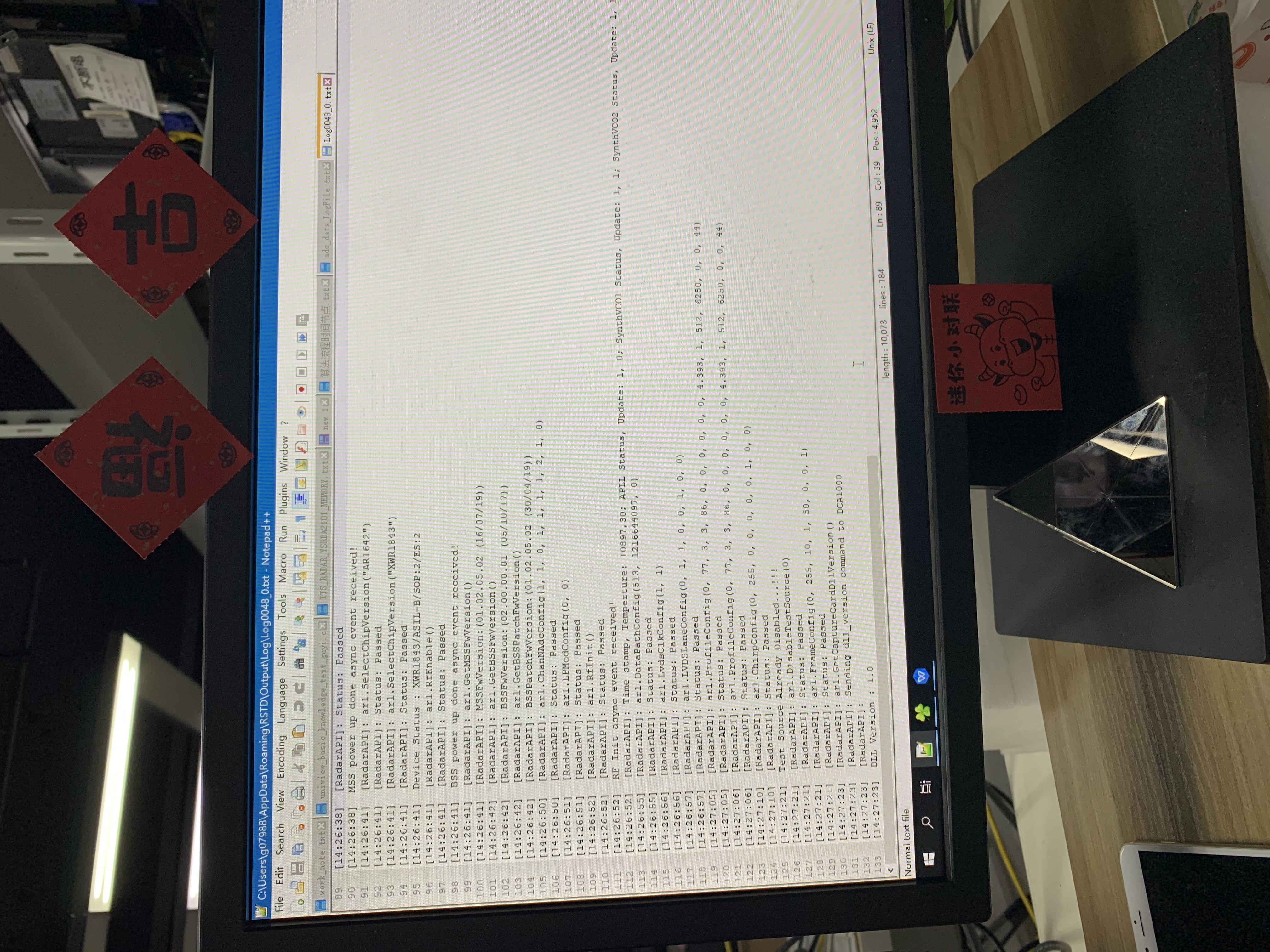

    The log file our company can not send by net,so i take picture for you,as follow:

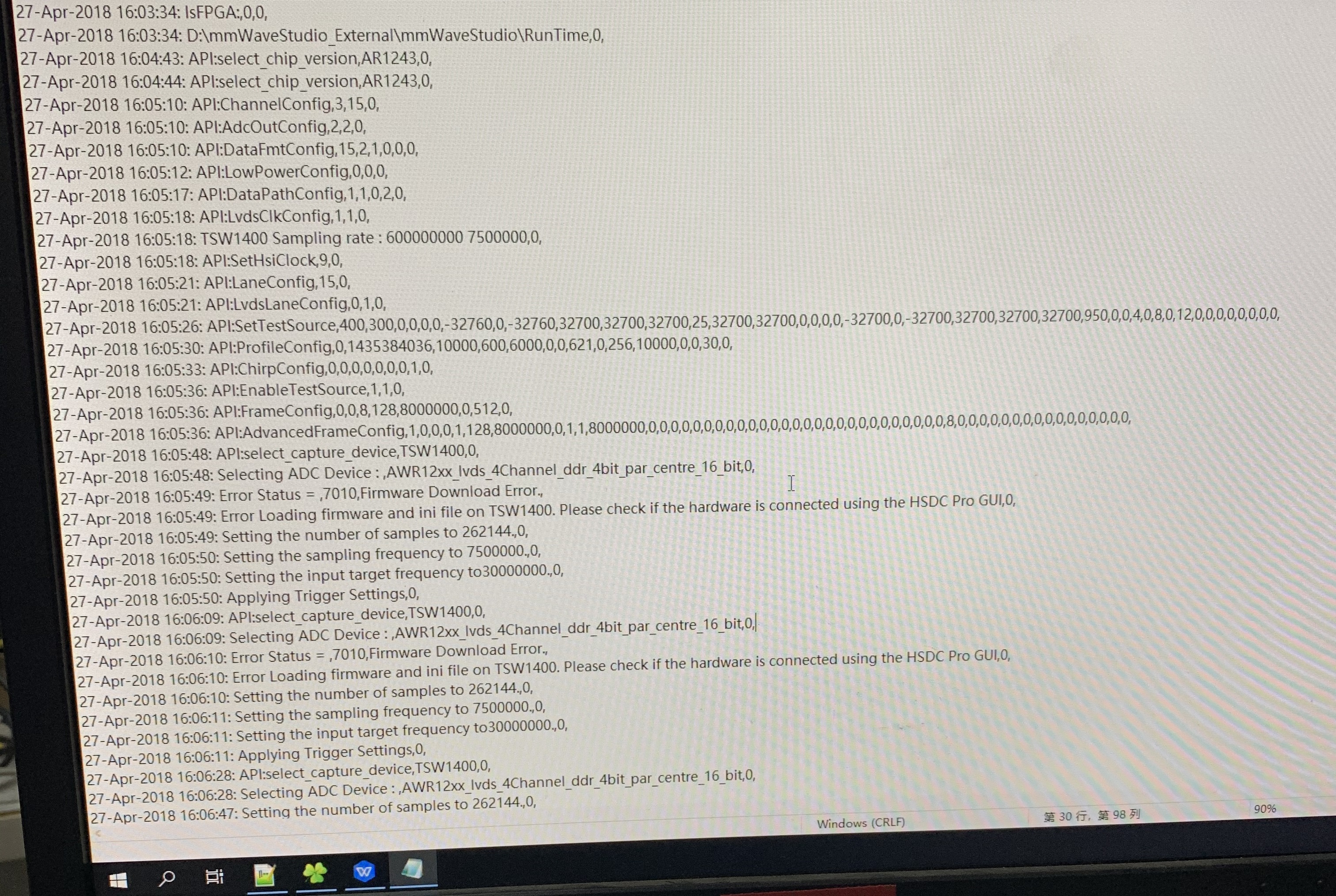

  • Hello Bryant,
    Why is there a repeated mention of TSW1400 and not DCA in your log if you're using DCA1000 for data capture? Where are you setting up the DCA1000 device here? Could you send you log as shown in the below format? Click "Show log file" by right clicking on the output window of studio.
    Also,
    If the data capture happens successfully on a different PC, then I'm afraid this is a limitation from your PC's side.

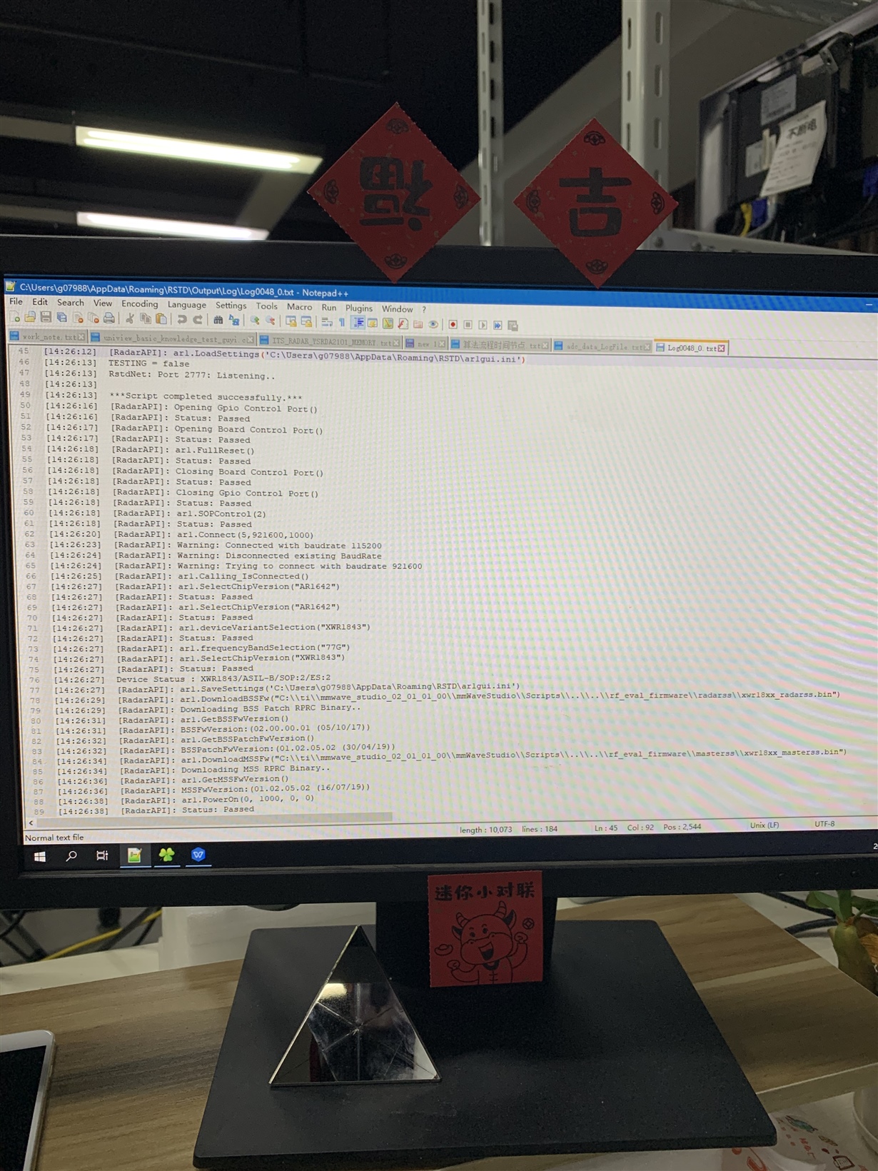

  • Hello Ishita,
    I am sorry,log file i send to before is wrong.Accroding to your hints see as follow:
    Bryant
  • Hello Bryant,
    Your log looks good, there is no configuration or capture error. According to your configuration, you should be capturing exactly 20MB of raw ADC data.
