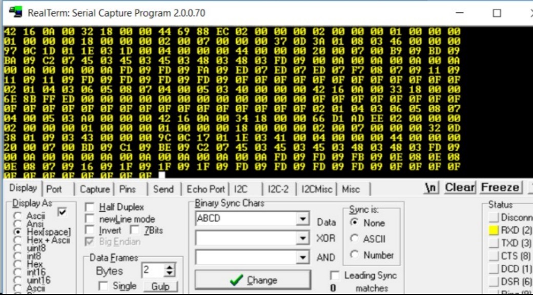

Now I want to make sense of this data with c#.

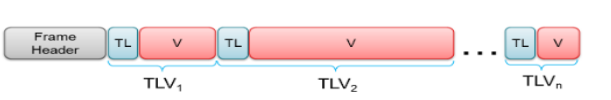

I read the User's Guide
I know the data structure is like this but I don't know what the Frame Header is in the data I received as above.
This is the data I receive.
    I had answered a similar question recently:
    This includes details of the output data format and contains a sample parsed file to act as an example.
    Aayush

    That would be in the TLV type 1 in the json file for each message with detected points. Since getting this specific information is out of the scope of the TLV parser tool, you would have to write the necessary script for this.
