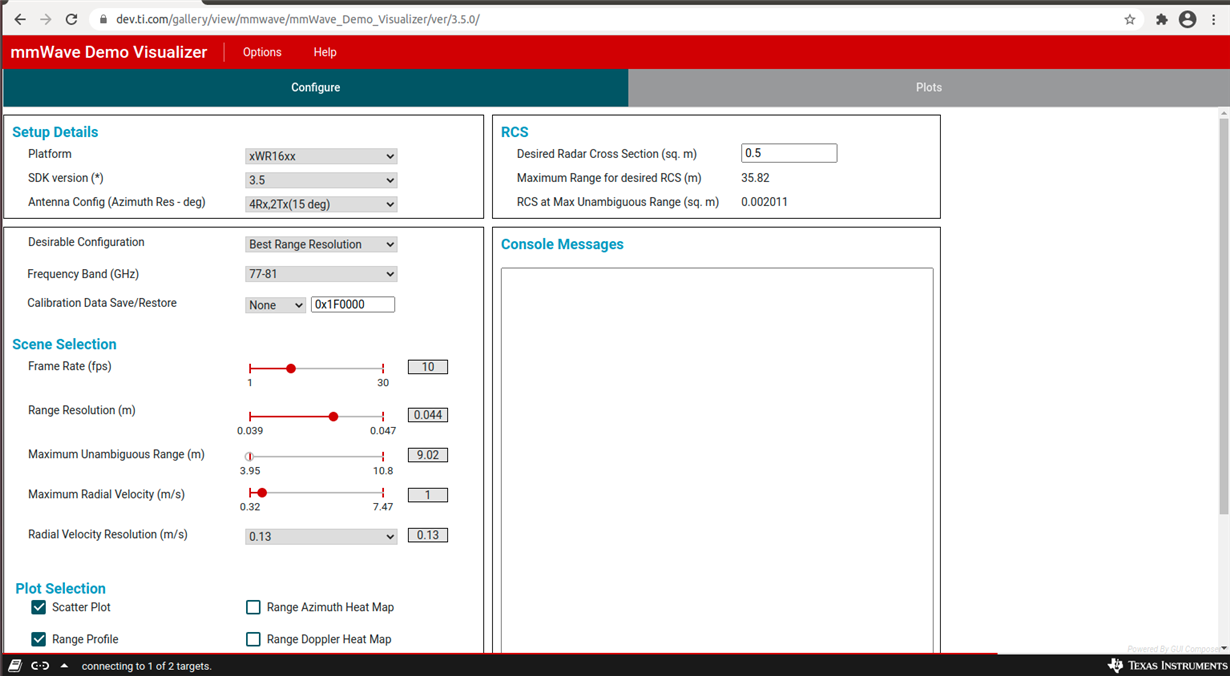

    On using "dmesg | grep tty"  command I got the serial port numbers as "/dev/tty/ACM0 "and "/dev/tty/ACM1" but not sure of which port is related to each of config and data.
    Though I chose alternative serial ports for cfg and data port and tried to connect, I got the "Connecting to 1 of 2 targets" message at the bottom of  mmwaveDemoVisualizer(refer image) and radar is not connecting.

    In Linux I'm not in which order COM ports are enumerated but you need to try both combination.
    Make sure that device is flashed with the mmw demo and set into functional mode. You can confirm the device functionality by connecting to COM port at 115200 baud rate using some serial terminal tool and press ENTER after connection, it should show 'mmwDemo:>' prompt on the screen. It will confirm that device is up with the application and that is right COM port for CLI-CFG COM port used in the visualizer.
    If above steps are done and got the right COM ports, then try to send configuration to the device (click button 'send config to mmwave device' in visualizer) even after it says 'connecting to 1 of 2 targets'. It should send config command and visible on console messages of this webpage.

    Found the COM ports and ran mmwave Demo Visualizer successfully.
    Demo visualizer shows the scatter plot of objects detected for about 10 meters and in configuration tab, Maximum Unambiguous Range (meters) also has max value of 10.8 only.
    Q1. Can I extend the range to 40m in the DemoVisualizer, if not how can I do the same?

  • Hello Guru,
    1) mmw demo is meant for demo purpose only so it has range limitation. However you can change the max range, refer setting from below snapshot-
