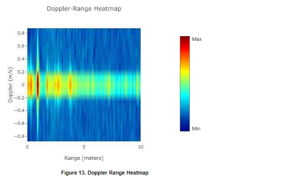

2. I would like to select below format of range-doppler heat map rather than default dot format. According to demo visualizer user guide 3.5 Range-Doppler Heatmap, it may be configured somehow but I am not sure how to set up. I am fine if you could advise to select preferred format.

  •  Hello
    Regarding 2nd question, let me attach a picture.

    2. If you want to select the Doppler-Range Heatmap then you will need to go the following file and look for the guiMonitor CLI command and modify your .cfg file accordingly.
    <MMWAVE SDK INSTALL PATH>\docs\mmwave_sdk_user_guide.pdf

    2. It seems preferred format appears with default setting. Thanks.

    2. If you manually load a .cfg file you would modify the command I referenced previously. If you want Doppler Heat Map then you check the box and that does the same modification to the .cfg that the visualizer sends just so you know.
