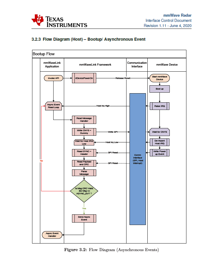

I have been using the mmwaveLink layer with the IWR6843 revision D radar, with a customary 60pin (the one described in the schematics of this radar board - 60 pin-HD for DCA1000EVM). The aim is to mimic the mmwave Studio, which according to documentation, follows a mmwaveLink layer below.
My problem is that when I send a reset - I active low the lane to the radar - I do not get any response from the Interrupt lane (as seen in the MMWave Radar Interface Control manual). I have atatched the communication protocol when booting up. Am I missing something? Do I need to have the firmware downloaded to receive an interrupt when it comes to the IWR6843?

  • Gorka,
          Yes, for this flow Firmware need to be loaded.  Trying to understand your problem, In IWR6843ISK board NRESET is applied by physically pressing a button.
    Could you please elaborate more on  "when I send a reset - I active low the lane to the radar". If you could explain your setup details would help us to understand the system. How you are sending reset command?

  • Gorka,
        Thanks for providing additional details, After ROM boot loader you have to load the MSS and BSS firmware image. Only after loading these images you would be able to send API commands.
    At high level mmWave studio and DCA1000 (FPGA based capture card)  EVM training video's you could see from the below link.
    https://training.ti.com/dca1000-training-video
    To get host interrupt, you need to have MSS application and IWR6843 corresponding BSS image should be loaded into device memory, after SPI connection, host should be able to issue mmWave link layer API commands.

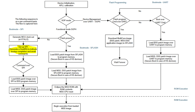

  • Hello Chethan,
    I am not sure what to follow then, since according to the Application Report SWRA627 – October 2018 IWR6843 Bootloader Flow, there is a possibility shown in the figure 4 expressing that it is possible that the flash is not present, and so directly an IRQ is sent from the radar. I have attached the diagram. Please, could you let me know what it is wrong or what it is the way to follow? I will try again loading the firmware and waiting for the interrupt as the other way we commented, and also shown in the commented diagram.
    I think, I might be missing some point somewhere in another document, or some important step. Thank you!

  • Hello Vaibhav,
    Point number one looks working for me, since I decided to try again loading the Flash, after creating again a metaimage with the firmware binary files from mmwave Studio.
    I was able to bring from idle and record with my HW setup and the IWR6843 plus mmwave Studio platform. Then, I moved to the implementation of mmwavelink layer within the example of the nonOs application. Now, I also see the response of the radar after the reset, meaning that I got an IRQ high, as I was expecting and thus I would say the essence of the question I posted is solved. I thought that without firmware the radar would be able to communicate with the external host, as the posted diagram from user guide IWR6843 Bootloader, but looks like something is not okay for that specific case.
    Anyway, I move from no firmware approach to a re-compiled flashed firmware approach, and it looks it worked. I have now several issues with the nonOS application, mostly with what specific function each of the rls_studio do when using nonOS environment. If you have a thourough user guide, better than the one explaining the porting within the DFP pack, I would like to get it, so I know which are the exact features of each functions under nonOS app, such as clientCtx.devCtrlCb.rlDeviceWaitIrqStatus = rlsDeviceWaitIrqStatus or any inside the powerOnMaster function in the nonOs mmw_example_nonOS.c app.

    Vaibhav
    So I was firstly expecting IRQ high before firmware download, but since I could not see anything, I decided to take the second path in the bootup diagram, and load the metaimage directly. Then, I saw the IRQ high when setting Reset active low. My main question was, why without firmware I was not able to see the this event happening. I think the protocol for bootup, for either firmware/non firmware cases, should be the same, according to the mmwavelink diagram also attached above, since I assumed there was some kind of preloaded image in the radar, even when there is no firmware downloaded (either from debug mode, or flash mode).
    BR, Gorka
  • Hello
    Out of the two scenarios I was asking, the 1st IRQ was for case where flash is not found. So that won't be applicable in your case.
    For 2nd case the interaction would be  after image is loaded from flash after bootup and expected IRQ is  part of the Host and mmWave device handshake. Would you say this 2nd case would apply to you.
